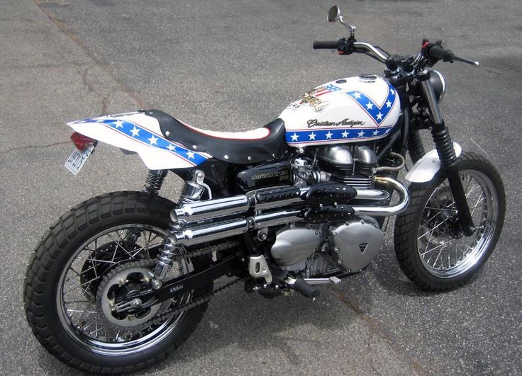

    The other option I'm considering is a setup like this...
    This setup uses the stock header and straight pipes, but trimming a bit from their ends and replacing the OEM chrome uber sausages with these smaller units. I'm guessing it's pretty loud with these mini-mufflers, but was thinking if I added a dB killer to each pipe in addition to the mufflers shown it might actually be reasonable. I don't care for the heat shielding they used on this particular bike and I would go a different route there, but otherwise I think this is very sharp setup.
    Any and all opinions welcomed, especially for those that have seen or heard these systems up close. Thanks...

    The last one is the coolest :)

    Darkman - I like the last one too and the good thing about it is that it can be done for less than $100. I'm thinking I may go that route for starters and see how I like it. If not, not too much lost down the motorcycle money rabbit hole.

    If it's any help most systems come with removable baffles, these are the best to go for as you can tune the removable baffle by drilling holes and or cutting them down, i have just finished drilling and cutting a baffle on my bike as it was to quiet with and to loud without :)

    Thanks for the offer sprocket, very kind and generous of you. I live in the states though, so the shipping would probably be a bit prohibitive. I do appreciate the offer though. I'm thinking I may try to do the Evel Knievel pipe system shown up there first and see how I like it. Looks pretty good to my eye and hopefully can be tuned with the help of variably drilled baffles as you wisely proposed.
