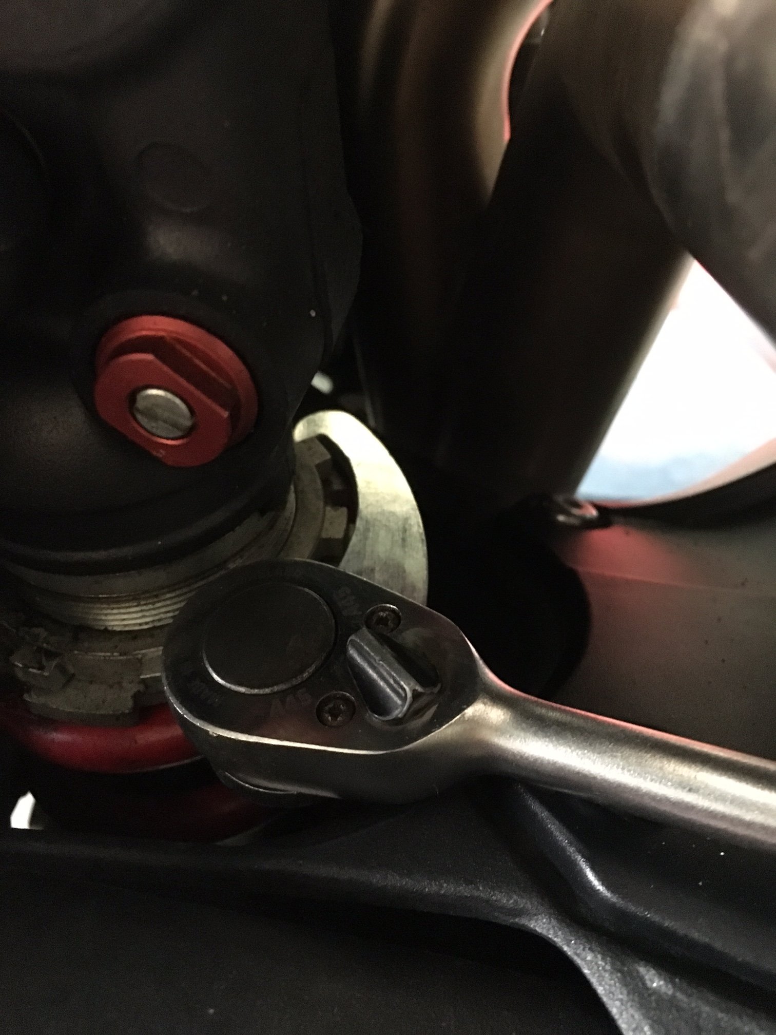

    Rear preload adjusting using Progressive Suspension 3/8 drive pin spanner. It is better used at 99deg to the ratchet, as it allows better purchase in the slots.

    Finally ordered the Progressive spanner that Victor recommended and it arrived today. I added 1.5 turns of pre-load to the rear shock and went fro 44mm of sag to 33mm. The front stayed the same at 33mm (wasn't sure if effectively shifting the CG forward would noticeably impact front sag). Part of this may be in my head, but the difference in handling and feel seems quite a lot more noticeable than I expected.
    Should have done this sooner!
    Now it's time to mess about with compression/rebound damping and tire pressures.
