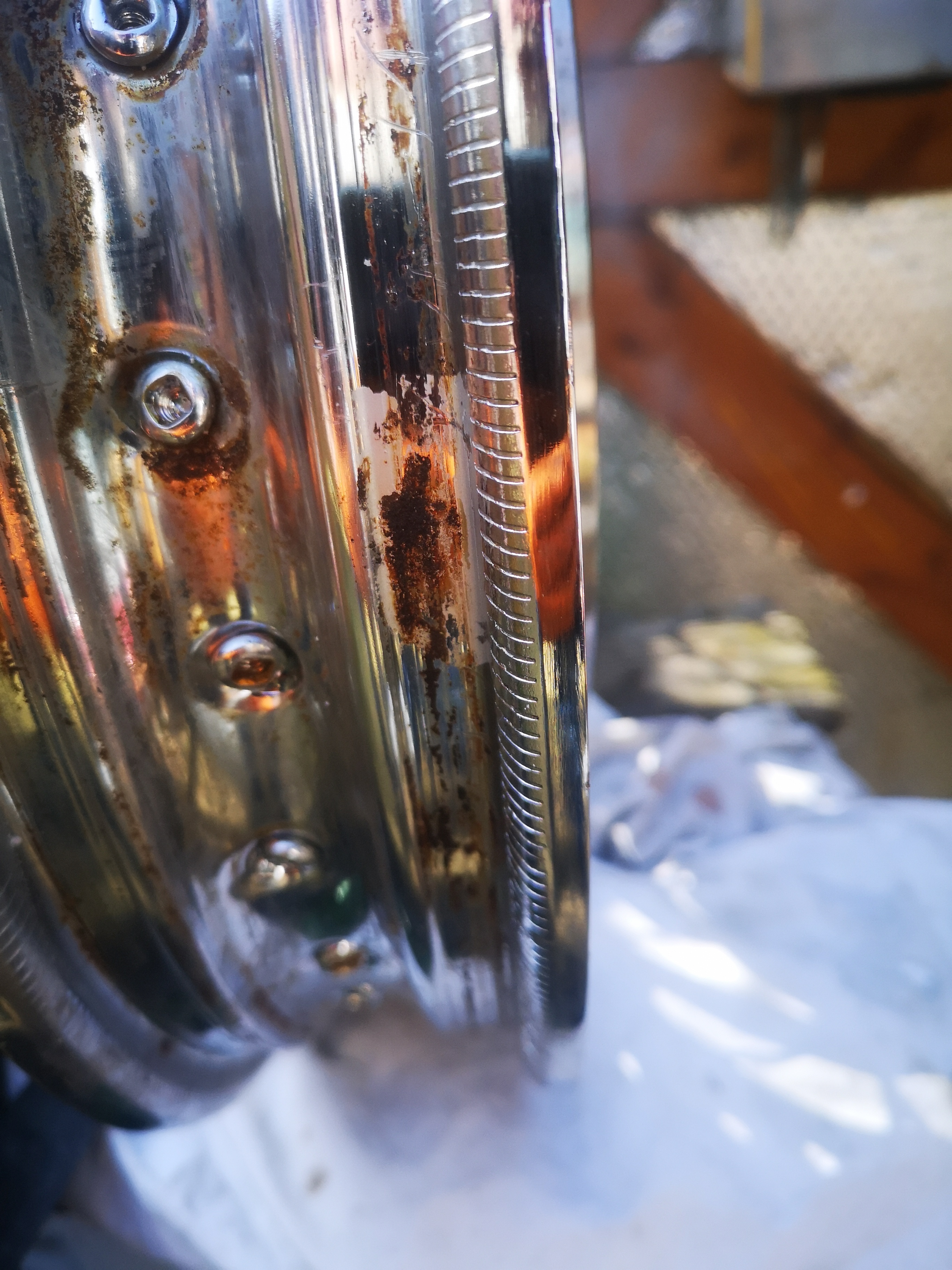

    T120 1 year old with 2300 miles.
    Decided to tackle the tyre change.
    Once I removed the front, I noticed that rust is already forming inside the rim.
    Cleaned off rust and treated with rust converter, hope that staves off the problem.
    • WTF WTF x 1
  14. Tiglet
    To me that’s bad for a 1 year old bike.
    Triumph would probably say it’s down to a poor cleaning regime by the owner :confused:

    I've now treated the rim but its only done 2300 miles, I only changed the tyres as I found the Phantoms were shite.

    I’d send those pictures to your dealer and Triumph but I wouldn’t be hopeful of a sympathetic ear.

    I did that this morning, but I'm friends with the director so he will be honest with me with his answer.

    Just got a reply, he has placed the warranty query to the warranty team but may take a while considering the climate.
