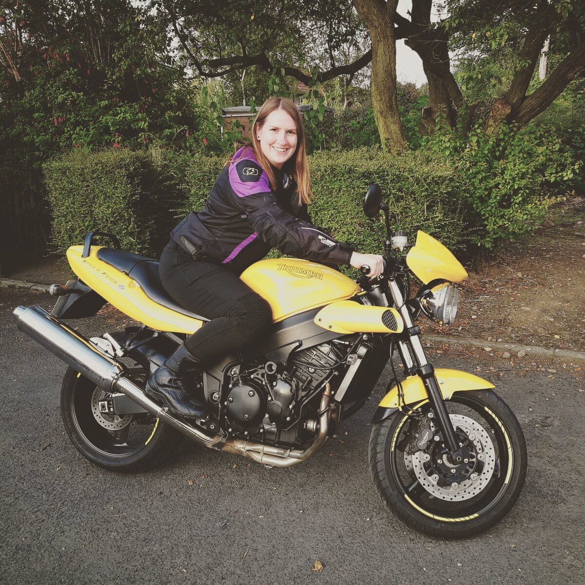

    Hi guys,
    Just bought my first big bike, a triumph speed four. There's a little rust inside the petrol cap around the rim. Nothing crazy, but what's the quickest, a cheapest and easiest way to remove it, or at least stop it falling into the tank?
    Don't have a pic of the rust atm as I'm working!
    Cheers in advance!

    Nice looking bike there, congrats :grinning:
