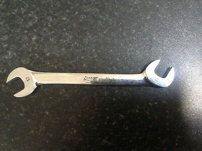

    If you have time to read all this on the bog you are either work shy or constipated........however, I digress.
    You do NOT need to remove the silencers if you buy a couple of cranked open end spanners to access the adjuster screw and lock nut.
    • Thanks Thanks x 2

    Put a chain oiler on, and unless you are brutally heavy handed you won't have an issue. Those spanners are a doddle.
