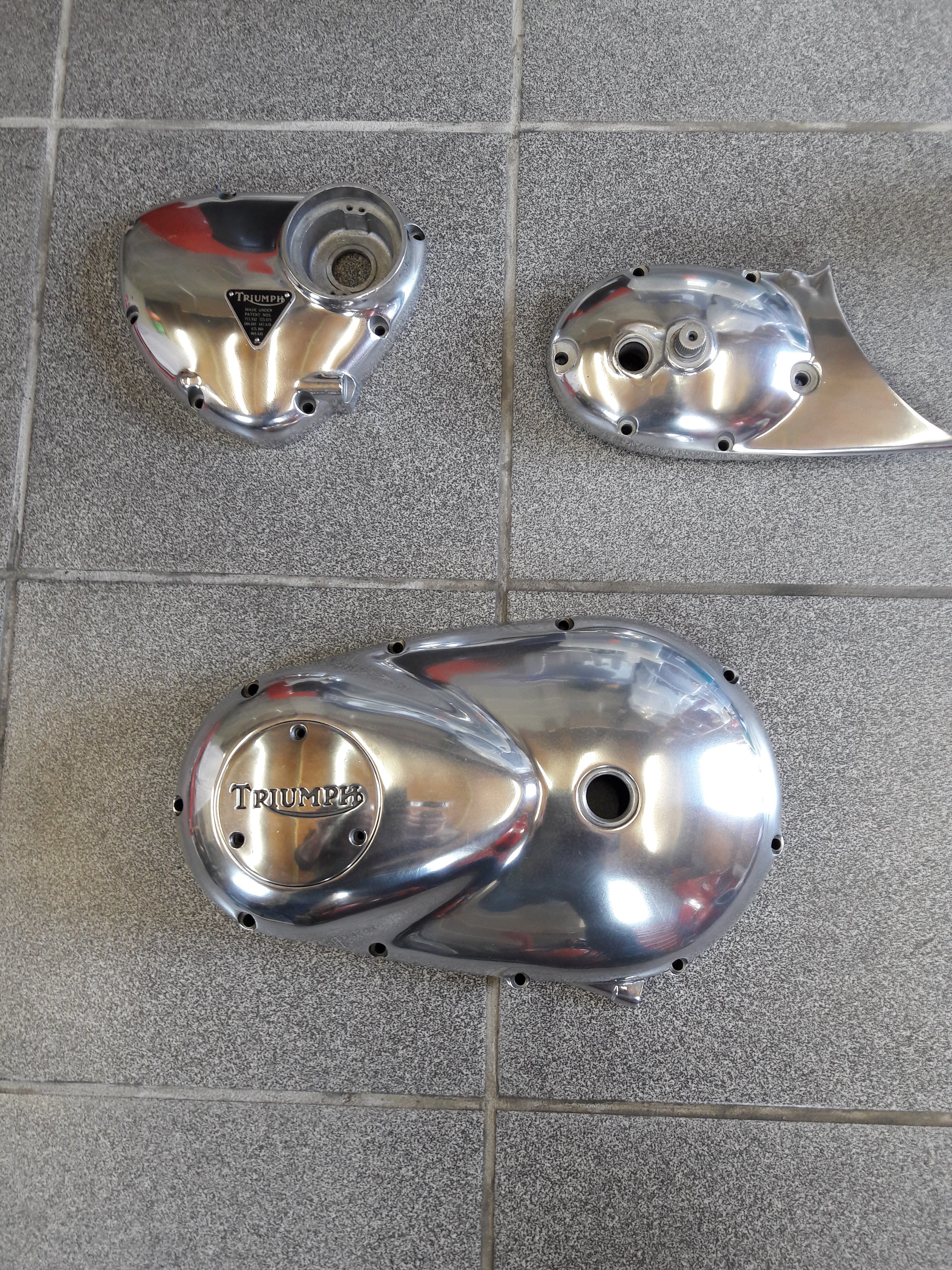

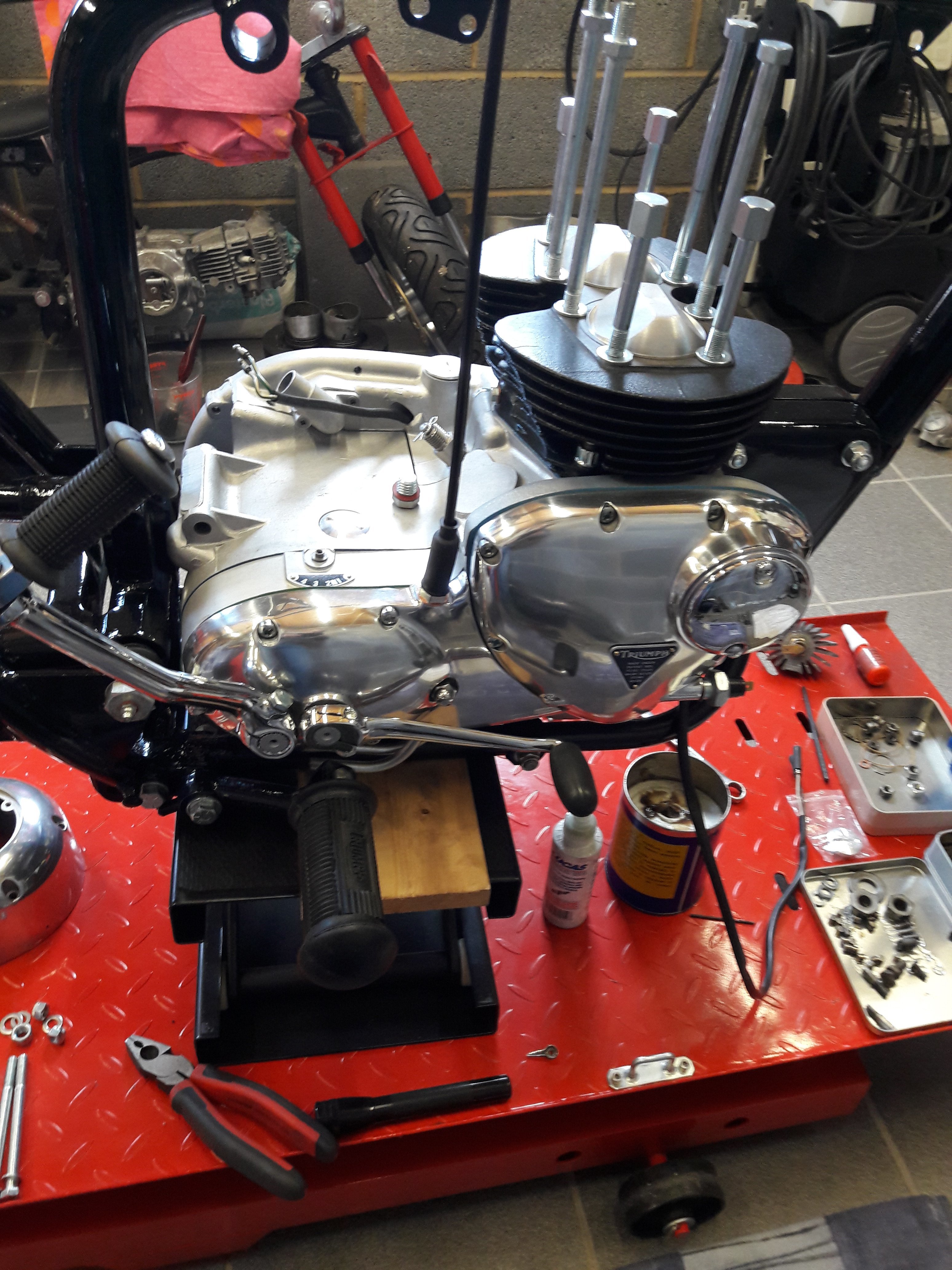

    Busy week cleaning/blasting the last bits for more paint and polishing, nearly messed up when my one useful hand let go of the cyl head but luckily i caught it with my bad one and made me broken finger throb for a bit :joy: managed to polish some bits as well. Hopefully this week i can finish the engine build.

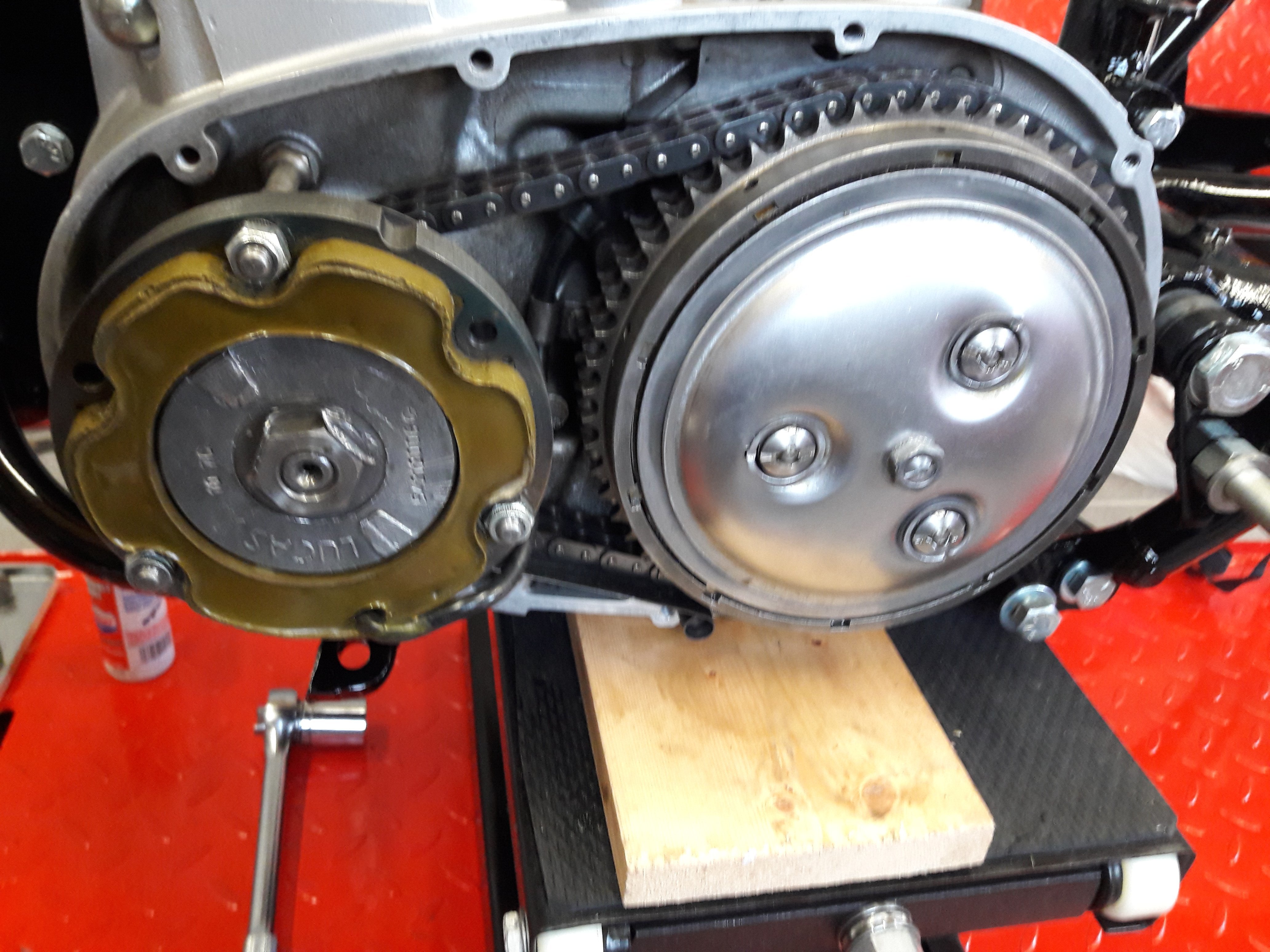

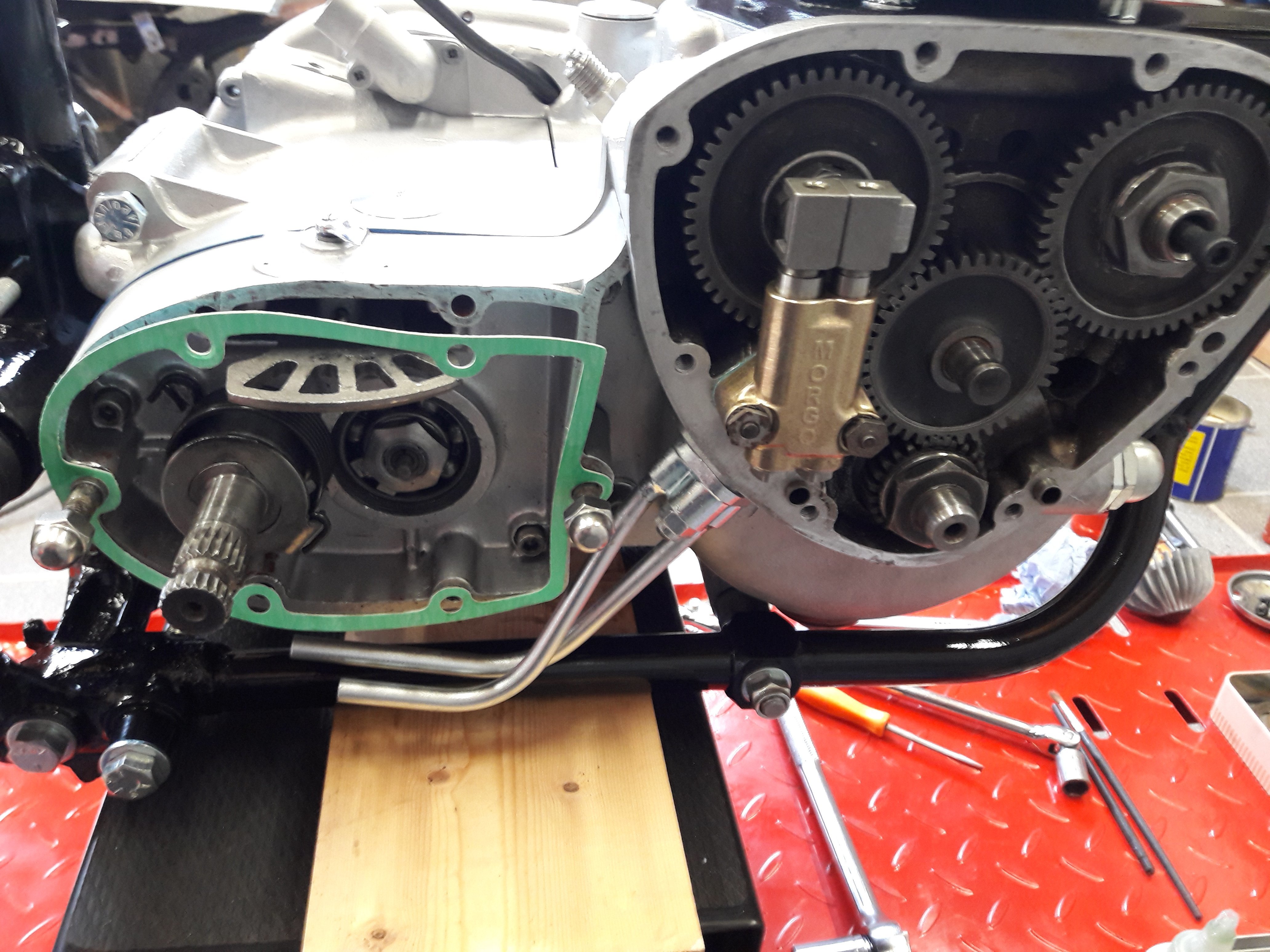

    Cyl head is coming along and should be done soon, gearbox is back together and fitted a new oil pump just to be safe. Built up primary side as well with new pressure plate and steel discs, fitted a new drive chain as well as old was unknown.
    #24

    Morgo oil pump ..... good call!:cool:

    If i ever take off the timing cover for what ever i always stick a new pump in :)

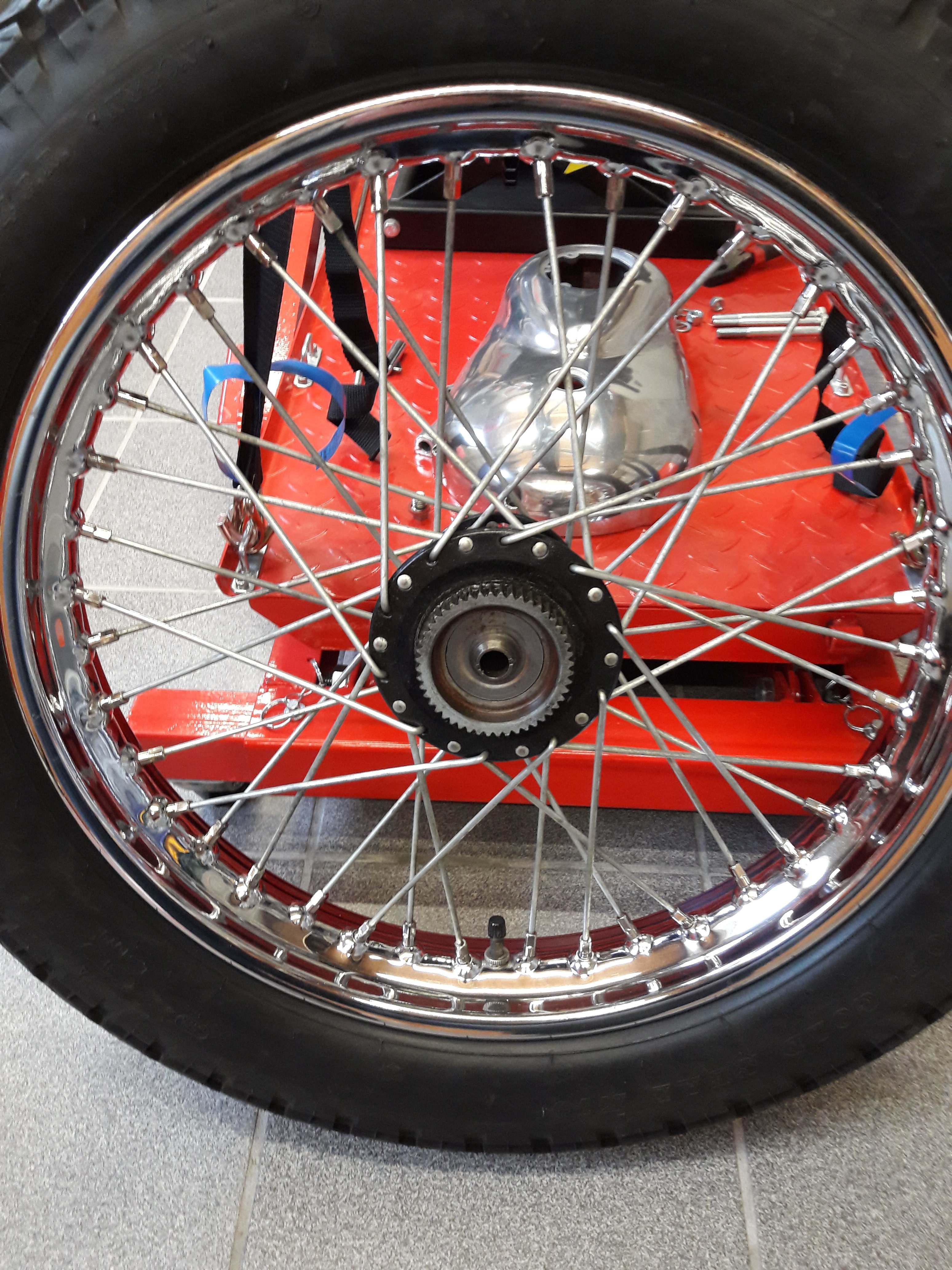

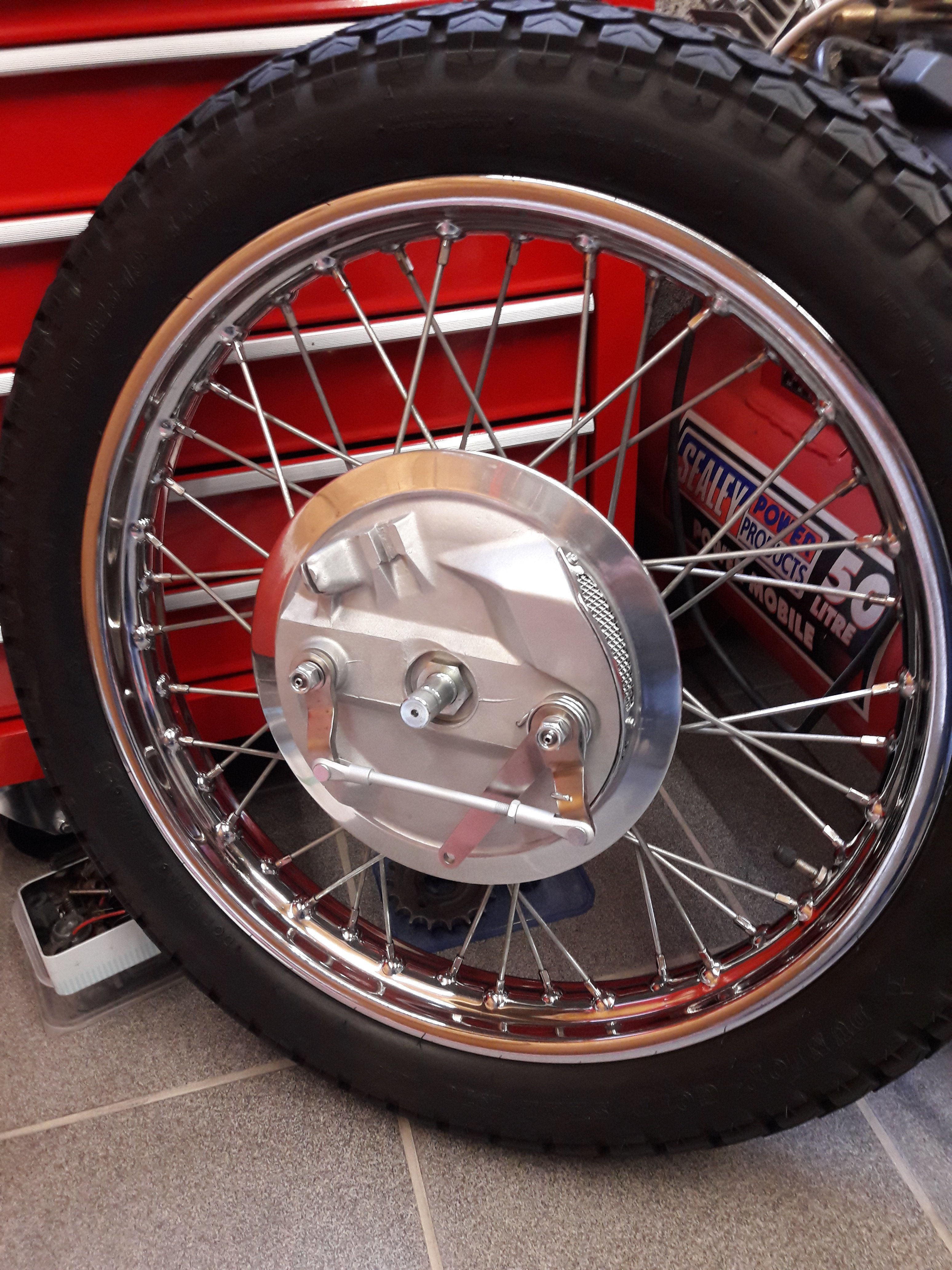

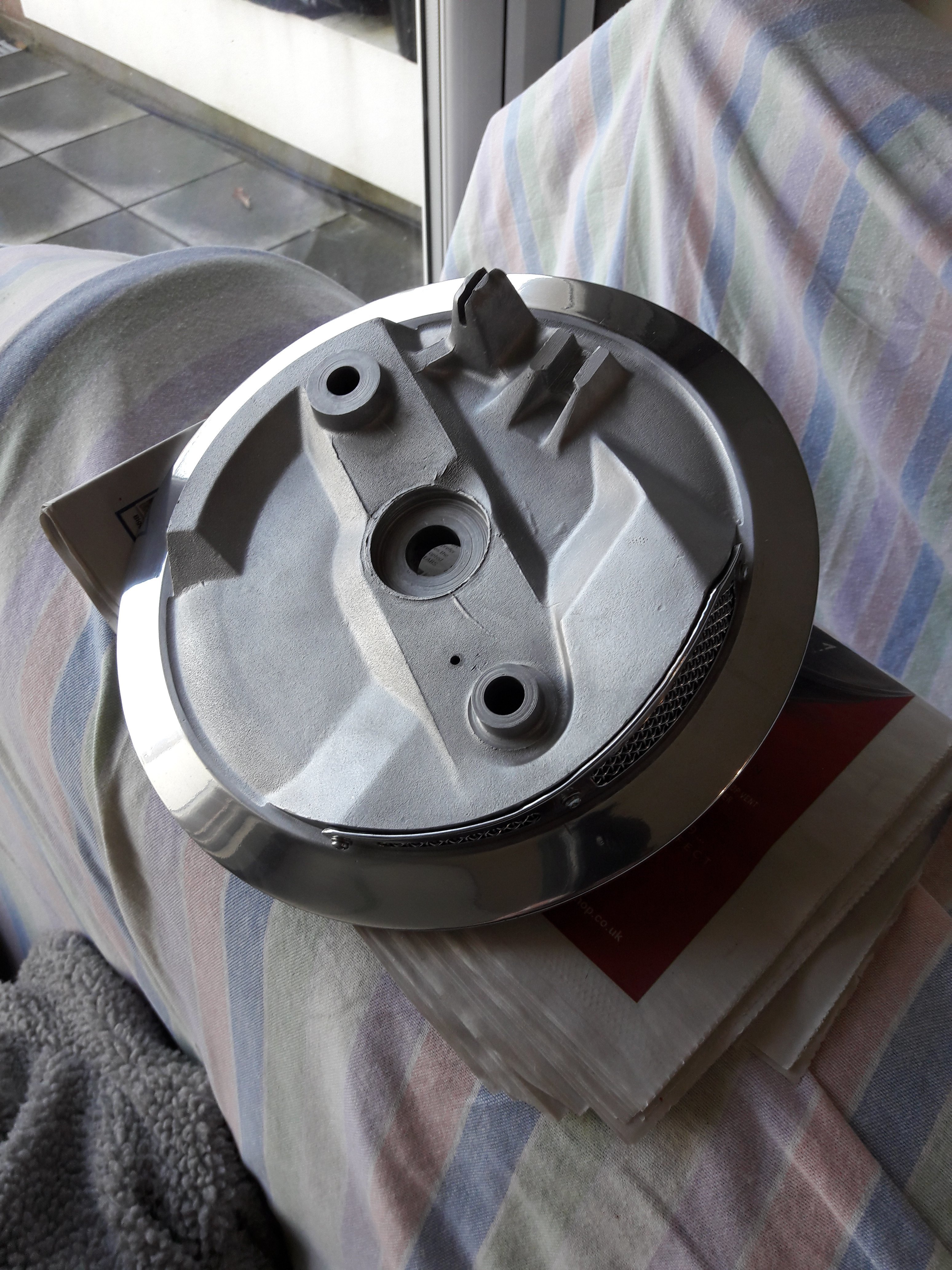

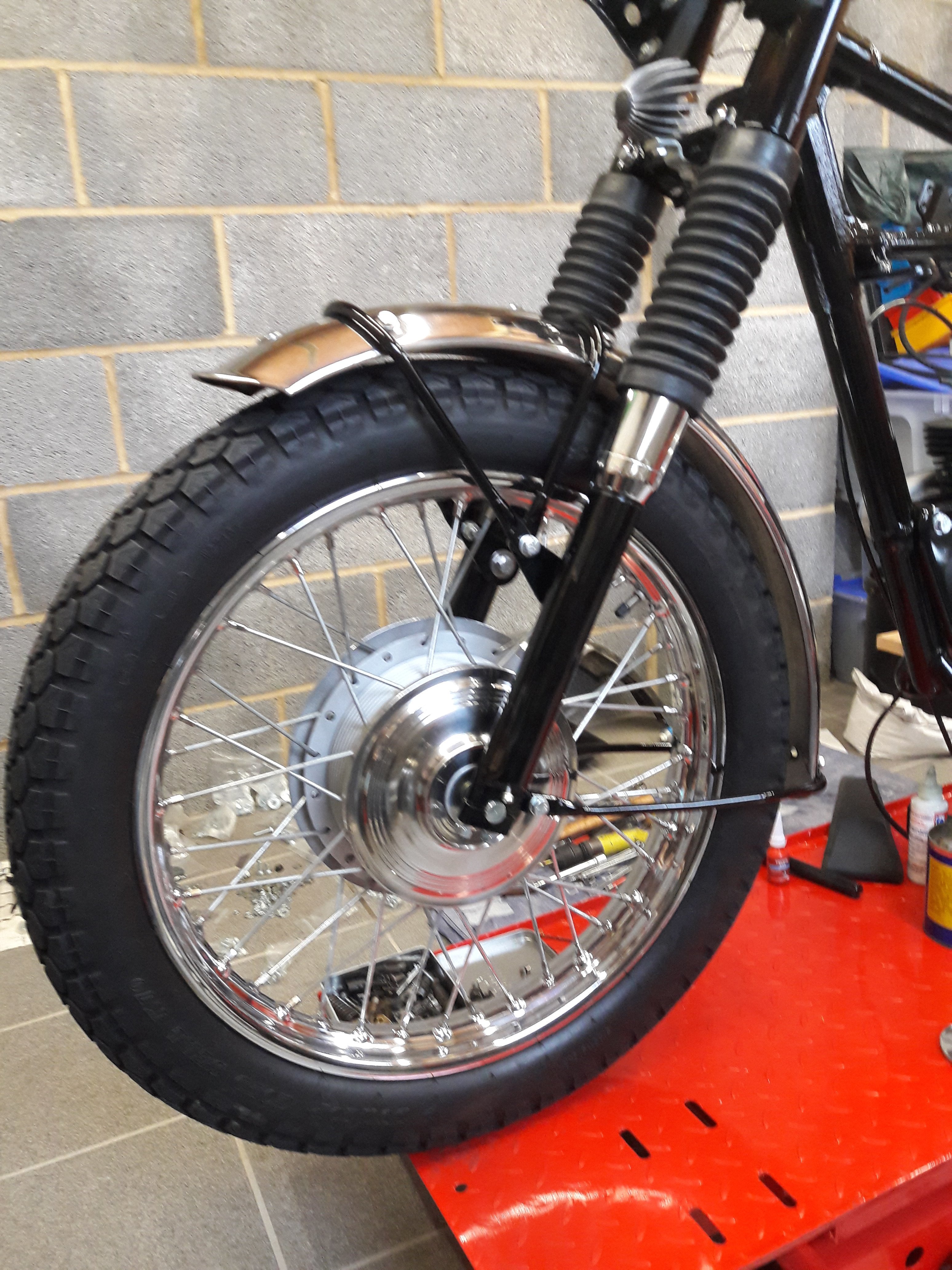

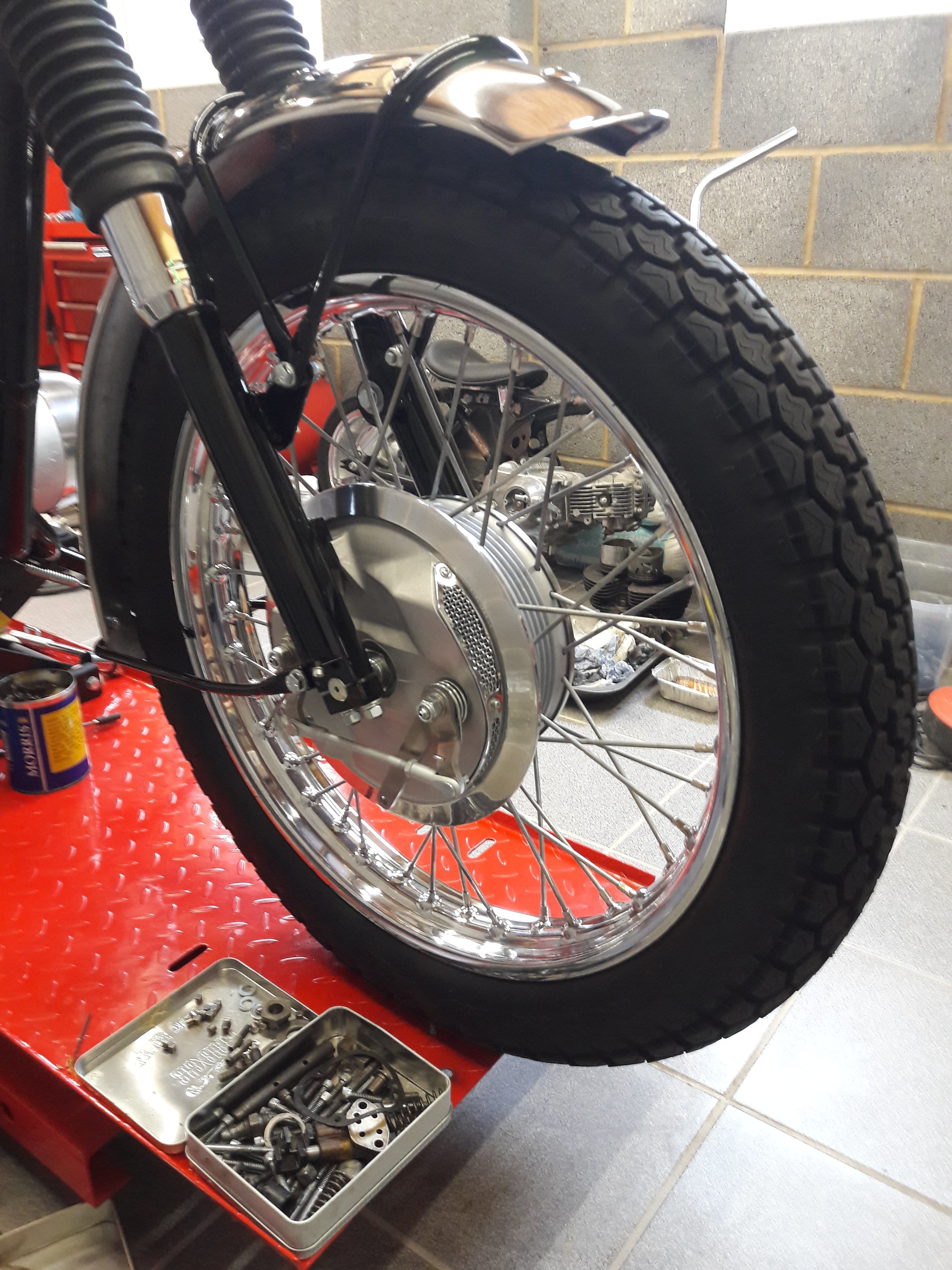

    More cleaning and prepping for more paintwork for the last few days, also managed to get the front n rear wheels sorted with new brake shoes and wheel bearings, also new bearing in the rear chain wheel/brake drum as the rear axle has 3 bearings with a QD wheel. Fitted timing and gearbox covers along with clutch cable gear lever and kick start.

    Fantastic restoration workmanship;)

    Those pistons look SERIOUS!!:cool: I bet it's gonna be a bastid to kick overo_O. I know it's a different beastie, but as I remember them the pistons on my 5TA (I said it was different!) were somewhat flatter with just a delicate hint of convex shaping on them:(. And that bugger knew how to kick back when it was in a bad mood!!:eek::scream::mad:

    I think the early bikes had a shorter kick start lever, in the last few years i have also given up on the old but reliable points and condensers as the new electronic ignitions you can buy now make starting far better.

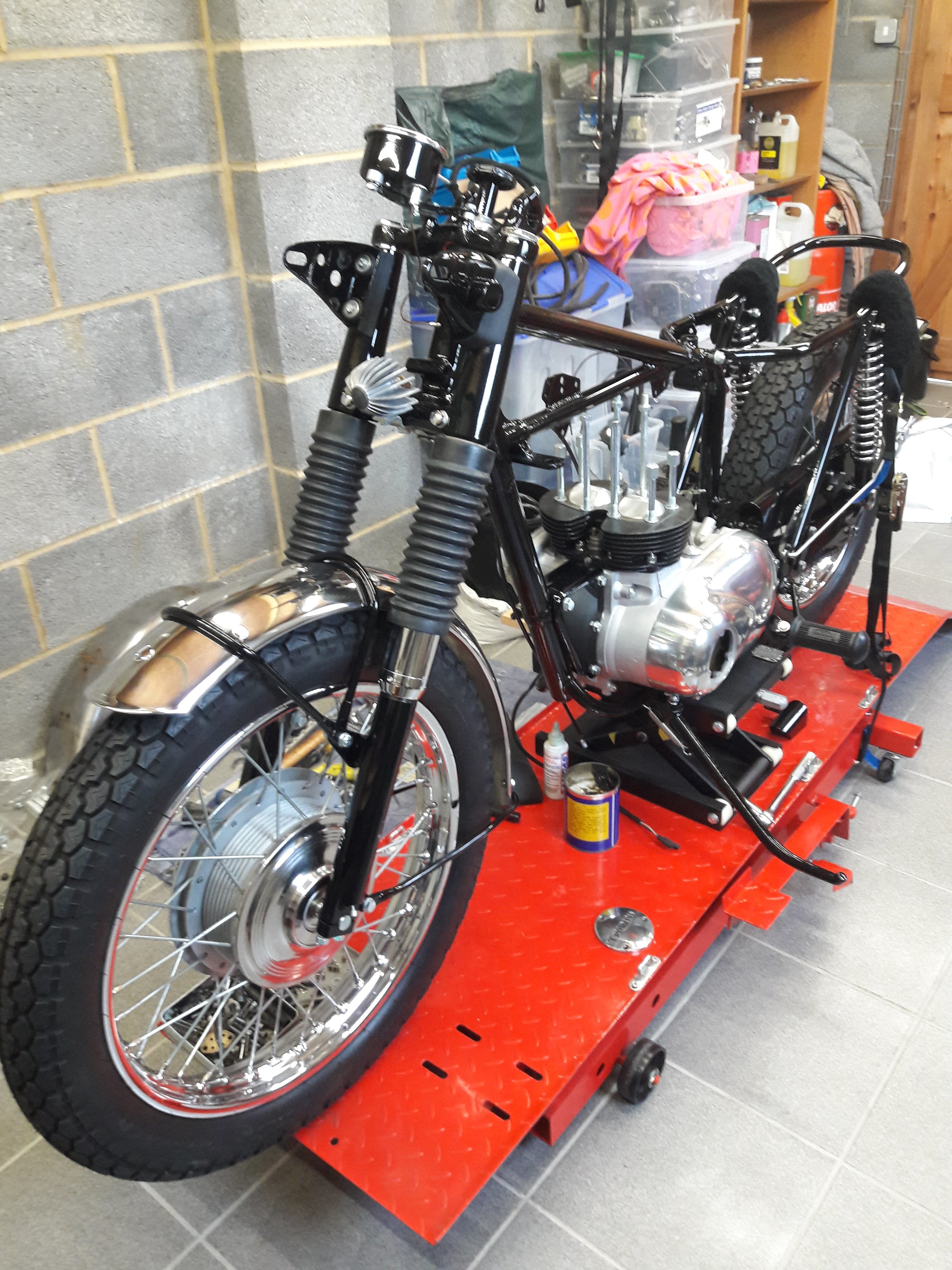

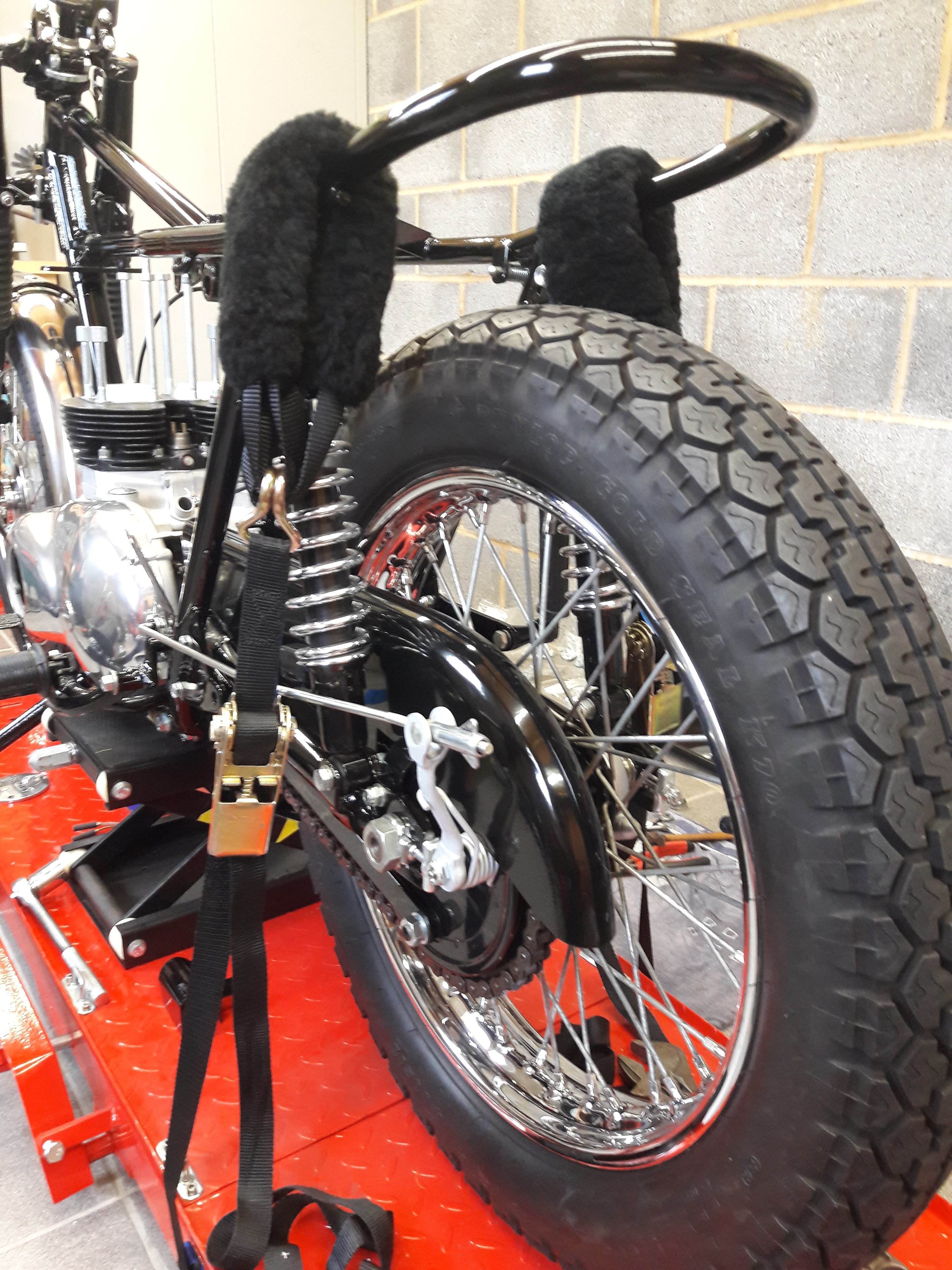

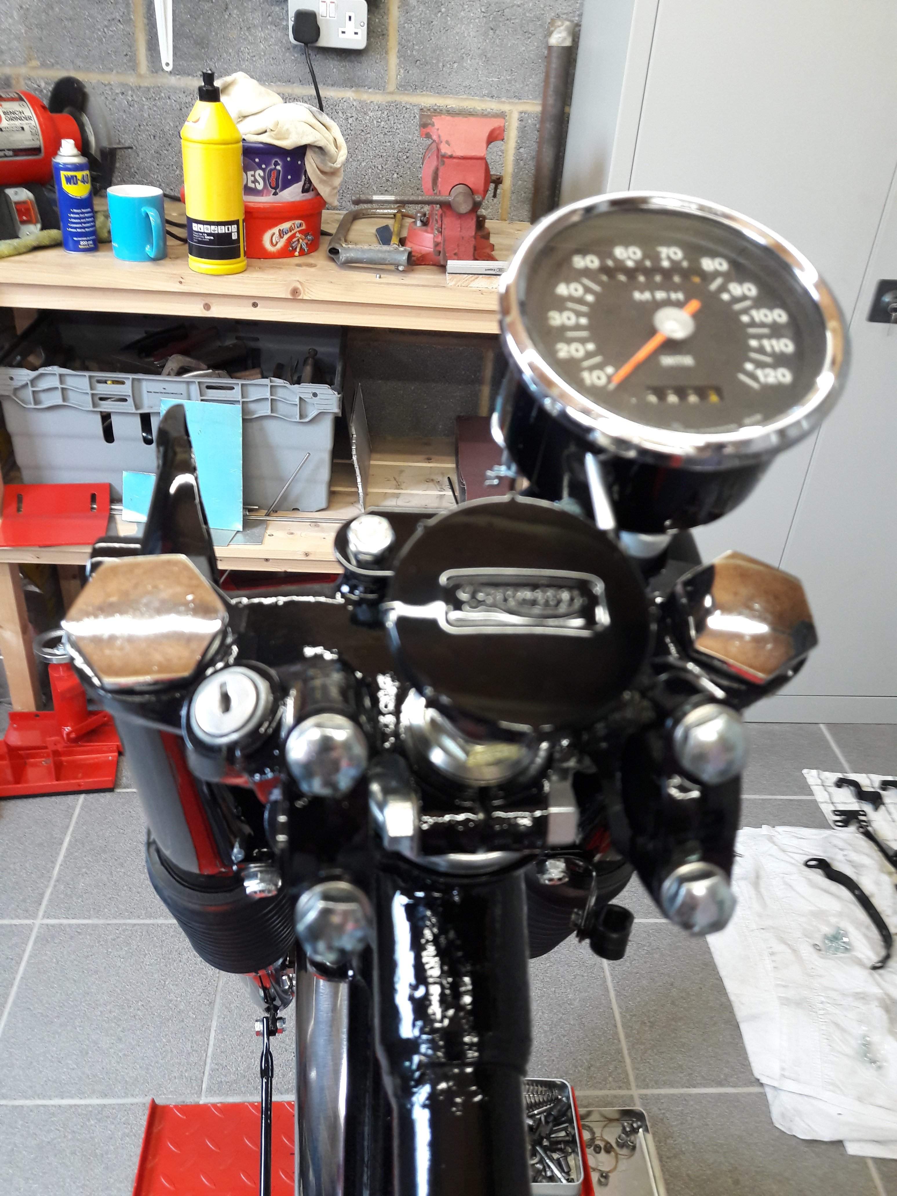

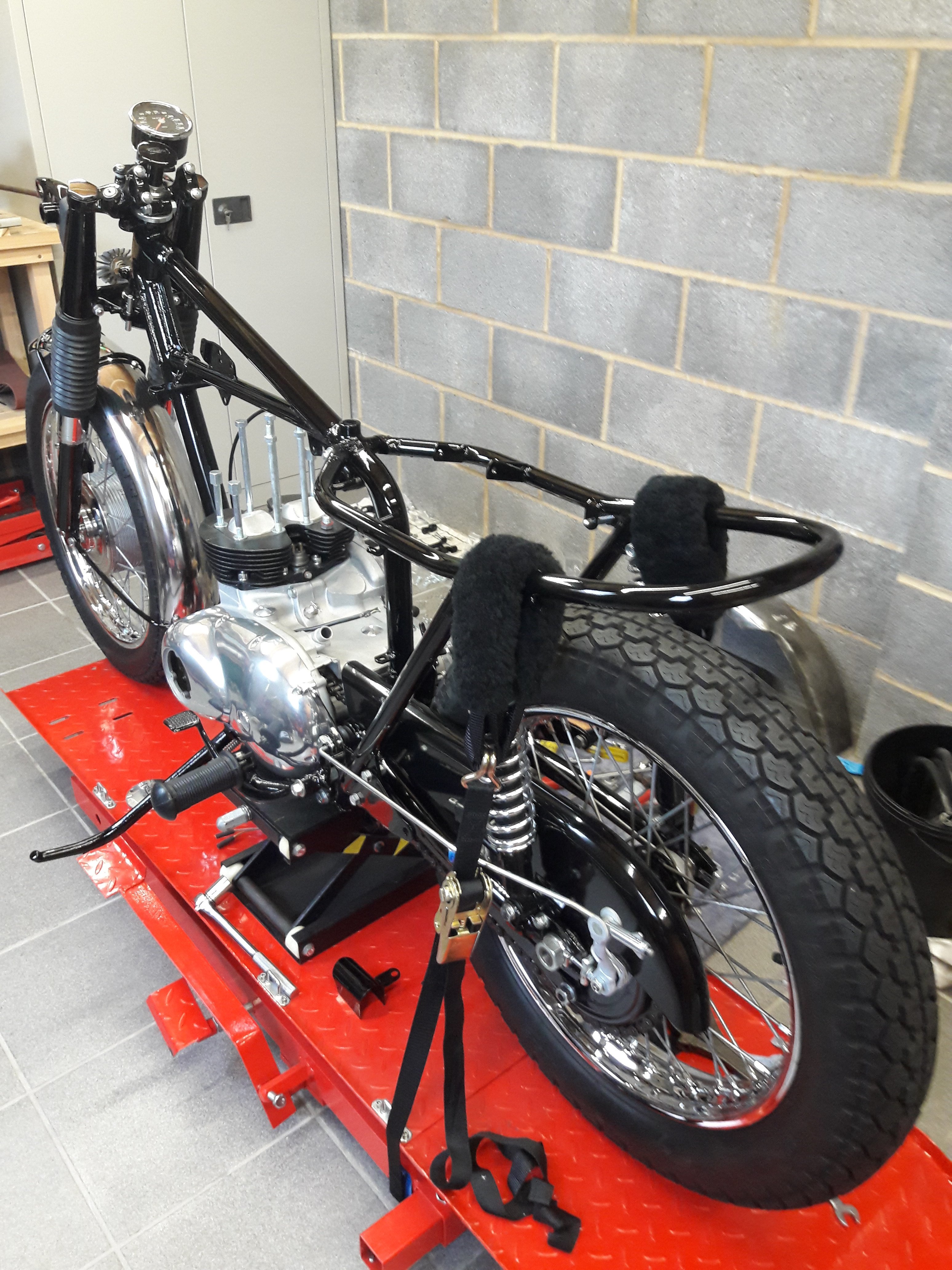

    Taking it easy this week bolting all the rebuilt and painted parts back on.

    Tell you what darkman not very often that I’m speechless but :no_mouth:
