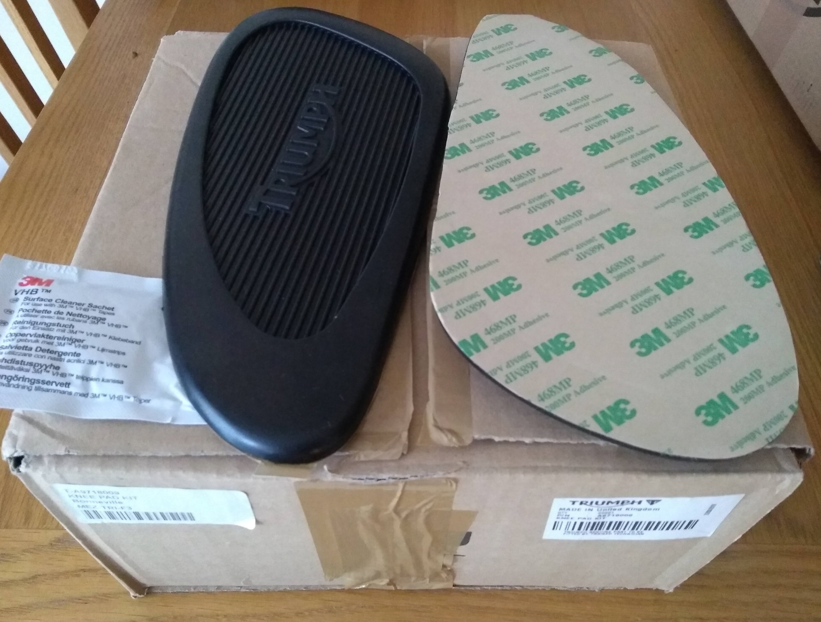

    Sorry to bother y'all again but I'm back to pick your brains. I have new bodywork for one of my 2001 Bonnie's. She's going from Green/Silver to the 2002 Sky Blue and silver colour scheme. Anyway the new bodywork is just that, Brand new, taken off a new bike that converted to the Jubilee scheme in 2002 either by Triumph themselves or the dealer. Anyway the new tank doesn't have kneepads fitted so I will either have to take the one's off the current tank or get some new ones so, if removal is an option I need to know how to do it cleanly without damaging the paintwork of the tank they are on. All help gratefully received.

    Looks like I am sorted for Knee Pads thanks to MadMrB but I would still like to know for future reference if there is an easy way to remove knee pads without harming paintwork or damaging the pads as I have an idea that I might re-finish the current bodywork for use as spares in the future and it would make it easier if I can remove the pads before doing touch up/repaint work.

    I've removed self-adhesive parts with fishing line and a hair dryer. Just run the fishing line under the part to be removed and if it doesn't seem to want to release just heat it up a bit.

    Like JtC said. Gentle heat and some mono is your friend. I've debadged cars before, and as long as you use gentle heat, you won't mar the paint. If you have any glue left on the surface, rubbing alcohol can usually remove that.

    I've swapped my Bonnie's knee pads in the past as well. I took the tank off, and just used a hair dryer. Better if you can get the dryer to the tank (I couldn't), but otherwise work with an almost empty tank (less risk with petrol, and it is way lighter that way).
