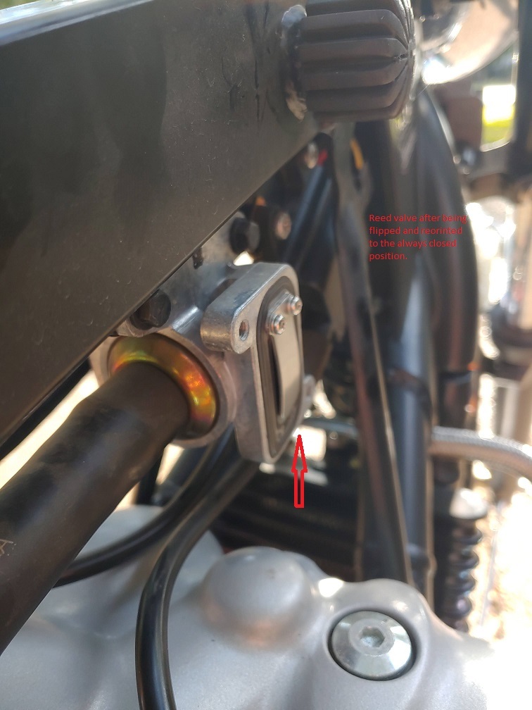

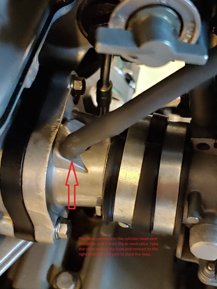

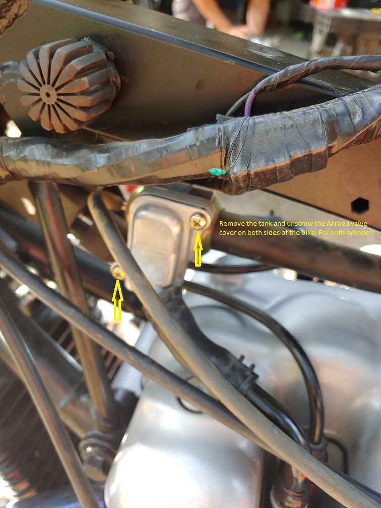

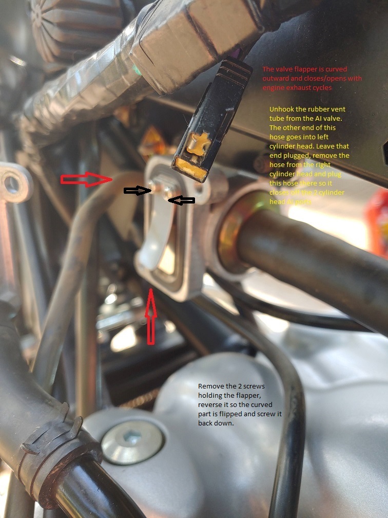

    Instead of removing all the plumbing and recapping the cylinder ports next to the spark plugs (which I saw several reports of the plugs coming out/getting loose/causing unfiltered air to be sucked into the cylinders..etc..) I went down a different route of not removing the plumbing but just flipping the reed valves to remain closed all the time.
    Once I opened up the 2 reed values on either side, these are usually always closed and prevent the exhaust gases from going up the tubes/causing blue-ing of the pipes. So to prevent them from ever opening and to avoid removing all the plumbing, I flipped the valve so it's always closed, no matter what the engine/exhaust cycle is.
    I also removed the vent pipe coming from the valve into the cylinder head and used the same pipe to cap off both the vent pipes on both cylinders.
    I felt the bike ran a lot smoother and of course, no more pops during decel or when throttle is eased.
    Some pics of what I did ..just re-oriented the reed valve flaps so they r always closed. This allows, imho, to keep the rest of the plumbing as is, stock and if u need AI, flip the valves back again and connect the hose back to the valve and cylinder heads.
    I have noticed much smoother idling, acceleration, zero POP's during deceleration after I have done this and rode around 50 miles with this. I think this is working but if any experts or long term bonnie tweakers have any comments/advice, pls do let me know..
