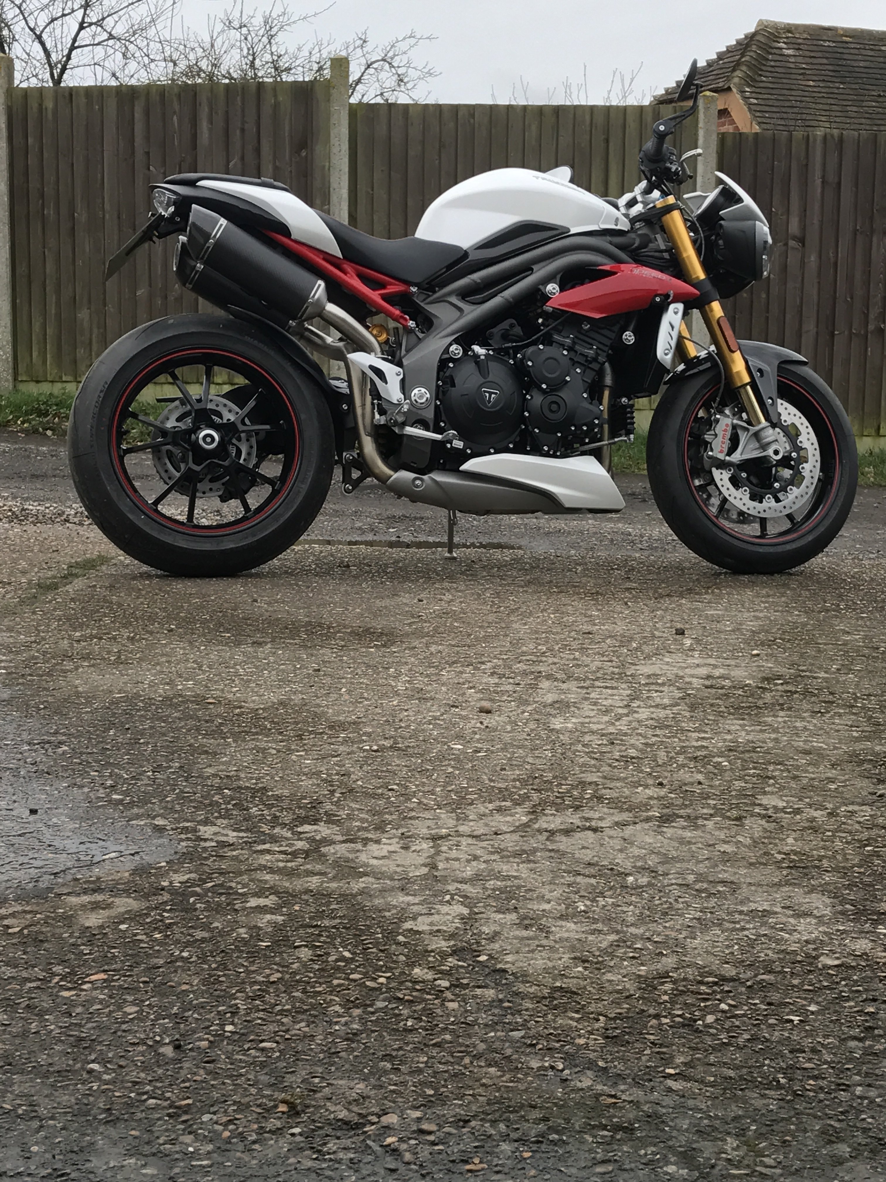

    Hi Mick, just picked up my new Speed yesterday. Dealer fitted SC ovals to mine for me and said it will be fine on the standard map. They sound awesome by the way :) IMG_0245.JPG
    #9
  11. darkman
    5,157
    7,658
    Great looking bike :)
