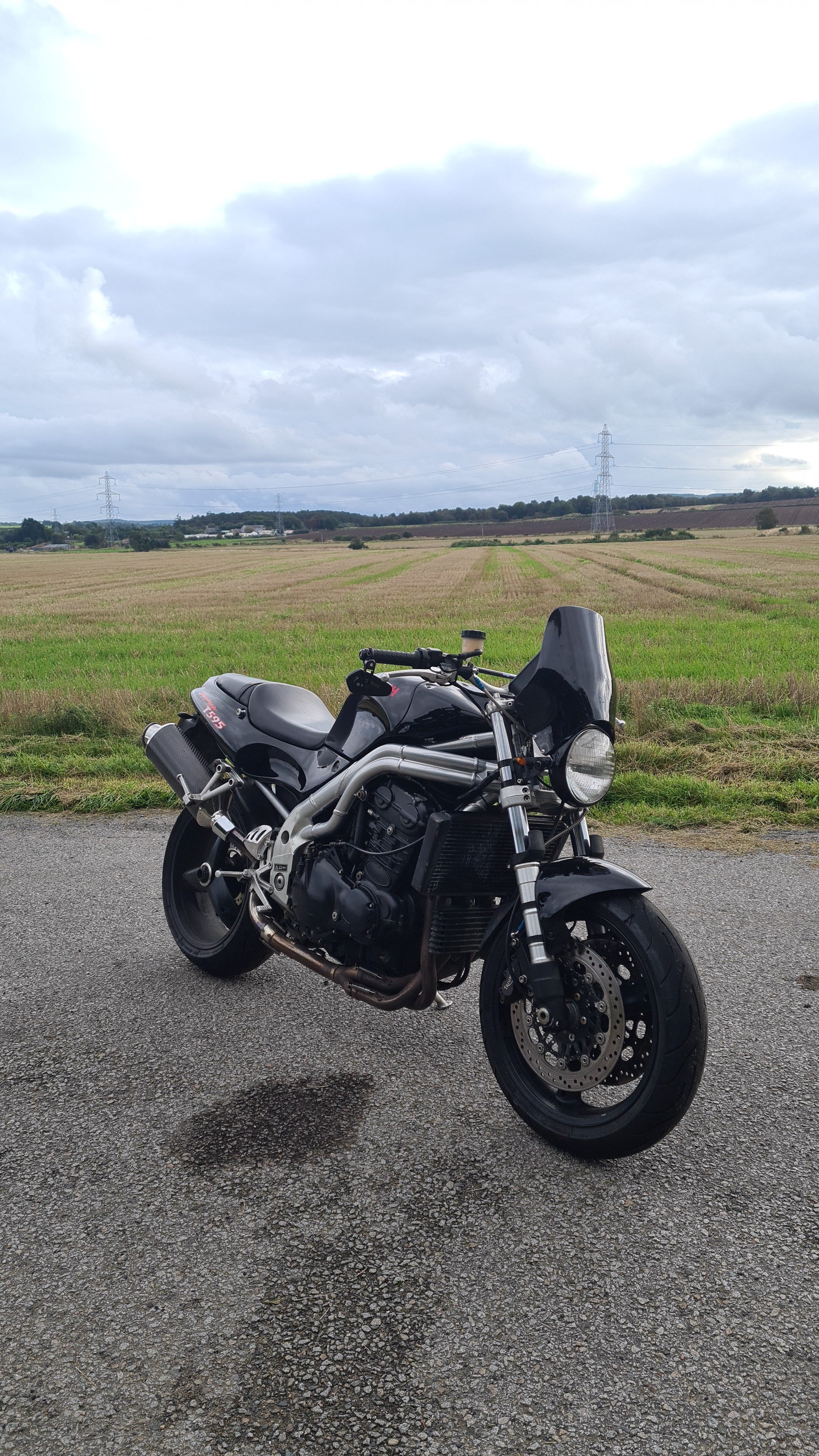

    I am looking forward to read about your progress in your project. I hope you will document it with photos too.

    What you thinking with the build, custom or cleaned up stock with mods etc. Looks like a dam nice bike already tho :cool:

    Impressive work! Are you still thinking about en engine swap or do you plan to save that one?
