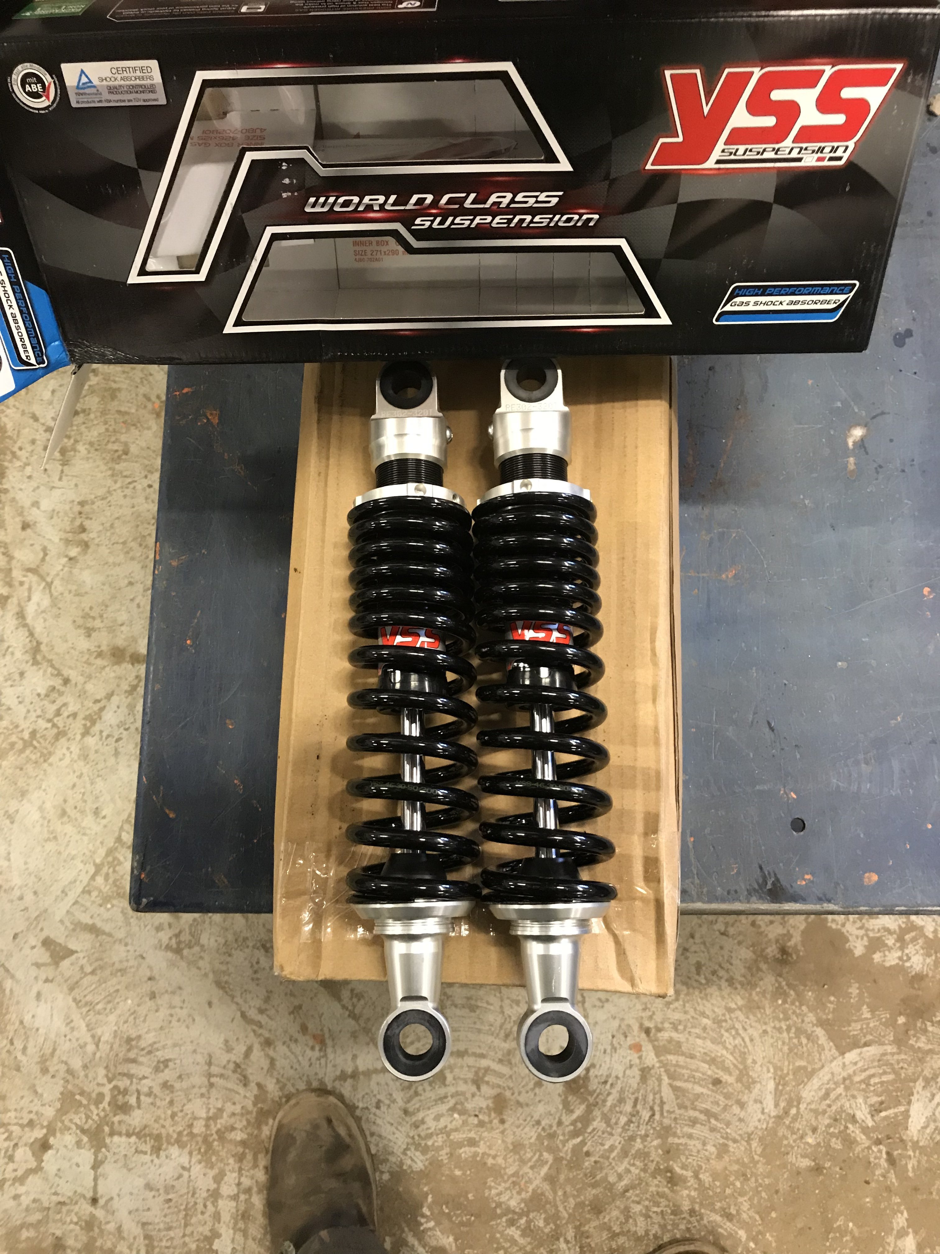

    Had an Email and a text today saying that my new shocks should be with me before 11am tomorrow :)
  3. dilligaf
    These just arrived at work :)
    They look/feel like like a quality product :)
    BLACK :cool: springs
    They are a lot lighter than the Triumph ones :eek:
    Will fit them tonight and hopefully get out for a ride this weekend depending on the weather :confused:
    If not maybe the Scottish bike show next weekend :) 28478A81-9A30-401B-8DC8-41EE371E1C82.jpeg
  4. crispey
    7,323
    but theyve chrome and red on them!! Someones hacked Dilli's account. Or have the aliens moved out of his head??

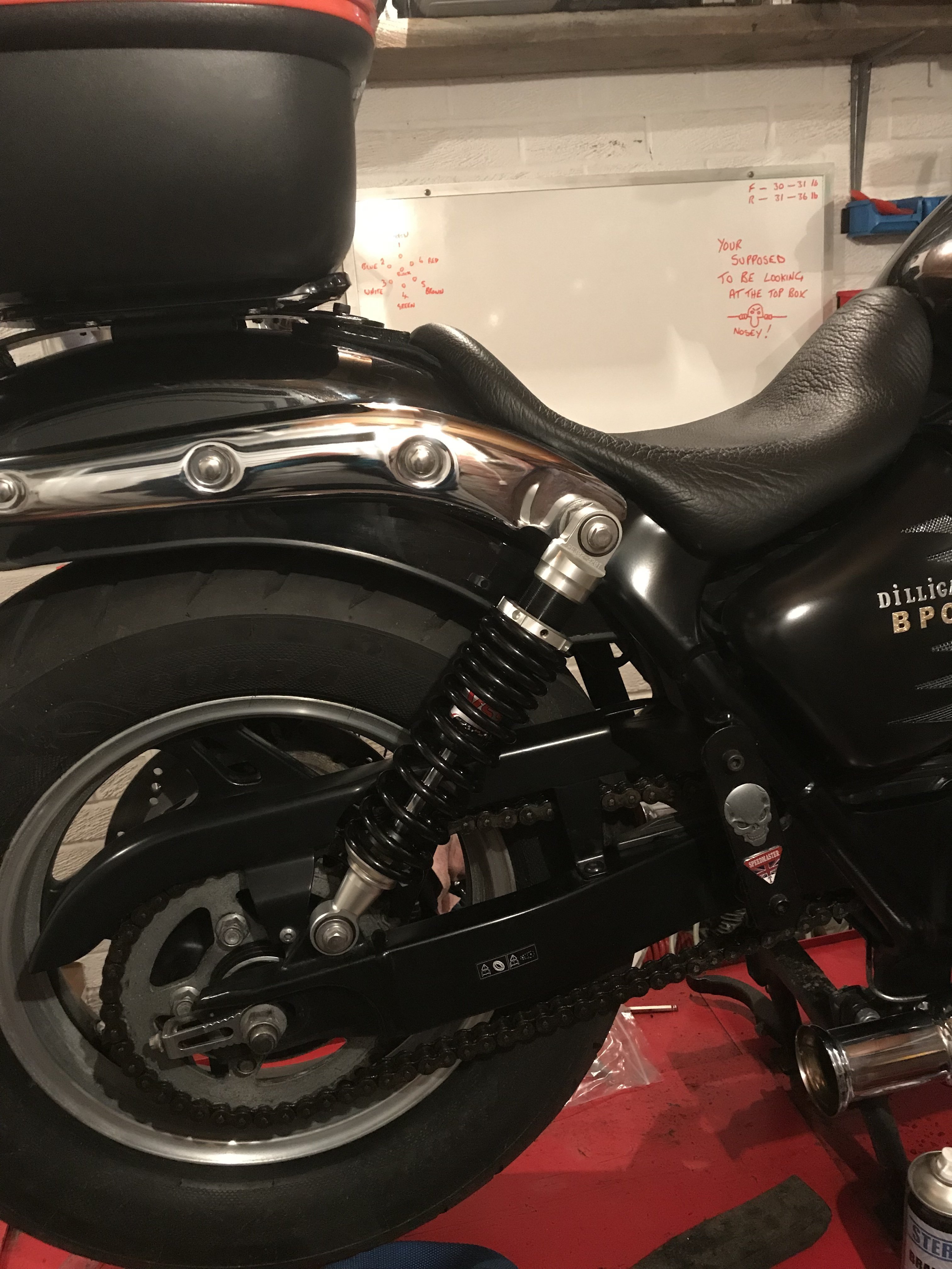

  5. dilligaf
    That was easy :grinning:
    Now it’s gonna be trial and error to set the pre-load :confused:
    Unlike the triumph ones which are the stepped/twist type these shocks have a fine thread and ring for the adjustment and are then locked in place with a grub screw :)
    I’ve set them soft to start with and will see what it’s like on the road and adjust as needed :p A67222BE-ADEE-431B-8B9C-D46E171A6DF6.jpeg

  9. dilligaf
    Dunno mate :confused:
    Nothing in destruction’s to indicate the turns to weight ratio :confused:
    The shocks arrived with the lock rings loose and the springs loose
    I tightened them enough to nip the springs but there’s loads of adjustment left on the threaded shaft :)
    So a nice road test is needed where I’ll find a shitty surface (easy) and I’ll have a play about with them until I’m happy :grinning:
    Hopefully :rolleyes:

  15. dilligaf
    That’s how I roll mate :p
  16. dilligaf
    Well I managed to get out on my BPOS today and I can honestly say that these are a massive improvement over the Triumph shocks :)
    Did about 40miles (bloody freezing o_O) and aimed at every pot hole I seen :eek:
    A firm but smoother ride is the best way I can describe them :)
    Never got that shock up my spine like I did with the triumph units:grinning:
    Have them set up on the soft side and I’m happy to leave them as is for the time being :)
    Will know better after a proper day out but if they perform like this on a long ride then I’ll just leave them and only adjust if I’m carrying a pillion or loads of beer :p
    Oh yeah...our roads are feckin CRAP :mad:

    They look smart for the money, need to get the rattle can out and get rid of the red accent!:mad:;)
