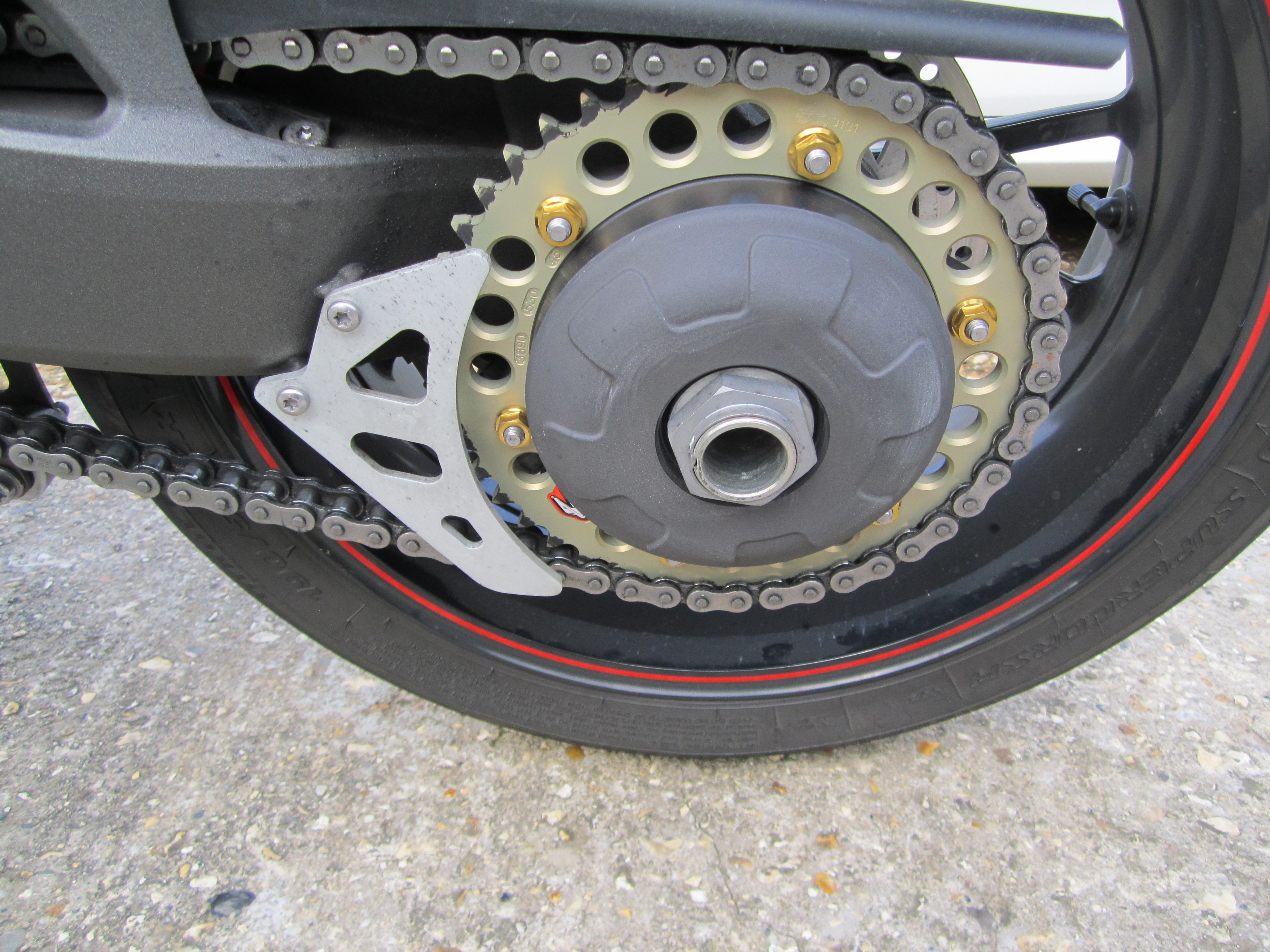

    Thought i would try 2 more on the back instead of 1 down on the front as it's far easier and you get a nice alloy sprocket.

    Hi Darkman, What does that do to the acceleration & does it result in a need to re-calibrate the speedo?
    Cheers. GAJA
  3. darkman
    7,568
    No idea on speedo yet :eek: but should just give it a little more punch, i normally go down one on the front with sports bikes but as this bike has less power and less revs i thought i would try + 2 on the rear and it shortens the wheelbase as well, bike was very stable before so 5/10 mm shorter should not hurt.

    I think this mod will send the speedo off. That's what happened when I did it in my previous bikes. You will need to install "speedohealer" made by a company called Healtech Electronics and calibrate to read the correct speed. It's all plug and play :)
    Unless of course this can be achieved through Tuneecu! !!I'm new to triple so I don't have a clue whether this can be done through tuneecu.

    I went down one on the front and up two on the rear.
    speedo does not read wrong, stays the same

    If you have the latest model with engine modes then ignore this (I don't think TuneECU supports the latest models), but for 2015 '94R and earlier if you want to alter the speedo it can be done with a feature that's already in the standard ECU. Connect using TuneECU and you'll find speed calibration is set to 100% as standard, TuneECU enables you to alter that.

    very, noticeable. on acceleration anyway, not concerned with top speed although 130 in 5th the other day so cant be to bad.
    Plus i have lightweight wheels which i changed around the same time as the sprockets, so a combination of everything.

    Only affects the speedo if you do it on the front iirc.

    Not on pre '16 bikes, sensor is on gearbox. Don't know about latest model.

    I've ridden it. Spins up like it's made from titanium!
    These bikes pull like a class full of schoolboys in standard form as you know. I can confirm Tony's is a definate improvement. So much so I'm going to try either/or myself soon.

    I've been looking on the net for both sprockets -1 on the front +2 on the rear but can't find them . Where did you guys get them from ?
  20. darkman
    7,568
    Renthal rear on evilbay :) try just + 2 on rear first
