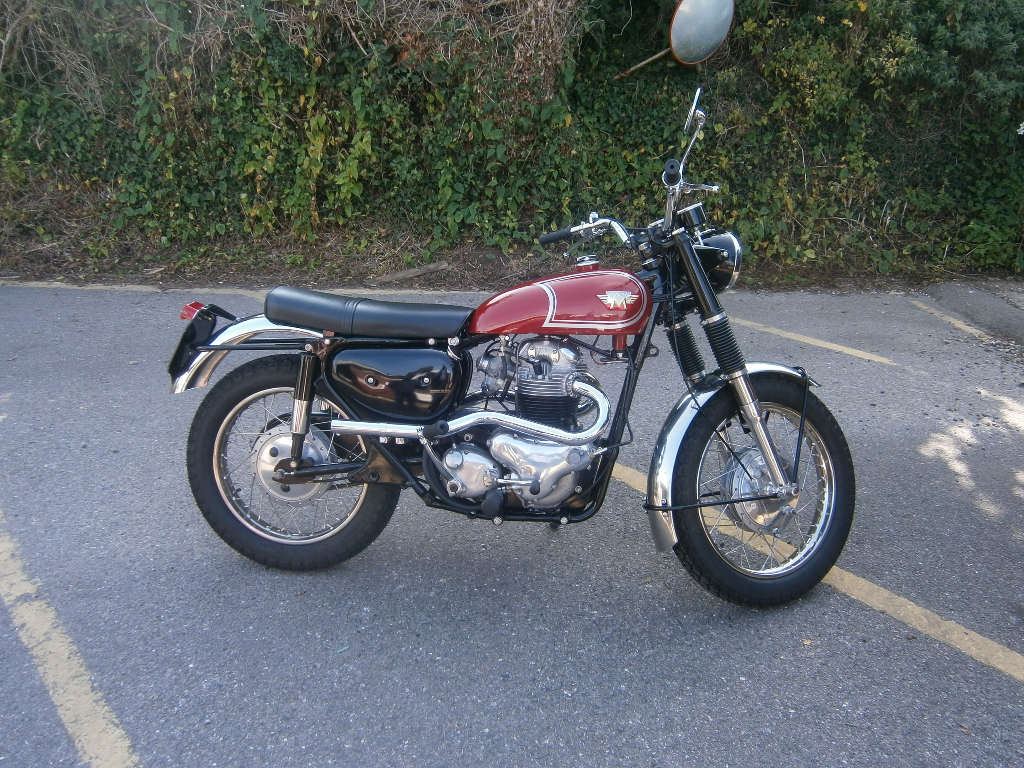

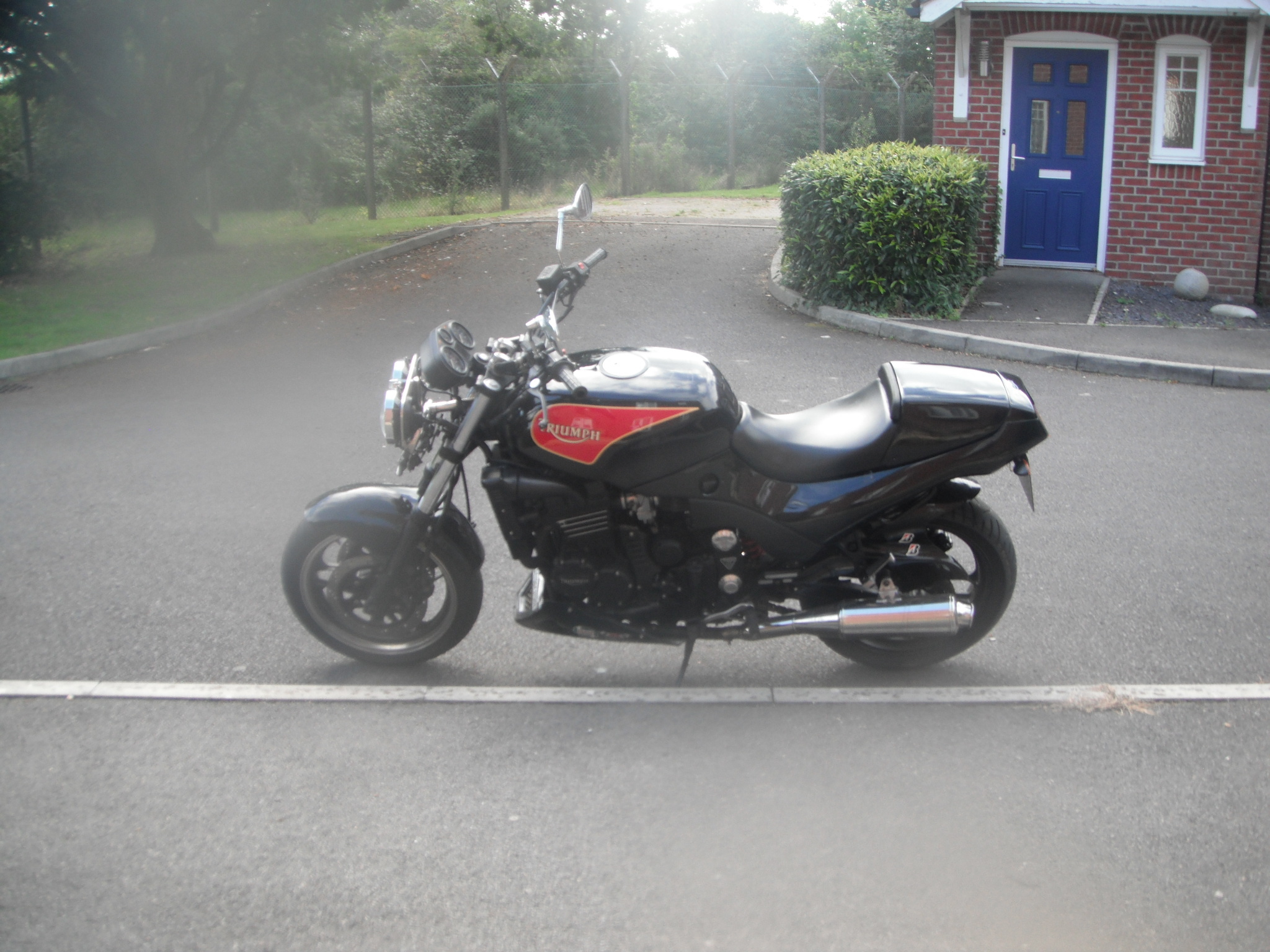

    Hey arsehole. You and cameraderie/brotherhood. bullshit, can go fuck yourself. Little boys should be seen, but not heard Here are my bikes. Where are yours ?
