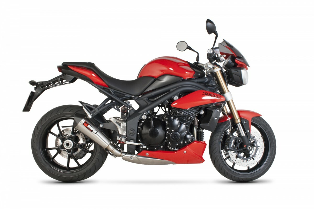

    I looked at a "fender"extender, and came to the conclusion that it would make little difference because the through comes off the tyre lower than even the extender reaches.I would think that the extender would have to come down to below 8 o clock. RTR-70-SE_side-1200x800.jpg
