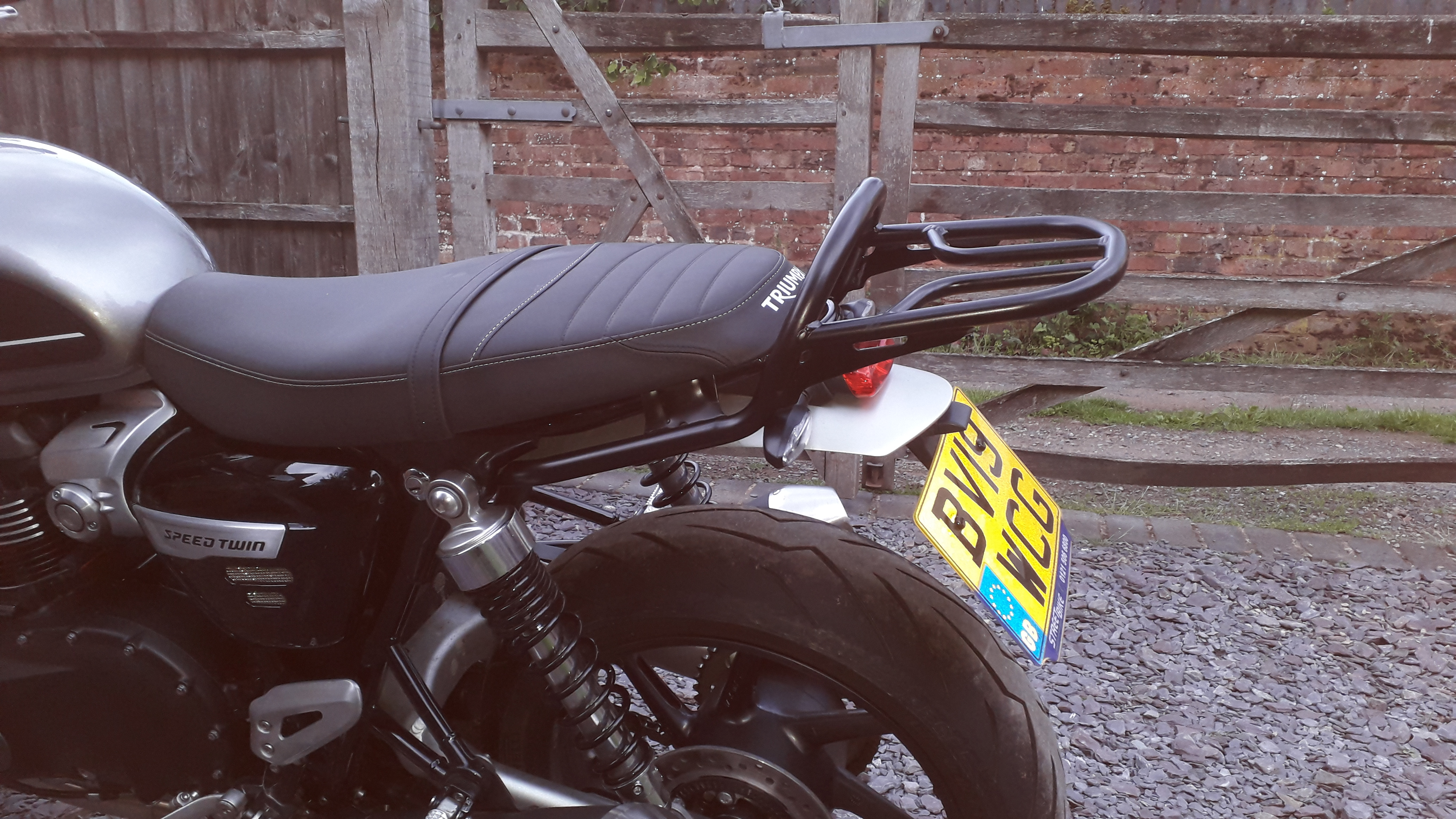

    Here is my Street Twin rack on my Speed Twin.

    Any mods required? Looks like you had some bending at the front to do.

    Just cutting. Then I slipped 2 rubber walking stick ferrules over the cut ends.

    It is on but it is only attached by the 4 rear bolts that are under the seat. The rails that run along the edge of the seat with brackets that attach to the threaded holes behind the shocks have been cut off and the new ones have not been welded on yet as I have not had access to my workplace, I wanted it to clear the indicators with not contact and no modification to the bike in any way which I will have achieved once the brackets are welded on.
    I recently realised that if you were to replace the original indicators with aftermarket short ones most of the clearance issues would be eliminated.
