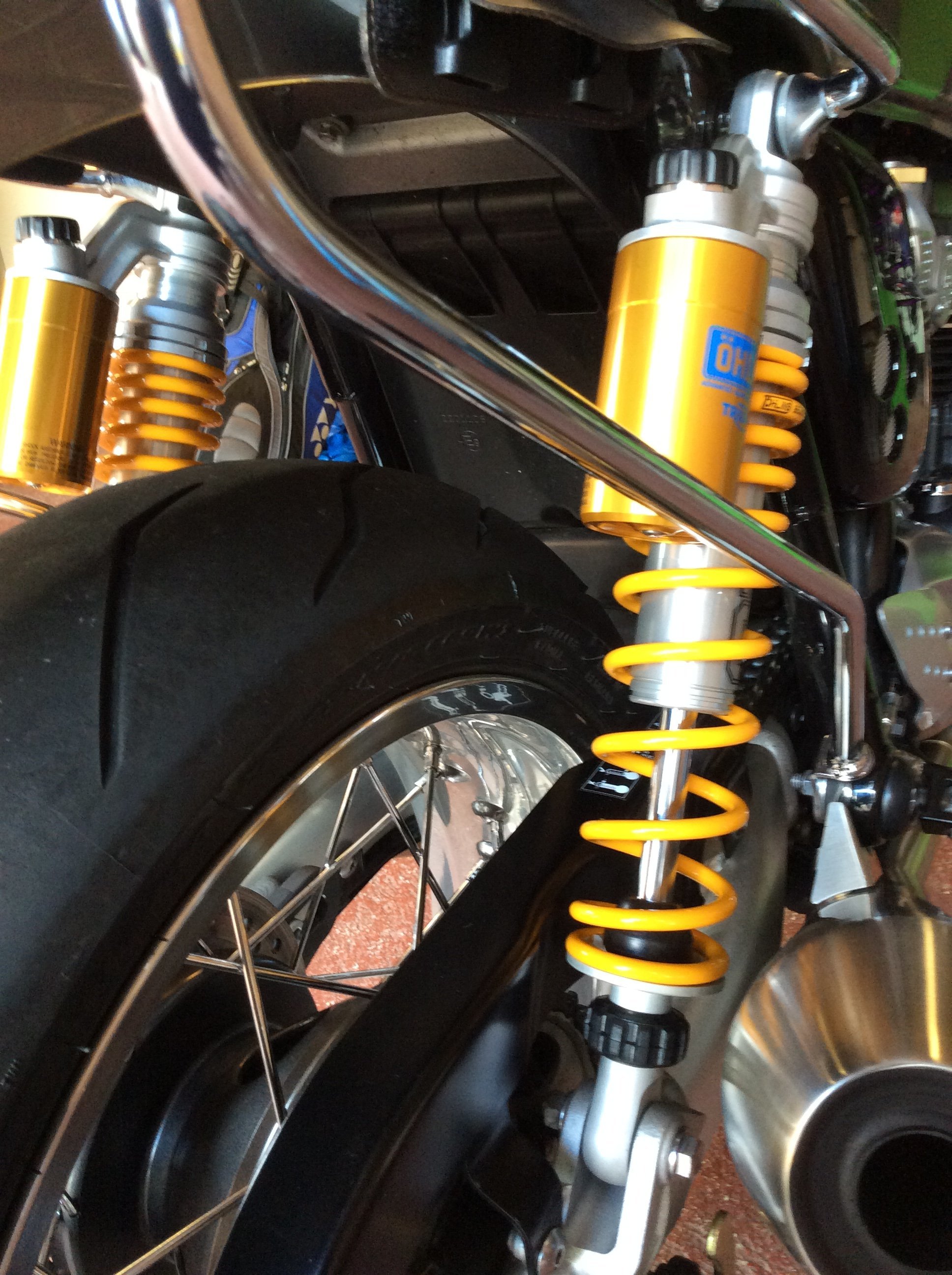

Asked my dealer Ongar Motorcycles, Essex to leak at the rear shock absorbers on my 6 month old Thrux 'R'. The springs are yellow (not painted but looks like polyeurethane covering). The plastic sleeves on the shock has been rubbing this covering away. Not only does this look pants but long term could lead to water ingress issues leading to premature spring corrosion and thus failure. The owner of the dealership showed absolutely no interest what so ever. Very disappointing, customer care at its best (not). I'm posting this in the hope that another 'R' owner has had the same issue rectified under warranty. Here's hoping

This issue has been covered on the forum several months ago in some detail. Check back because I know they were some members who had their Shocks replaced FOC
https://www.thetriumphforum.com/threads/thruxton-r-rear-shocks.8731/ You should have no problem getting those replaced, it's a known issue.

New rear shocks fitted under warranty by dealer in Romford (my dealer refused) Although on ride home, rear end very hard & odd feeling on flicking from one side to tother, had a look turns out right shock adjusted to hardest setting, left shock too softest! So no wonder! Have placed them both on half way, will ride again tomorrow

A faulty design is a faulty design. It was not covered under a safety recall, but a service recall. I would contact a number of dealers & see what they say. Nothing to lose. Express concern as moisture now getting under spring yellow outer casing, thus potentially weakening said spring through corrosion.

I just got the message from Triumph Benelux that my rear shocks will be replaced under warranty. I mailed Triumph UK and they sent the mail to Holland. Seems indeed that the problem is known and acknowledged by Triumph and that they replace the shocks no matter what the age of the bike is. Nice example of customer care, allthough I know that it won't cost Triumph one penny as Ohlins will have to deliver the replacement shocks... But anyway, nice !! Already made an appointment with my dealer.
