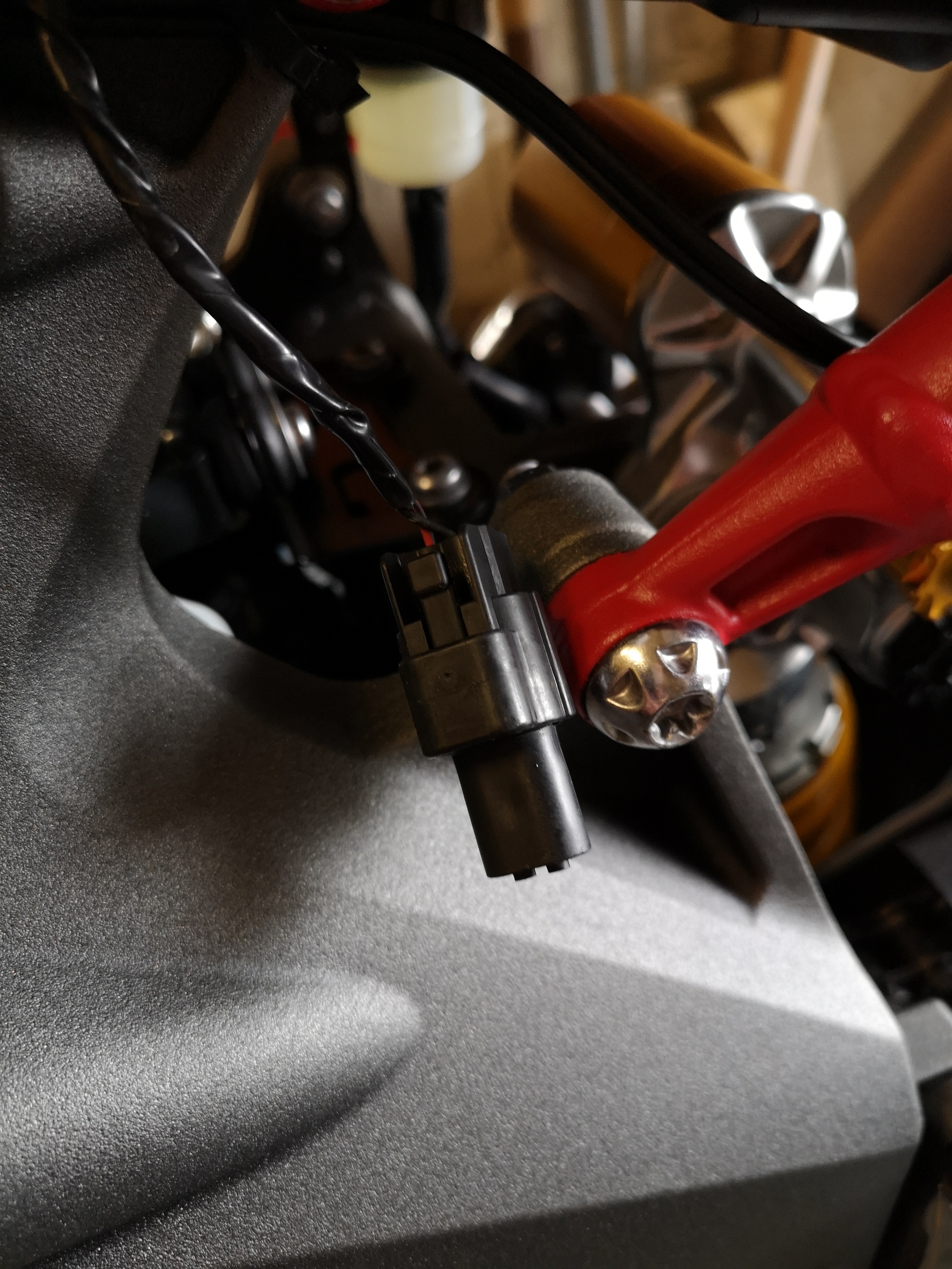

    This is so bloody frustrating! Once again, everything slows done because of a connector. I’ve located the quickshifter plug in the depths below the tank, but can I remove it from its location. It’s obviously got a plastic one-way plug that pushes into a hole, but groping below, my fingers do not have the strength to pull the connector free. Having a break and then try again.
    Edit: 5 mins later, a bit more pulling and wiggling and it popped off. Turns out it's just two snap ons on the side of the connector plug holding it down.
    Now to get down to the, hopefully, straightforward task of fitting the unit. Fingers crossed!

    So, the quickshifter is now fitted and works very well. For someone who has never used one before, within an hour the shifts were becoming seamless, once I’d got into being very positive with shifting the lever and not closing the throttle off. By the end of the ride I was doing very smooth up shifts from as little as 3000rpm.
    As for the fitting, it was a bit fiddly at times and not quite as Triumph Instructions stated. But, all the little problems were easily overcome (finding and removing the harness connector was a pain, as with the heated grips), with the exception of one. I fail to see how the spring clip can be inserted into the front ball joint as the “business end” of the new gear rod is in the way. I think it’s most unlikely to separate given that there is virtually no movement of the rod in the direction of separation. If anyone knows better, perhaps they would advise.

    The clip on the front ball joint is inserted from the front and then pushes round just behind the flat bit to secure it. I had a lot more trouble getting the back one on, eventually taking the footpeg and lever assembly off to get to it. Everything is a bit tight!

    Ahah, you know I didn’t look to see if the drilled hole for the clip went all the way through to the front. I just tried to put it on the way it came off the old rod. I’ll go in to the garage now and take a look. The back clip went in in a matter of seconds. Thanks, MattP

    I know I should've looked in this forum before installing the QS, spent an hour finding the connector then another hour trying to figure out if it was right and how the hell it should fit....took the 2 rubber plugs out just to later realize the whole top comes off.
    The speedy isn't really to mechanical friendly sometimes.
    But...now when its FINALLY on....its flippin great fun...
    Thanks for sharing the pic.
