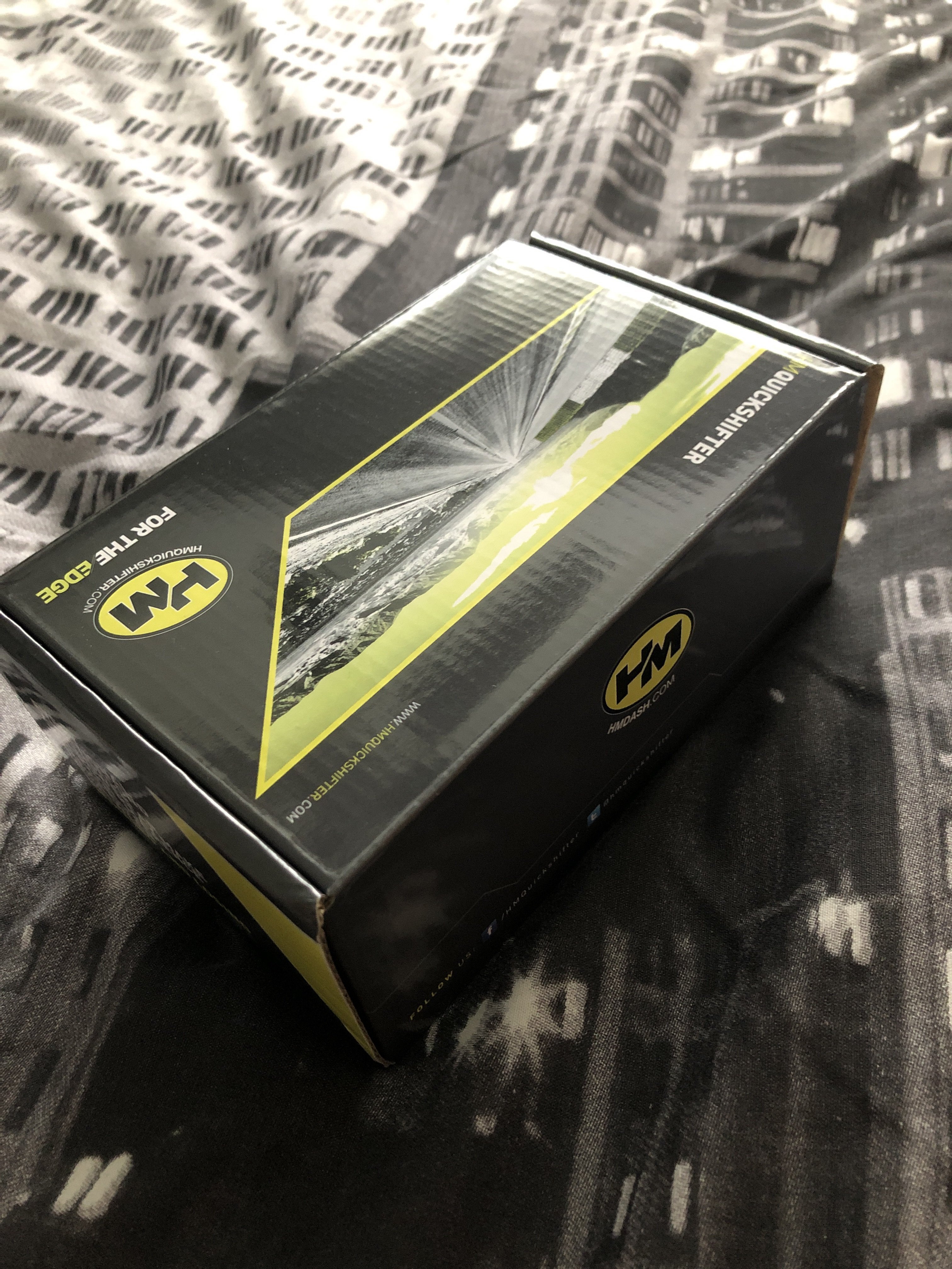

  18. Burny_13
    Burny_13 Active Member
    Jun 16, 2019
    67
    Reading
    I guess I will let you know, this arrived today totally unexpectedly!
    I spoke with HM a few weeks ago about the issue and explained that I work in R&D on transmissions for a living and I would be happy to use my bike as a test mule for them to confirm compatibility as an owner suffering from the issue.
    I will let you guys know how I get on!!

    Wow, that's cool! How great to find a new HM quick shifter on your doorstep free of charge. Hope it works well. Let all of Speed Triple owners know how it goes please!
  20. SteveRS
    SteveRS First Class Member
    Jan 12, 2019
    862
    British Columbia
    Is that the stand alone blipper/shifter? I’m very interested in seeing how this works out for you. Please keep us posted.
