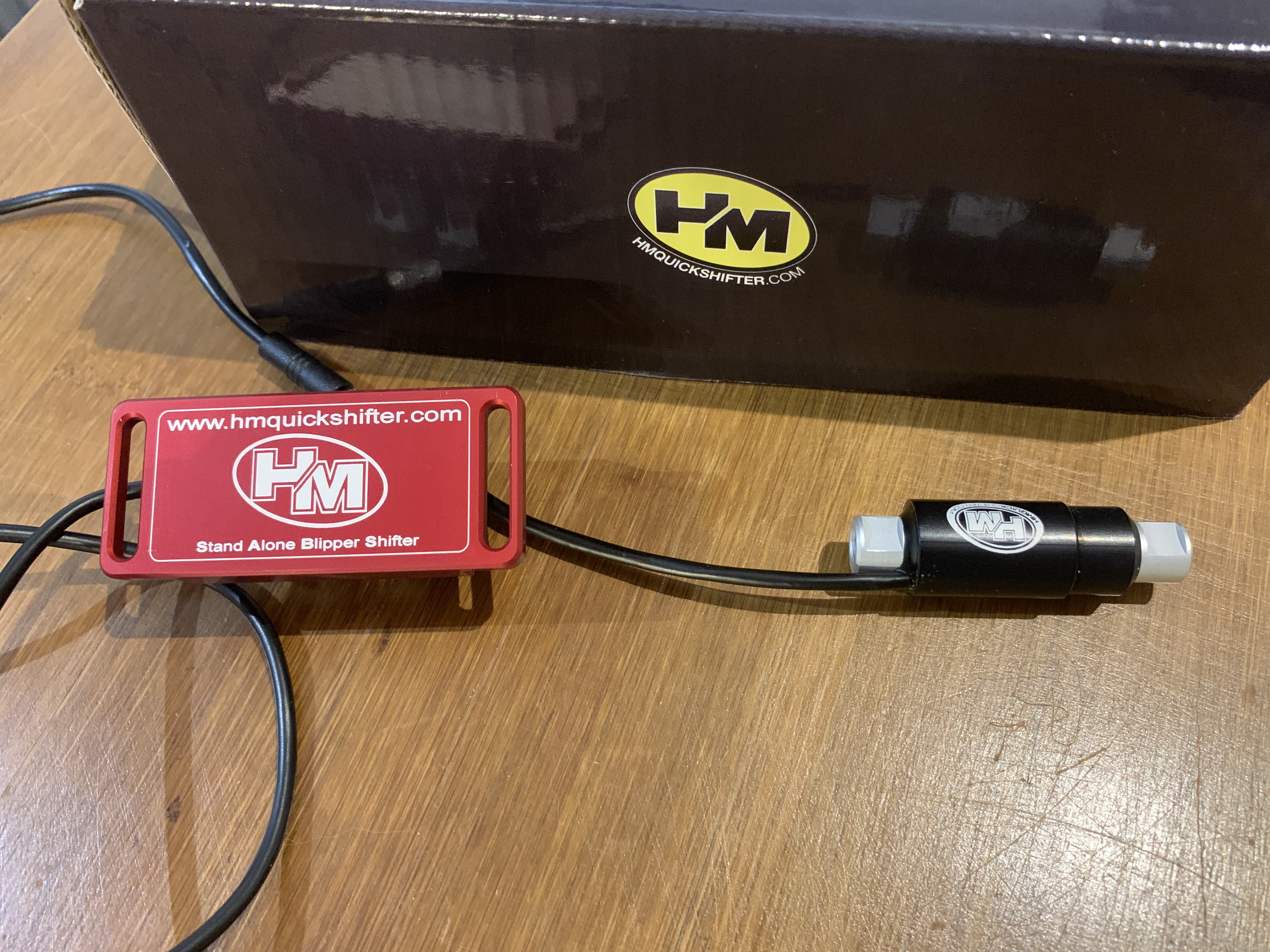

  9. Burny_13
    Burny_13 Active Member
    Jun 16, 2019
    67
    Reading
    #209 Burny_13, Aug 19, 2019
    Hey, bet you're really excited!
    At the moment, I cant get the blip to function below 6500RPM. HM have looked at this remotely, but are unable to see the issue, so its booked in on their dyno for the 28th. I will have some answers then! (and a new suspension setup too cause when in rome.... )

  11. White-Vador
    White-Vador Well-Known Member
    Apr 11, 2019
    77
    South of France
    Just recevied my SABS pro !!!
    I wish its resolving all the problems ....

  20. Burny_13
    Jun 16, 2019
    67
    Reading
    #220 Burny_13, Aug 29, 2019
    All done, HM Quick shifters have been fantastic and got a good setup on the unit.
    It is not 'perfect' and I will continue to develop the setup on the road, if anyone wants the latest setup from my bike, please drop me a PM with your email address and I will send it over. :)
