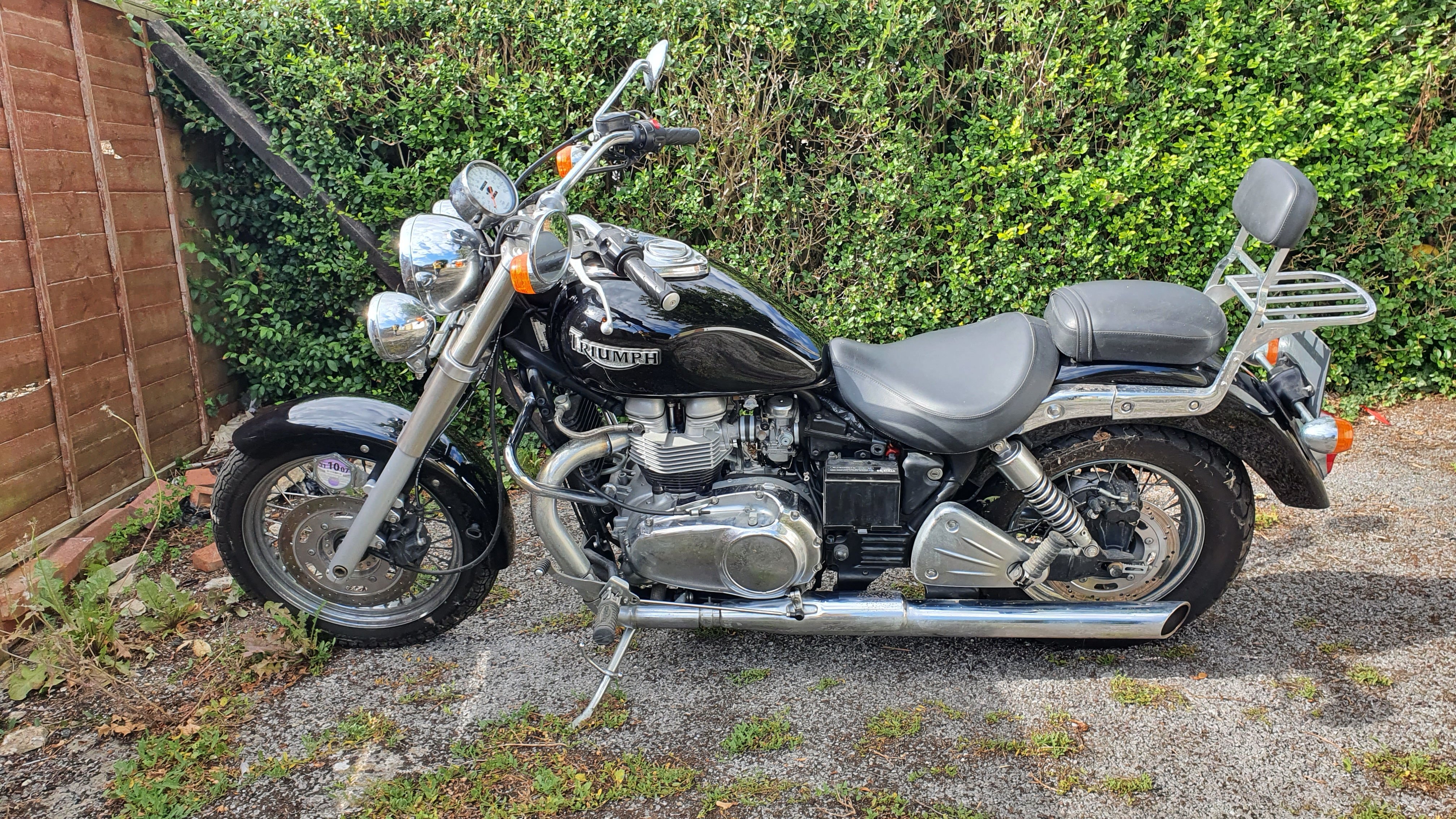

    Well I've picked the bike up and it's safely in my garage now. Initial impressions are good. The chain was lubed up before it was put away, the fuel tap was turned to off and the chrome was covered in a thin coat of oil. There is some corrosion on the chrome, but not a huge amount. There is no obvious corrosion anywhere else. The brakes haven't seized on and it rolls with no problems. My initial thoughts are that this shouldn't be too bad a job. Checking the oil, fuel and putting a new battery in it are next to see if it turns over and fires up.
    (I need to change the number plate before I can MOT it, and the owner has the battery cover and a few other bits put in a safe place.)

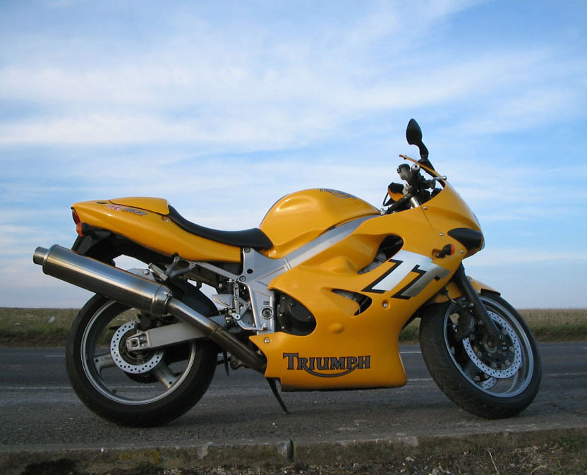

    Yes, but very different to what I'm used to.
