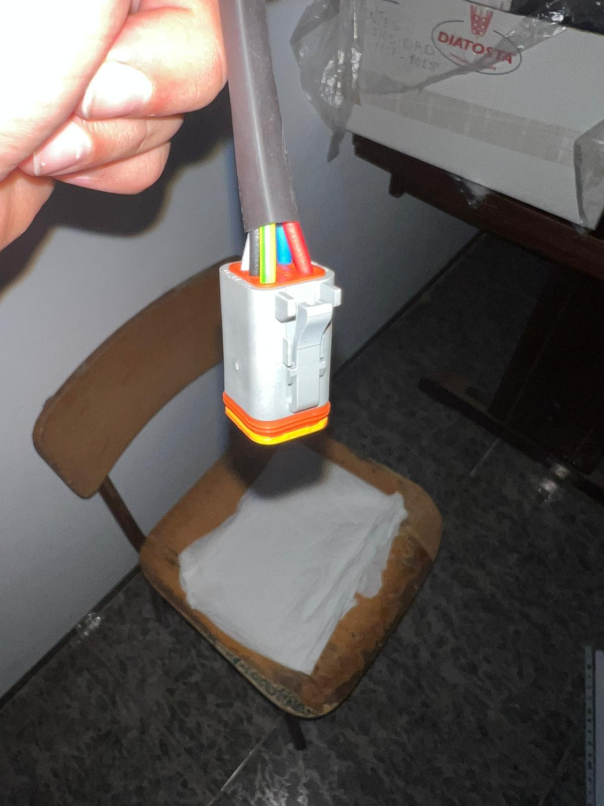

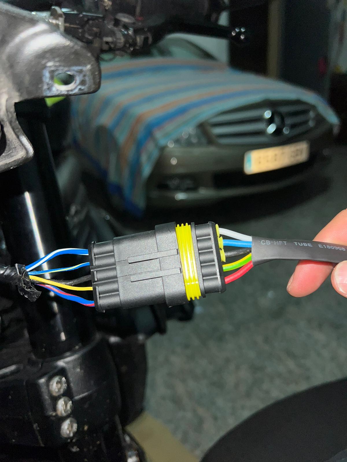

  1. Good morning, I am helping a friend to install the headlight of the triumph street triple rs 2020 on the speed triple rs 2018 and we are having a problem and that is that when we put the high beam on, the low beam turns off and the high beam does not turn on totally, it seems that it lacks current.
    The installation of the cables is correct and verified several times by him but I share the video and photos to see if we can help him to find the problem.
    If someone can provide me with the wiring diagram of the street and the speed, I could see if any cable is crossed in any connector.
    Cheers!
    Send video of the problem and upload photos so we can see the cables.

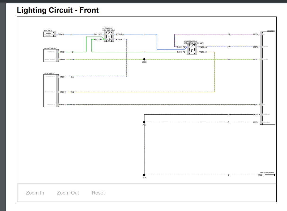

    Street Triple RS headlight wiring

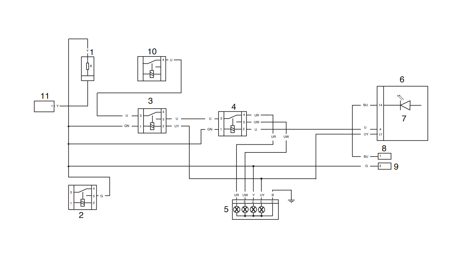

  4. Thanks friend, now need the wiring of the speed to look well.

  6. tcbandituk
    Apr 8, 2016
    2,895
    Reading
    Diagram is at the start of page 528, you need to zoom in on it to see it properly.
