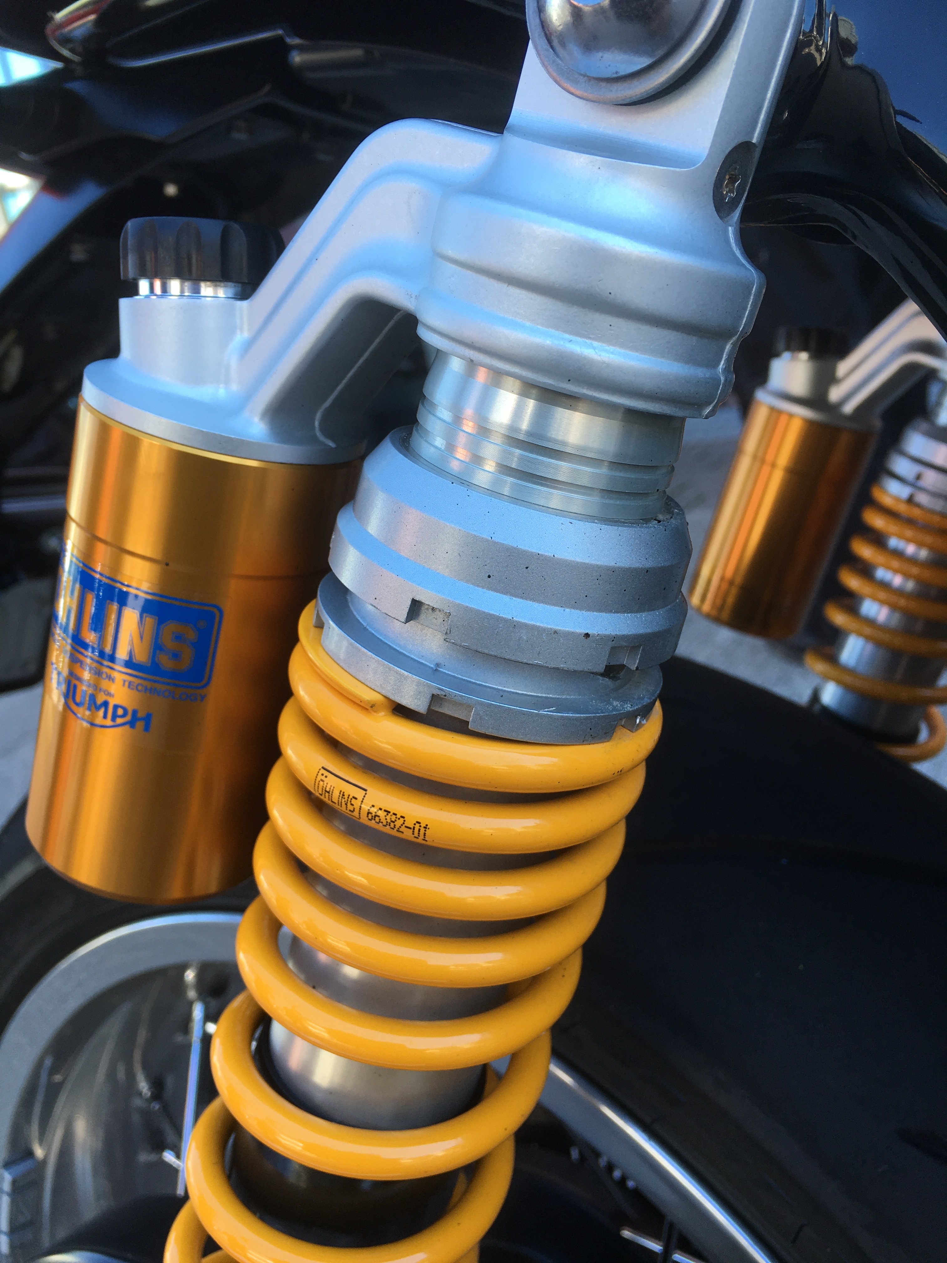

    I'm starting a new thread on this subject as it doesn't seem to have been properly worked out before.
    This was of interest to me as I carry passengers & couldn't understand why Triumph would include tools that you couldn't use.
    This is for information only & I take no responsibility if anyone chooses to do this themselves and damages their shocks or hurts themselves.
    Basically it appears that you CAN set spring preload on your Thruxton R Öhlins shock with the c spanners provided by Triumph even though they (and all the dealers I've spoken to) don't seem to know exactly how to do it themselves.
    The mechanics at Hess Motorrad in Bern spent some time figuring out how to adjust the preload on the Öhlins shocks on the Thruxton R. Kudos to them.
    I took a video of it being done.
    Note that the spanners are a fairly loose fit and it is possible to scratch the finish and also break off the corners of the indents if you put too much force in the wrong direction.
    Therefore you do this at your own risk of marking or damaging your shock adjusters.
    The Hess Moto mechanics managed to make a single click adjustment.
    The manual says there are two adjustments, i.e. positions 1 (default), 2 (shown) & 3 (mentioned on p.101 in the manual)
    The manual says to 'loosen the locking ring' which has led us all to think that you have to unscrew it.
    It seems that you don't.
    The Hess Moto mechanics engaged both c spanners simultaneously and squeezed them in OPPOSITE directions to open the adjusters by one click-stop.
    *SEE YouTube VIDEO to see the directions used by the Hess Moto mechanic*
    Done correctly there is a smooth, though stiff, click-stop of adjustment.
    It may be possible to open them one stage further but perhaps the increased spring pressure makes this too difficult. The c spanners are also quite short and, as previously stated, a loose fit, which makes them prone to slipping.
    Hess Mottorrad felt that you should only do one click-stop. Further preload can be done with the shock removed & circlip setting altered.
    You should ask your dealer to do this for you if you are not sure how to do it.
    Don't do this unless you are prepared to accept some scratches and possible other cosmetic damage.

  8. lex491
    lex491 Well-Known Member
    Jun 5, 2016
    20
    53
    Switzerland
    Hi Pottsy
    I have not ridden the bike with a pillion with this adjustment yet. The c spanners are truly poor quality & don't fit at all well. I am looking for better ones before I start regularly setting my preload for carrying passengers. My wife is anyway quite light & I find that just changing the rebound & compression settings is sufficient for gentle pillion riding.
    If you have had the shock removed & set up to only have one ring showing then you must be a lighter than average rider as you will have permanently taken pressure (preload) off the spring.
    The factory setting suits my average weight so I will leave this alone. This is the 'base' setting or setting 1.
    The point is if you then want to take a pillion you can temporarily increase the preload by using the c spanners to set the lower part of the outer rings into a choice of two detents. In the photo you can see the gap created at the first detent. This is pushing downwards from the circlip setting, further loading the spring.
    The manual recommends position 3, the second detent, for pillions plus the rebound & damping adjustments. I have marked these settings with a little bits of sticky tape...
    #8

  15. Pottsy
    Pottsy Well-Known Member
    Apr 10, 2016
    257
    115
    Plymouth, UK
    Hi Wag
    So how many rings can you see at the top of the shock. If you have gone up two that would put you on setting three so no rings should be showing ! I think.
    #15
  16. Wag
    Wag Active Member
    Jun 19, 2016
    179
    exmouth
    Soz its tucked away now,i moved it two clicks-theres about1/2 inch gap now. I just rided about 20 miles and it felt better (you never know if you remembered the previous feeling properly though , a bit like adding 5bhp to a 120bhp bike !)
