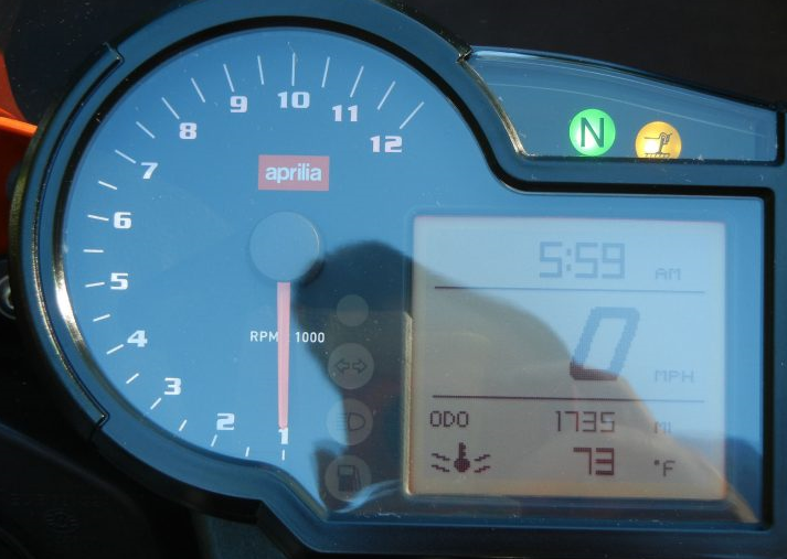

    Incidentally, I was speaking to an associate the other day, and told him I was riding a Tuono now. He said he'd borrowed one recently and absolutely hated it!!! Same as he hated Ducati's (old v-twin 1098's etc), horrible lumpy things. If I tell you he has 10 bikes in the garage, all of them Japanese, and most of them V4 & 4 IL engine (Hondas, fireblades, etc). Been riding these 4's all his time on bikes, just didn't know how to ride a big twin.
    Without having a shot on your Thruxton, wouldn't know if it had a problem, but I would guess, maybe your trying to ride it like a 4 ?
    Keep it above 2000 revs when dawdling through villages (only time I ride slow enough for mine to 'chug'), and just use the mid-range torque, short shift up and just enjoy that surge of torque. Your four will happily pull between 1000-2000, but your twin won't. Your twin won't rev up to 12,000 (mines does:cool:), so run around in that lovely big lump of twist available in the midrange.

  17. MrOrange
    Don't think they fitted a rev limiter to the Tuono! Really shouldn't do 12k on a v-twin. :p

    There is one! you can set it to the limit you prefer

  20. MrOrange
    It does !!!:cool:
