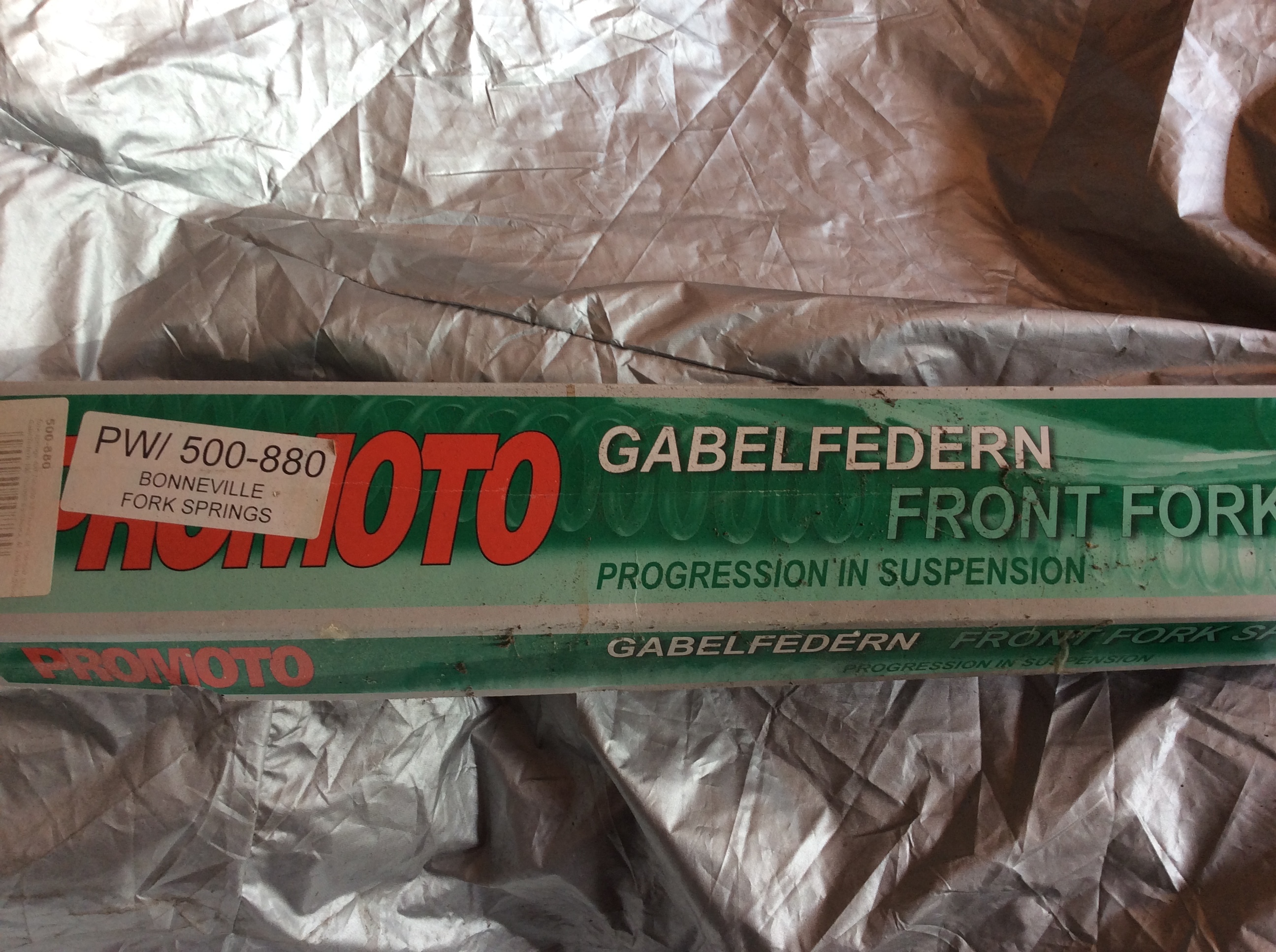

    Just seen Wilbers do a cheaper spring called a Promoto, but that's still £99 without oil.....

    I bought mine for £79.99 v £89.99 6 years ago...... go with the best deal you can find. I imagine new water T100 and old air T100 springs are different items?

    £84 Hagon same item......note numbers!
    400-088-11 400-088-11 TRIUMPH Bonneville / Bonneville T 100 (908MD/ 986MF) 00> (20) 150mm Air Gap
