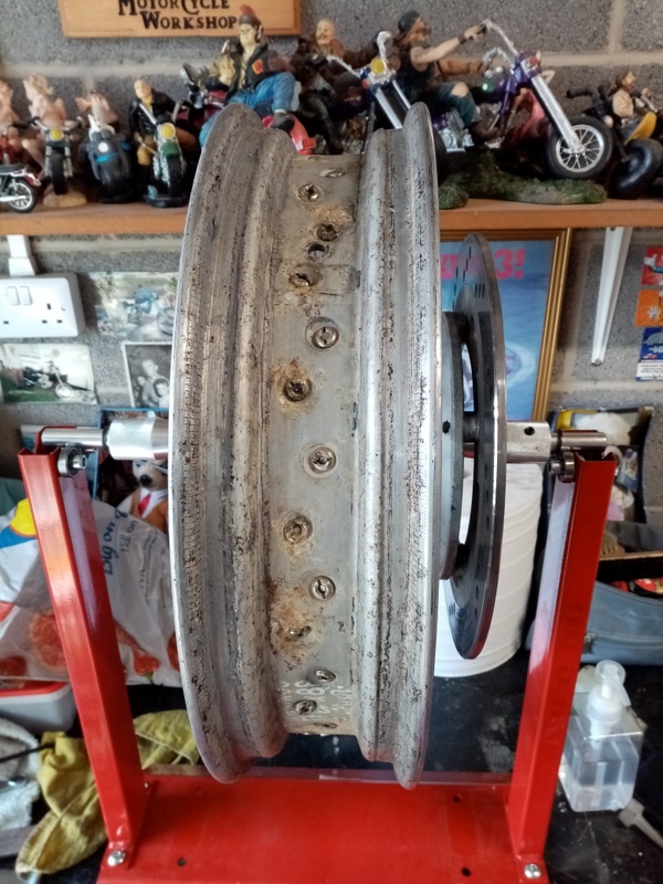

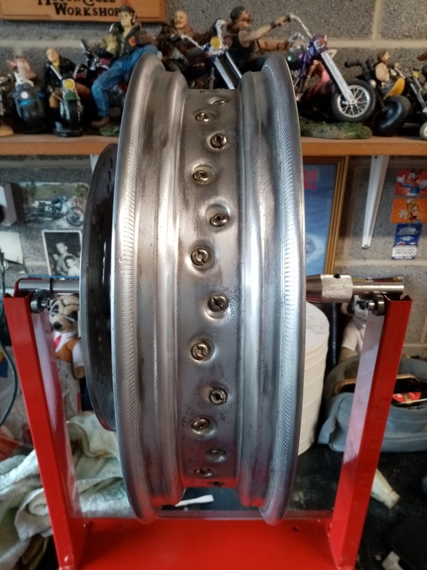

    Front Rim, before and after cleaning.

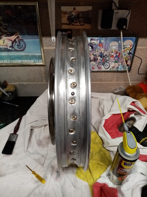

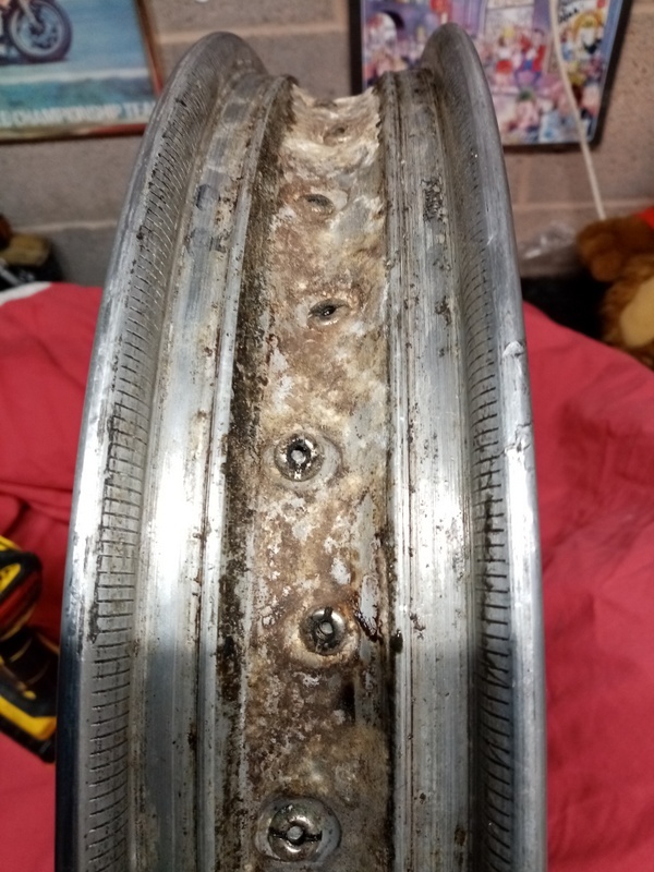

    Rear rim before and after cleaning.

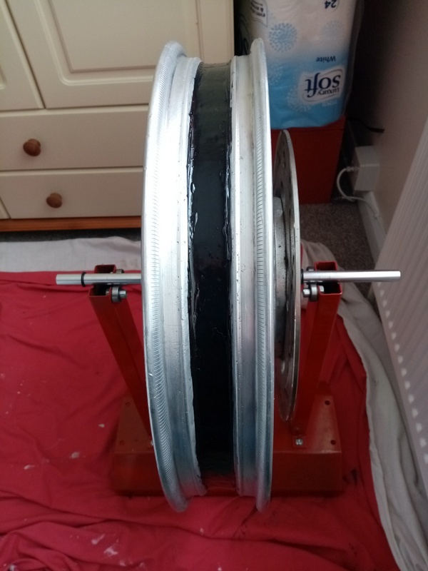

    Front rim done.

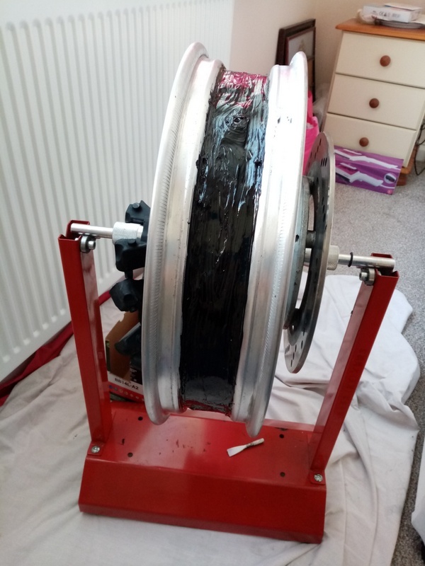

    Rear rim done.
    In the almost 3 years that I converted my rims, I have never had any problems with air loss, problems with handling or anything at all. I just like the thought that if I get a puncture, I can now fix it at the side of the road, but also if I do get a puncture, the air won't suddenly leave the trye and the consequences that could come with it. This next statement only applies to my 1995 Thunderbird.
    The Akront Rims do have the correct safety humps for our system to work. This was a guy in the central wheel company who actually built my wheels. I was considering getting them to fit their system, but they'd only guarantee it for something like 12 months or so.
    Please check before you do this that your rimes DO HAVE the said safety hump.
    I'm not recommending you do this, it's entirely up to you.
