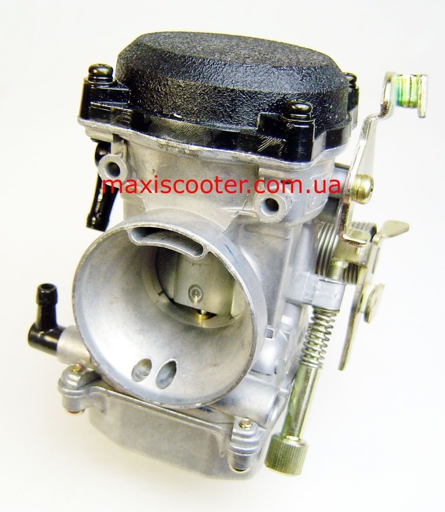

    I suspect dirt; plain and simple. A £3 aerosol of carb cleaner from Euro Car parts or £7 from Halfords wants to reverse blast the little apertures in the floor of the carb venturi. Carb shown not quite identical but you get the idea.
    If it doesn’t work check the exhaust header temps. The crossover pipe can deceive. You just might have an ignition coil on the blink affecting both sides intermittently.
