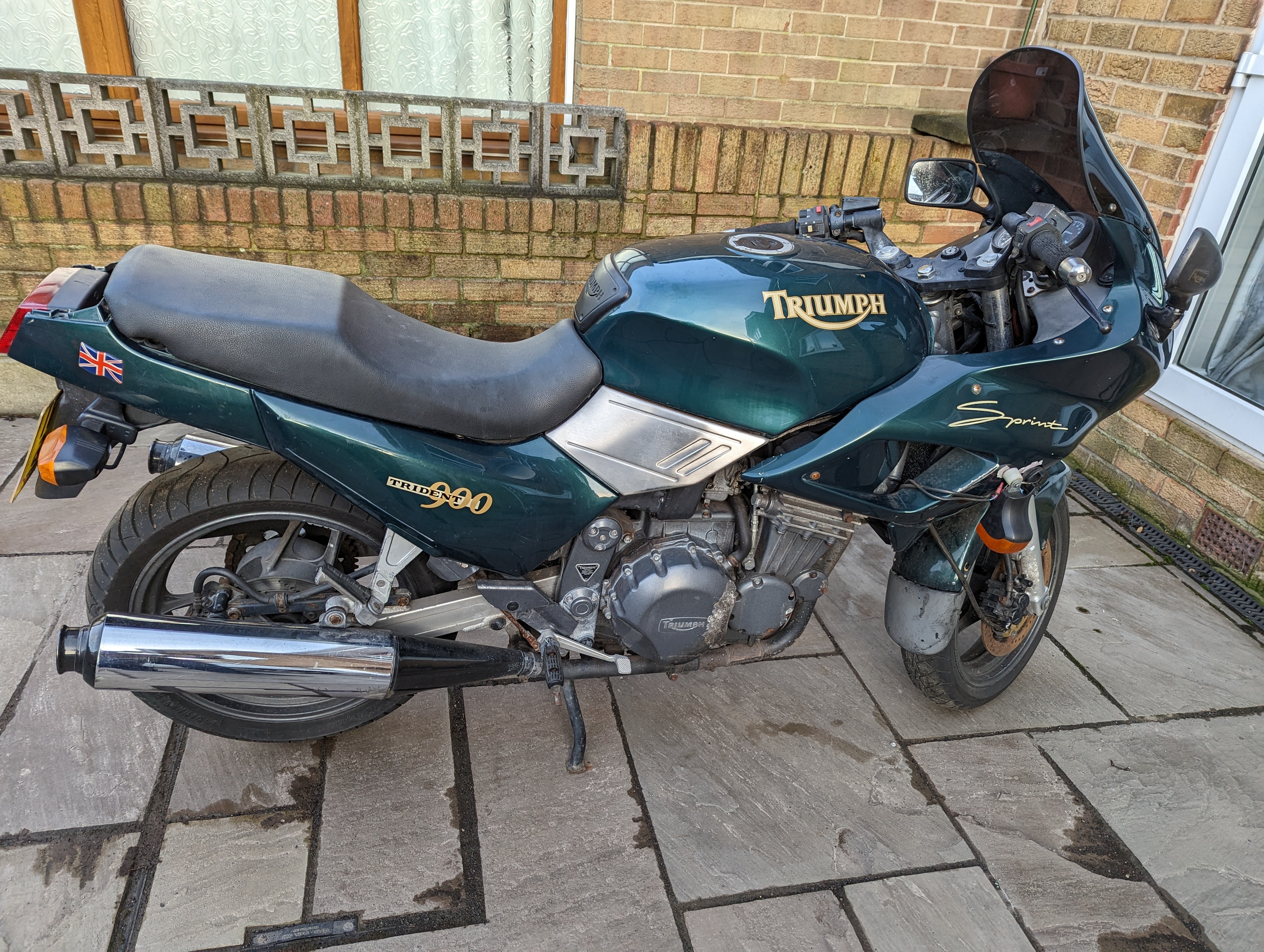

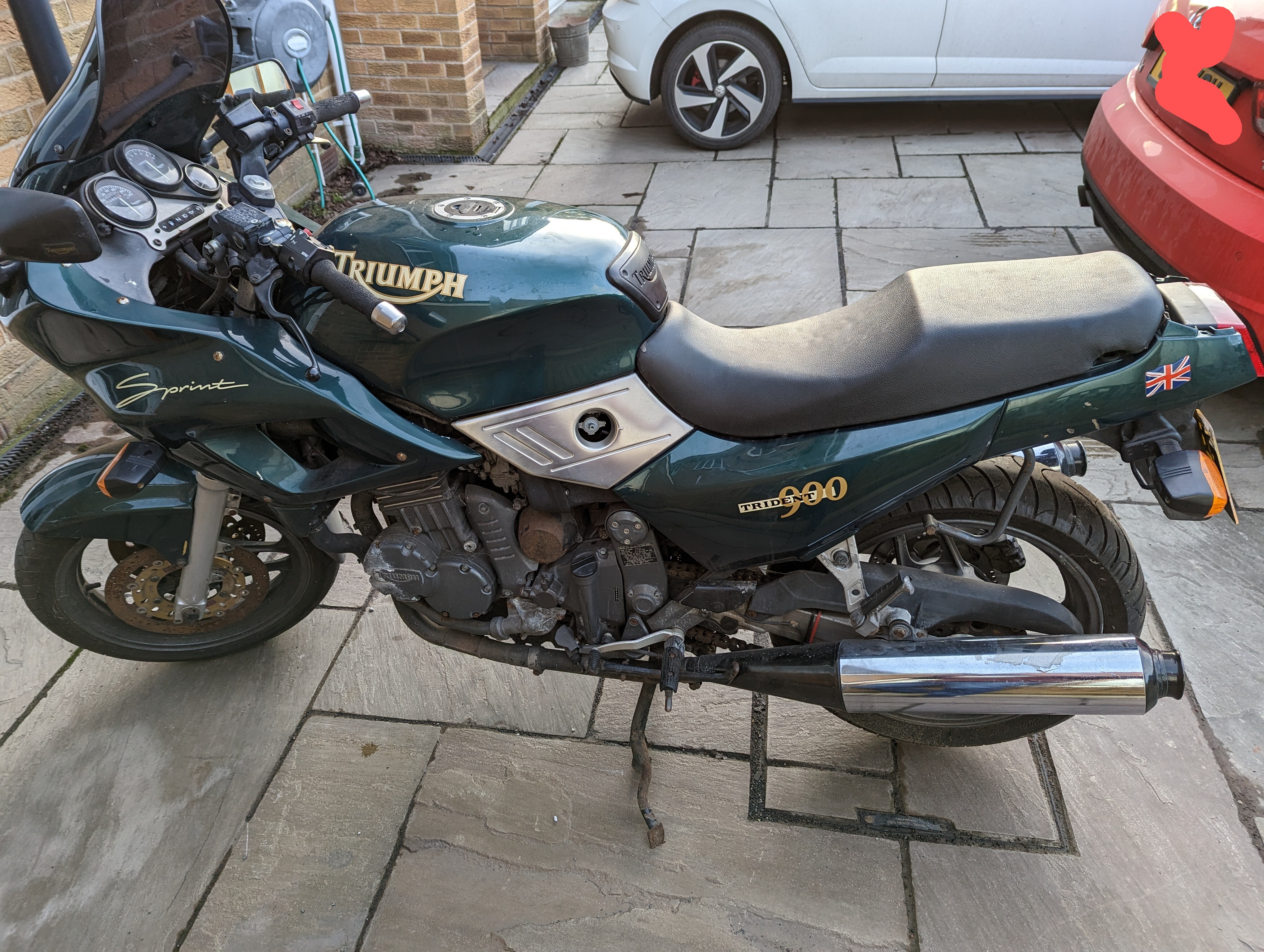

    It's home. It's not a 95 though, it's. 93. I was torn between restoring to trident standard or customise it.
    Going to get all the panels resprayed but same colour and the sprint front fairing is definitely going, no matter what. Is it saleable? Are these sprint fairings sought after?
    I need a trident headlight though.
    I also now have two plastic caps for the fuel tap as I got a small box of bits including the missing rear section of fairing and grab bar.

    Looks pretty complete, really - just a few odd broken bits and the common failure to replace an original indicator!
    My personal view would be that, in the long run, conversion (reversion?) to a Trident will add a fair bit of complexity and expense to the project IF you're going to look for an entirely original look.
    You'd need headlamp; shrouds and instrument cluster - so there's your original mileage screwed! The front wiring loom might be different, too, as I imagine the Sprint's might be longer to allow for the fairing.
    You could retain the brakes but they're better than/different to the original - or at least the fronts are - as the Trident has (IIRC) non floating discs so if you're looking for the wholly original look they'll be obviously different.
    The silencers on the Sprint were, I think, lower than on the naked Trident as the Sprint was set up to optionally have side panniers fitted - the original "sports tourer" approach.
    It's difficult to know if the Sprint fairing is desireable and/or saleable - I'm guessing there might always be somebody looking to replace their cracked or broken fairing with a complete OEM one. If you are determined to remove it then it's probably worth hanging on to, if you have the space to store it. How much it's worth depends on who's looking to buy and why. It doesn't have the original windshield so that might devalue it slightly.
    A big project but a good one with a sound base.

    With it being a trident, the clocks and instrument cluster remains the same doesn't it?
    Looks the same as the Daytona 900 I had a long time ago.
    Everything should be trident originally with the exception of the sprint front fairing and headlights.
    Didn't know about the brakes though

    Hi Relay.
    No, not quite - original Trident clocks sat in a "binnacle" and were configured with the temperature gauge located centrally above them ..... like this
    https://www.ebay.co.uk/itm/17557438...MIsciY0NrR_AIVKe_tCh3RogJfEAQYASABEgL1GPD_BwE
    If you're looking for the original, "naked" look, the clocks will have to be changed.
    The solid front brakes on the Trident look like these ;-
    https://www.ebay.co.uk/itm/266072734608?hash=item3df32bbb90:g:6EIAAOSwQv5i7Nye
    The early Sprints were badged as Tridents - I think later ones got different badging.
