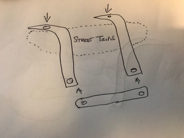

    hi, when i mount my soft bags on my triple, i made up a metal pannier rail, very straightforward, just time consuming as i dont want them on my bike all the time.
    easy job if you have some basic tools, 1" flat bar, cut around 250mm, 2 each side, bend and shape them using your 2 side exhaust cover mounting holes as a guide, bend them so they sort of wrap over the plastic and have a gap of around 1"
    then another bit of flat bar from each hanging down part, if you can weld, weld it, if not a m6 nut n bolt
    easier if i get a pic, but its do able for not a lot of money

    this is the way i did it, sorry no pics of it on bike as its not fitted and bike is in hibernation for winter but hopefully my shite drawing will help
