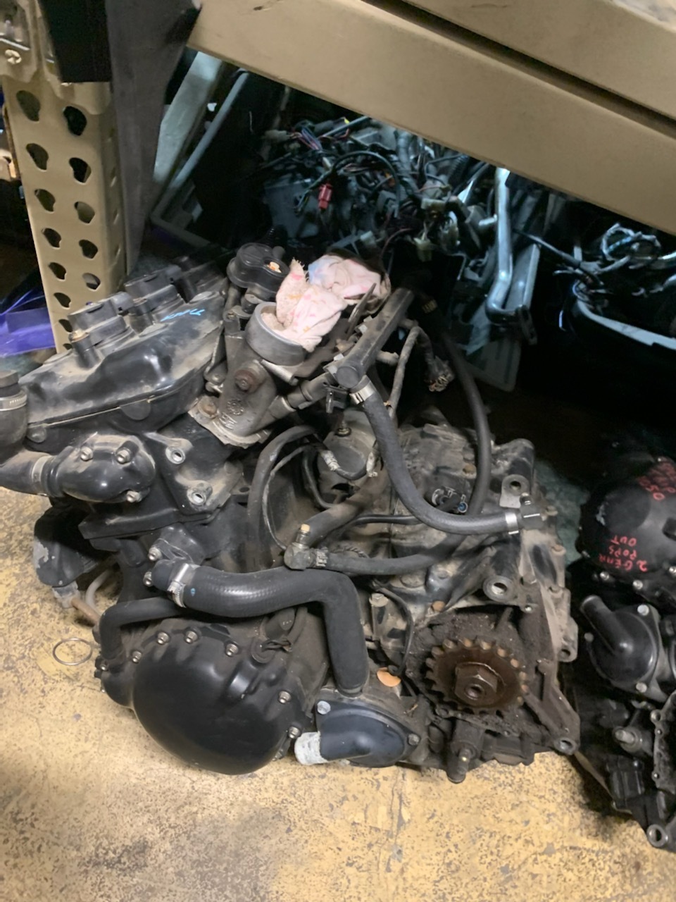

    Agh,,, I found one. its from a 2003 Tiger 955i. it looks identical but will check on the specifications. I suspect it will be tuned for more torque and less outright power, so I think swapping the heads will be a good move. If, however, its the same, I could just leave it.
    At least this one doesn't leak oil from a crack and was running two weeks ago.

    I've attached an image of the new engine that the wreckers guy sent me.

    if it the same spec, then I agree. If its not, I might have to swap the head or just the cams as they might have less lift and duration than my original engine.
    I'll let you know how it goes.
    yes, I'm hoping its just the head but if it is a piston swap, I'll be in for a rebuild too I guess.
