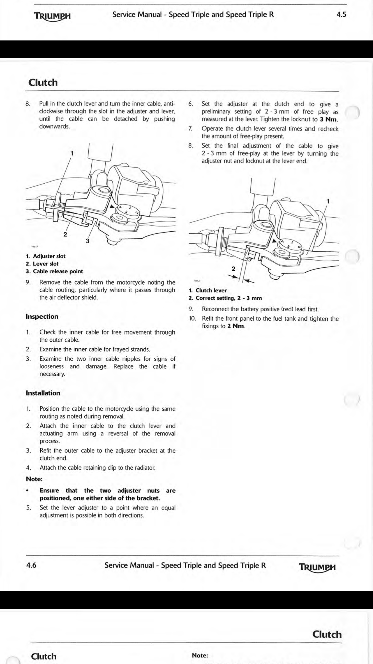

    This is the workshops ideal....
    #32
  13. thebiglad
    8,102
    5,072
    I thought it was like that, but on my bike if I set the free play according to that, I have the devil's own job of finding neutral. So rightly or wrongly, after trial and error I run it my way,without any apparent problems. :rolleyes::rolleyes::rolleyes:
