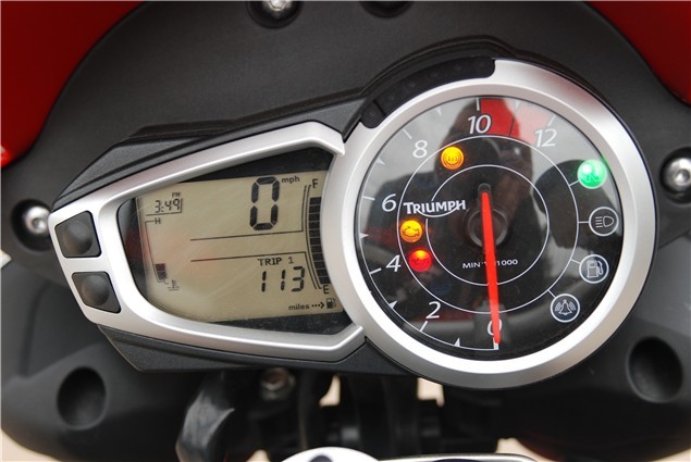

    depending on model age etc..this is a pic of a speed dash

    Sorry - no thats not my bike but a 1050 speed image gleaned from tinternet regarding Davis post earlier regarding red/orange lights on RoadSprockets post
