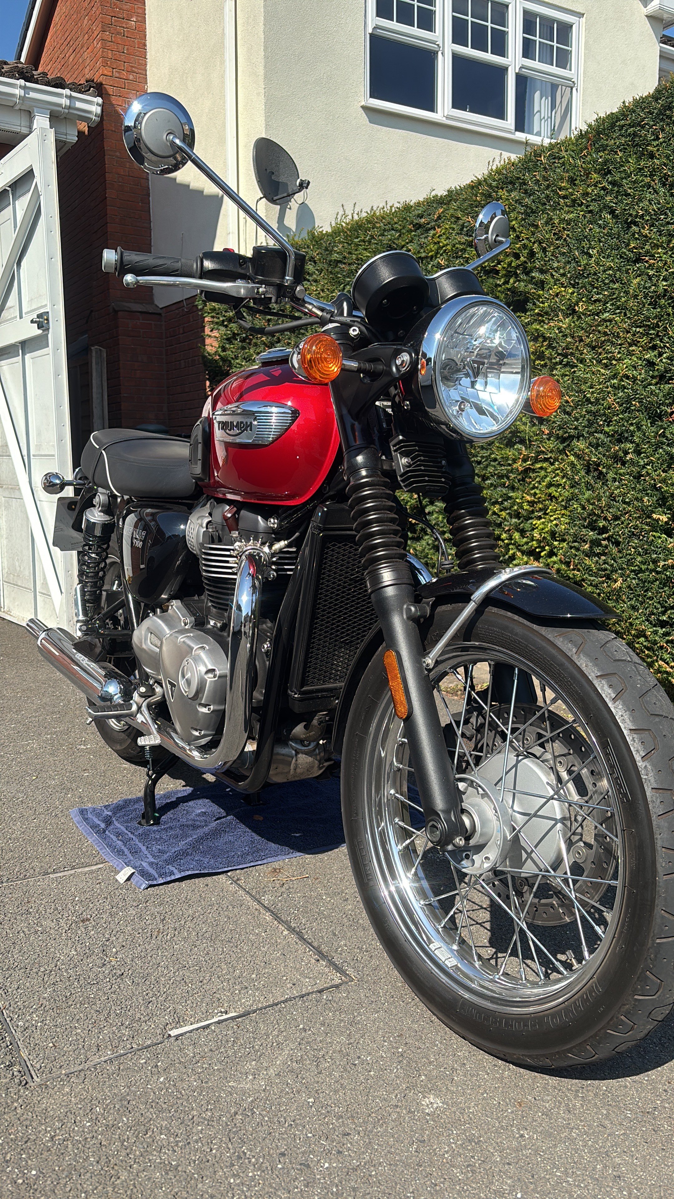

    Thanks all. New Centre Stand is now on the bike and I'm really pleased with it. I fitted it myself and saved circa £45 labour charge. I also lubed the chain with Triumphs own Chain Lube which so far I'm impressed with.
  2. joe mc donald
    16,074
    @Rob2025 Great job and nice Bonnie. Great picture.
