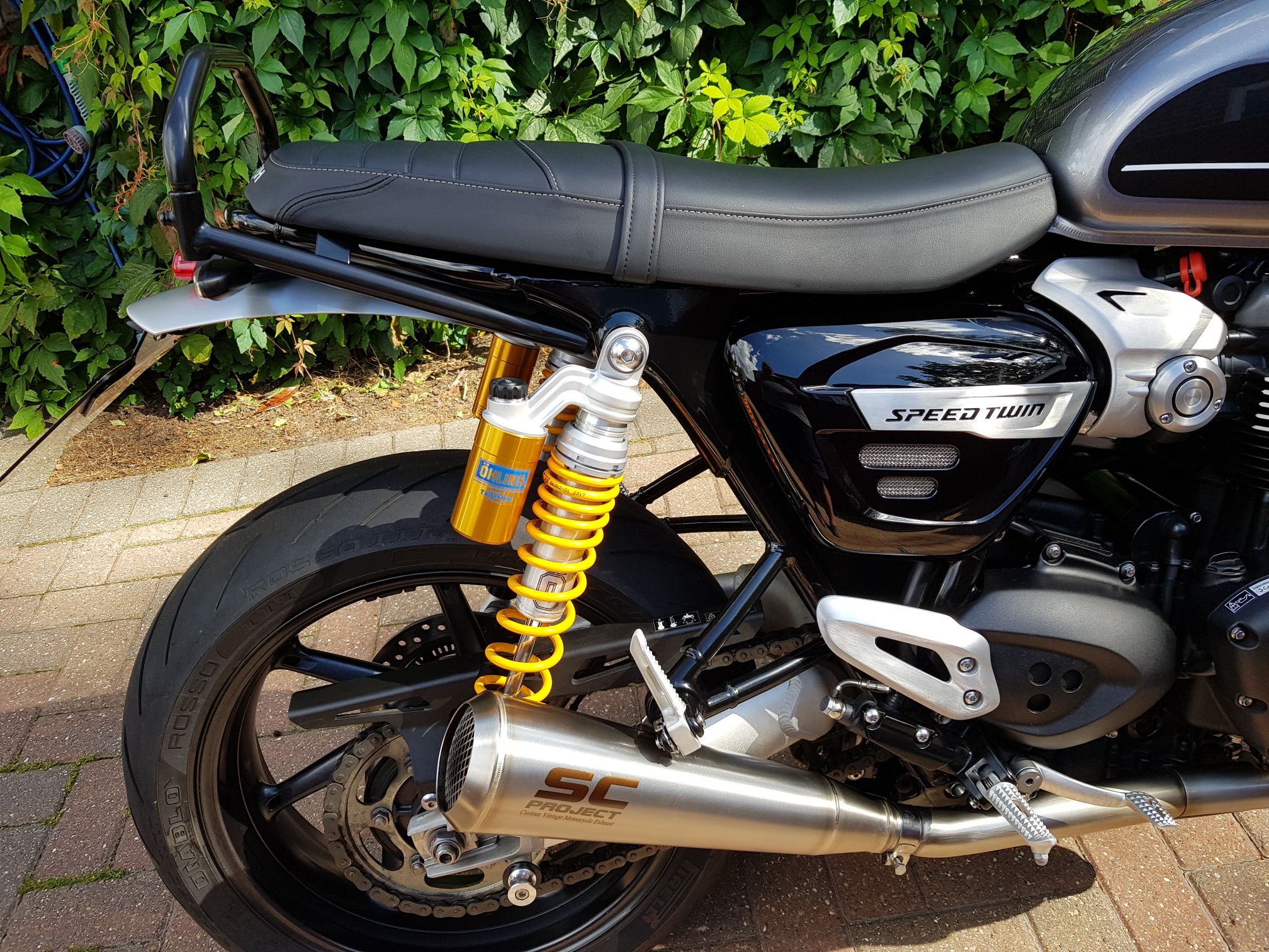

    I have just fitted some Thruxton R Ohlins Rear shocks to my Speed Twin.
    picked them up on Fleabay at a decent price.
    Fitted straight with no problems.
    Any Suggestions on settings anyone ?
    i haven't been out for a decent ride yet but it seems to rides much better.
    i guess it would look better with black springs.
    cheers Ady

    Put them back to standard ( Thruxton) settings. I cant imagine much real difference, Set preload to your weight maybe.

    i have set just a little softer than standard at present , will have a play about :)

    Nice one i had a good ride out today , the bike is so much better , going out two up tomorrow so lets see what its like. I am now on standard settings.
    Next to sort the front end out

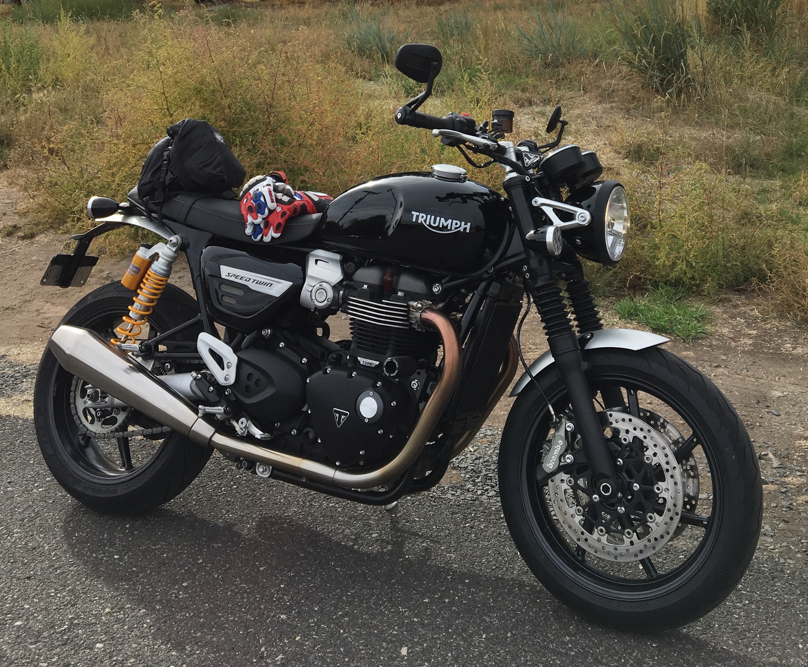

  15. Jet City
    Jet City Noble Member
    Sep 24, 2018
    528
    343
    Seattle, Washington USA
    Ohlins rear shocks obtained and installed!
    I’ve set them up for “comfort” (20 clicks compression, 40 clicks rebound) and the least amount of preload.
    I weigh about 160 lb; ride is much better than stock with this setup. Even a hack like me can feel it.
    And there’s a nice splash of yellow color on the black bike.

    Can you tell me if you used the nuts and bolts from the original shock or any additional hardware please? I’ve just bought a set from an 2018 thruxton so waiting on them to be delivered
  18. adrian knight
    adrian knight Well-Known Member
    Jul 8, 2019
    76
    HAMPSHIRE
    Yes a straight fit using all the original fasteners, a fairly easy task
