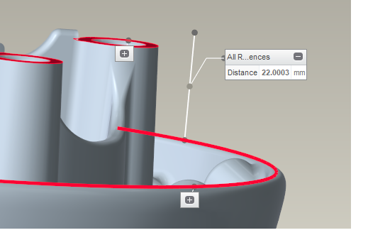

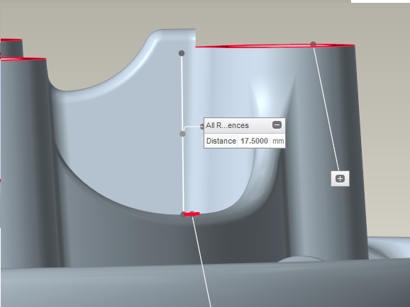

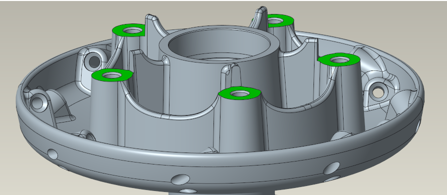

    Lessaint - not sure if you'll see this, but I wanted to ask, once you'd machined the meat off the hub, how much thread was left for the disc bolts to engage onto please?
    Or if anyone else has done this - is there enough thread left, or at least material left to drill and tap into to do this?

    Looks like the counterbores for the brake disc bolt holes also needed to be machined lower at the same time
    Quite a job this
    I have a Thruxton wheel on the way - hopefully my machinist will be happy to do the job on the hub. Thankfully I have to strip the wheel to have it powdercoated anyway
