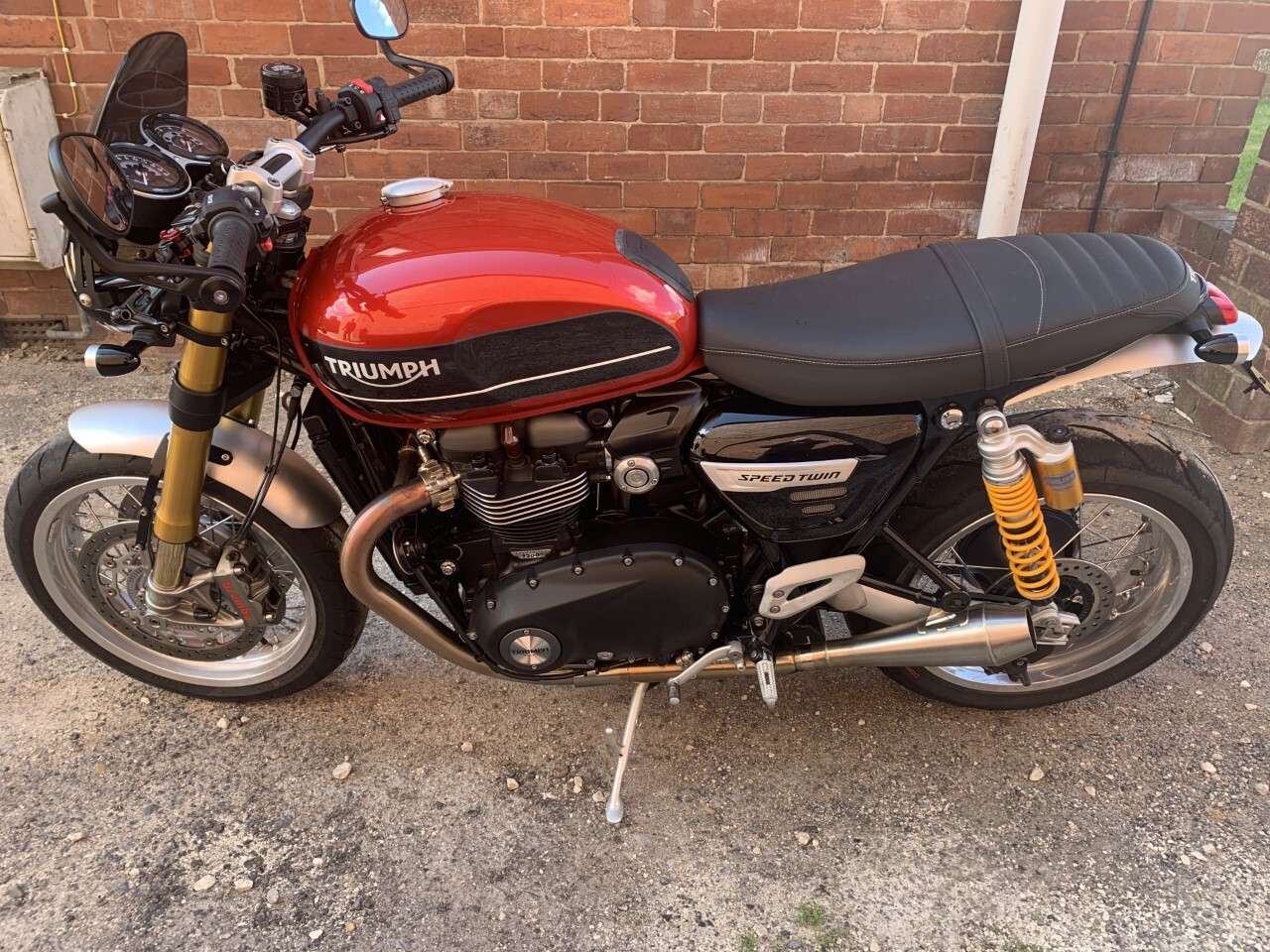

    That is a REALLY nice blend of subtle engineering and aesthetic modification of a nice bike. Nicely thought out, well executed and very well presented. Kudos to you, Sir.
    As a purely personal preference, I'd have blacked the headlight mounting brackets to match the clamps to the stanchions. Nitpicking, I know, when everything else is SO nice!

    Adie, i will be blacking out as much as i can, after i have set her up (Ohlin's)

    Seriously, it was just a personal opinion/observation. It's YOUR bike and what you have done is outstanding. However, I'll look forward to seeing some more pictures (try taking some from lower shot angles, please :)) when it's finished!

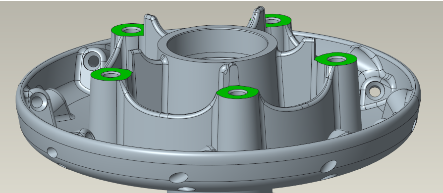

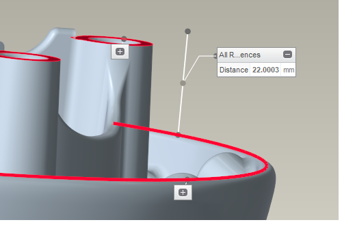

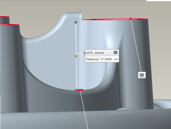

    Can I ask, How did you find out how much to take off, did you measure the wheels and compare or measure the twin wheel and the gap?
  5. Lessaint
    Lessaint Noble Member
    Jan 14, 2019
    436
    313
    Sherwood Forest North Notts
    I measured both set ups from outside of the brake discs Speed Triple R 128mm and the speed Twin 132mm so i bought a set of spoked wheels and removed 7mm from each side of the hubs/disc mounts

    The red highlighted surface is OEM and the green highlighted surface is after 7mm has been machined off the hub discs mounts, allowing me to fit the spokes to the Speed Twin

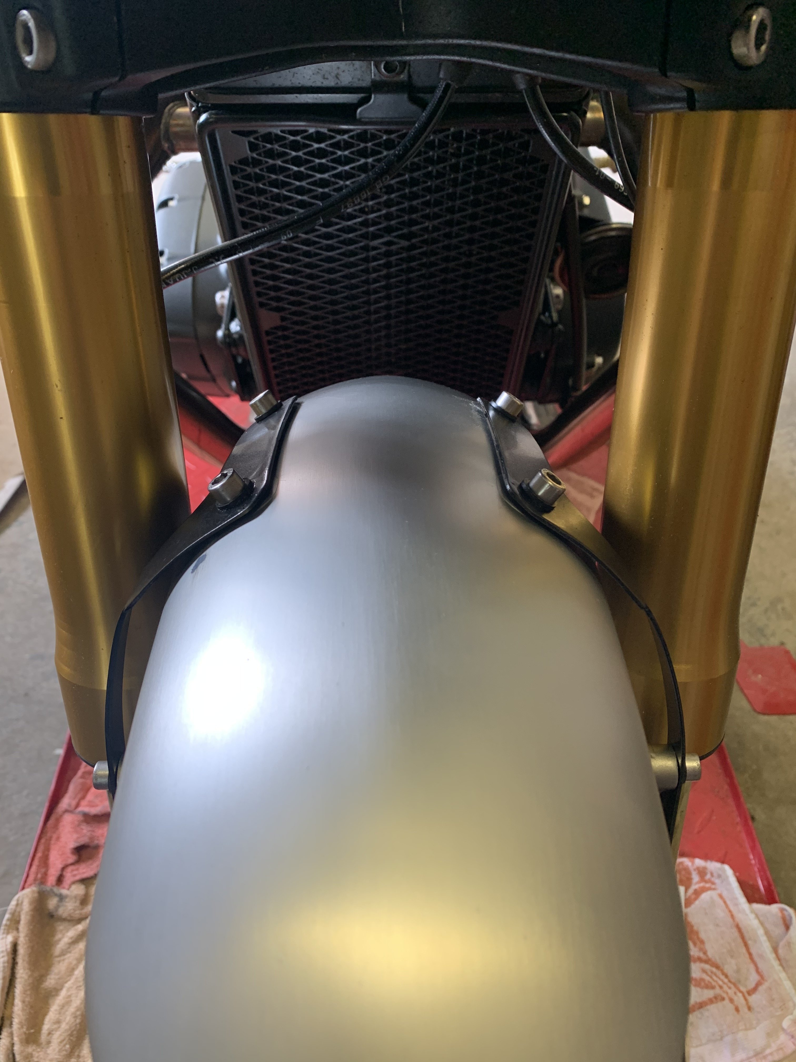

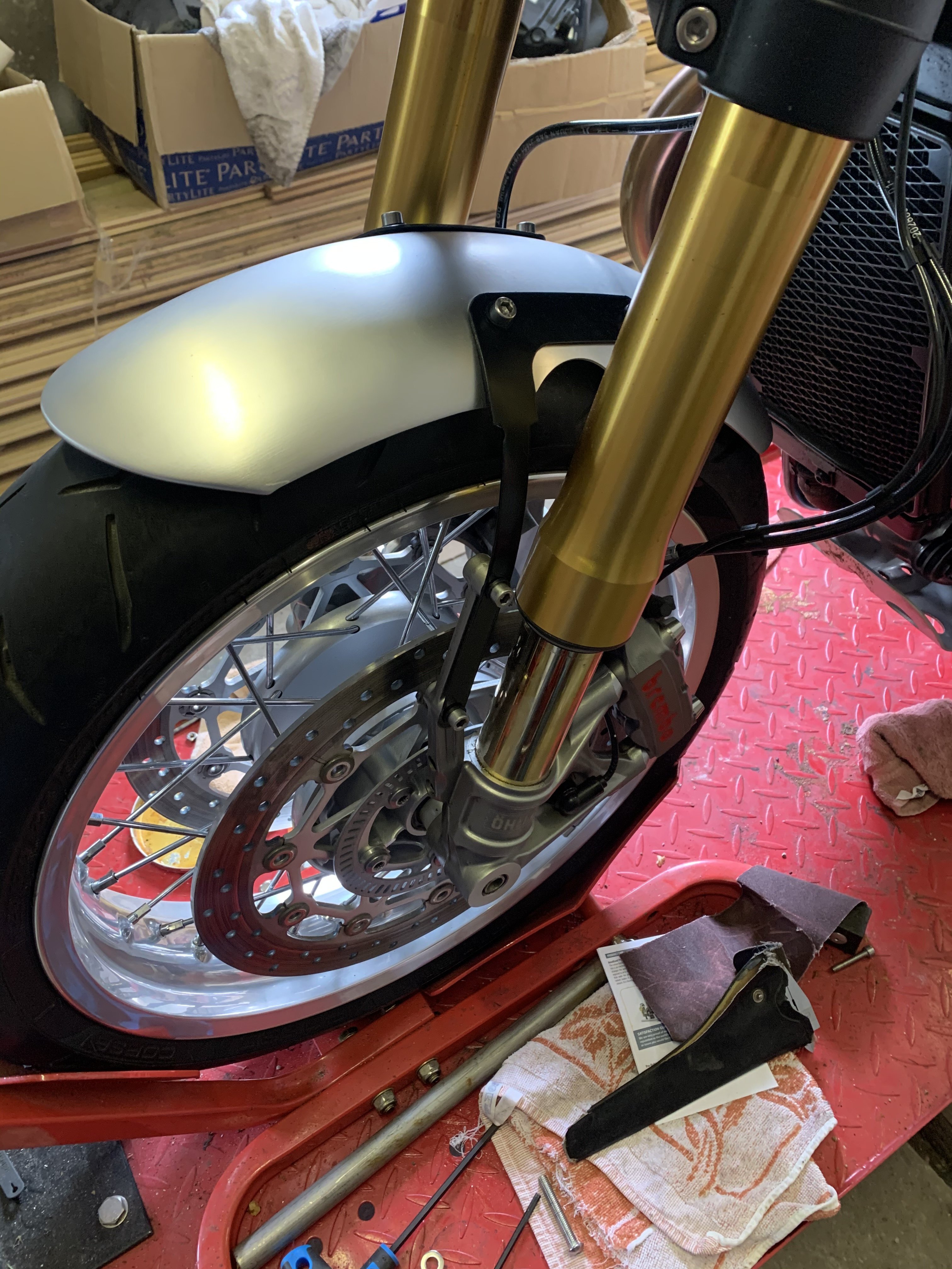

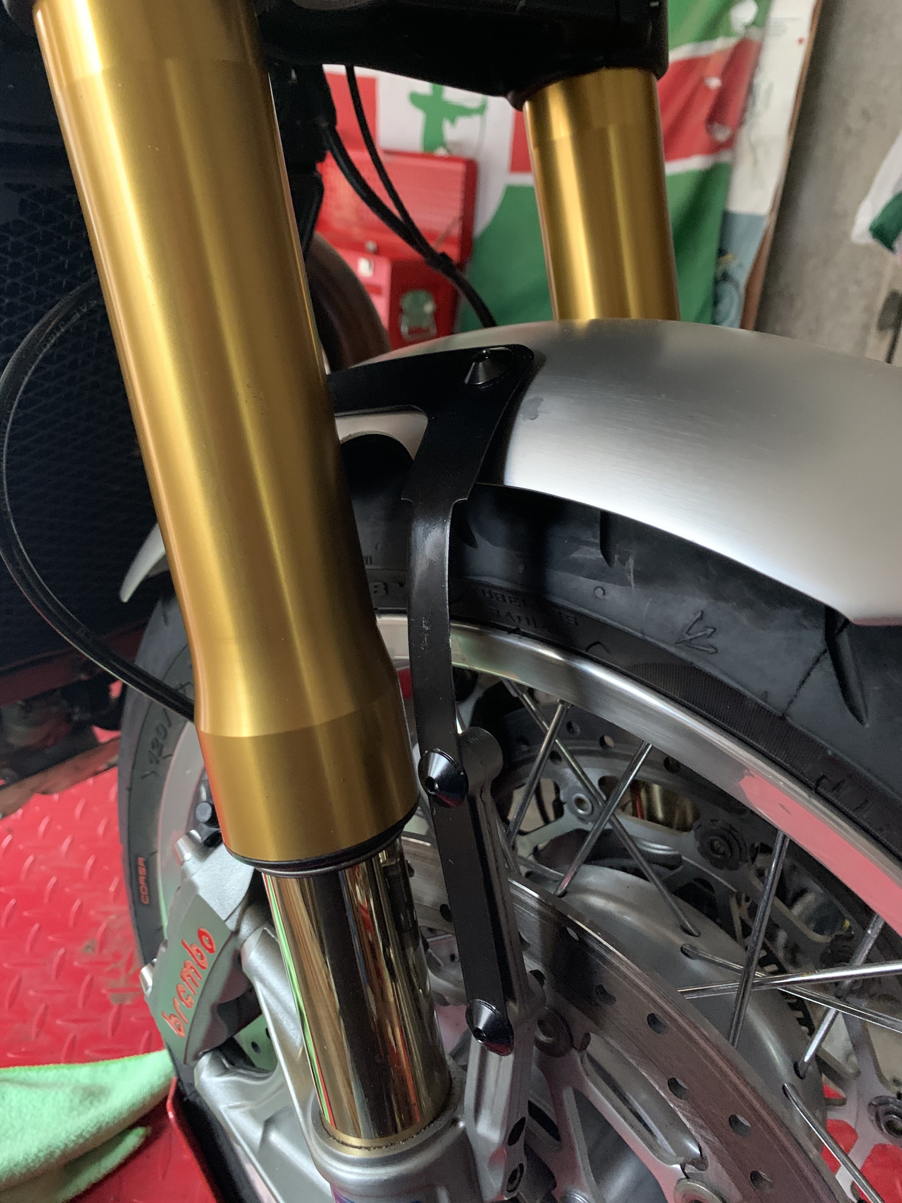

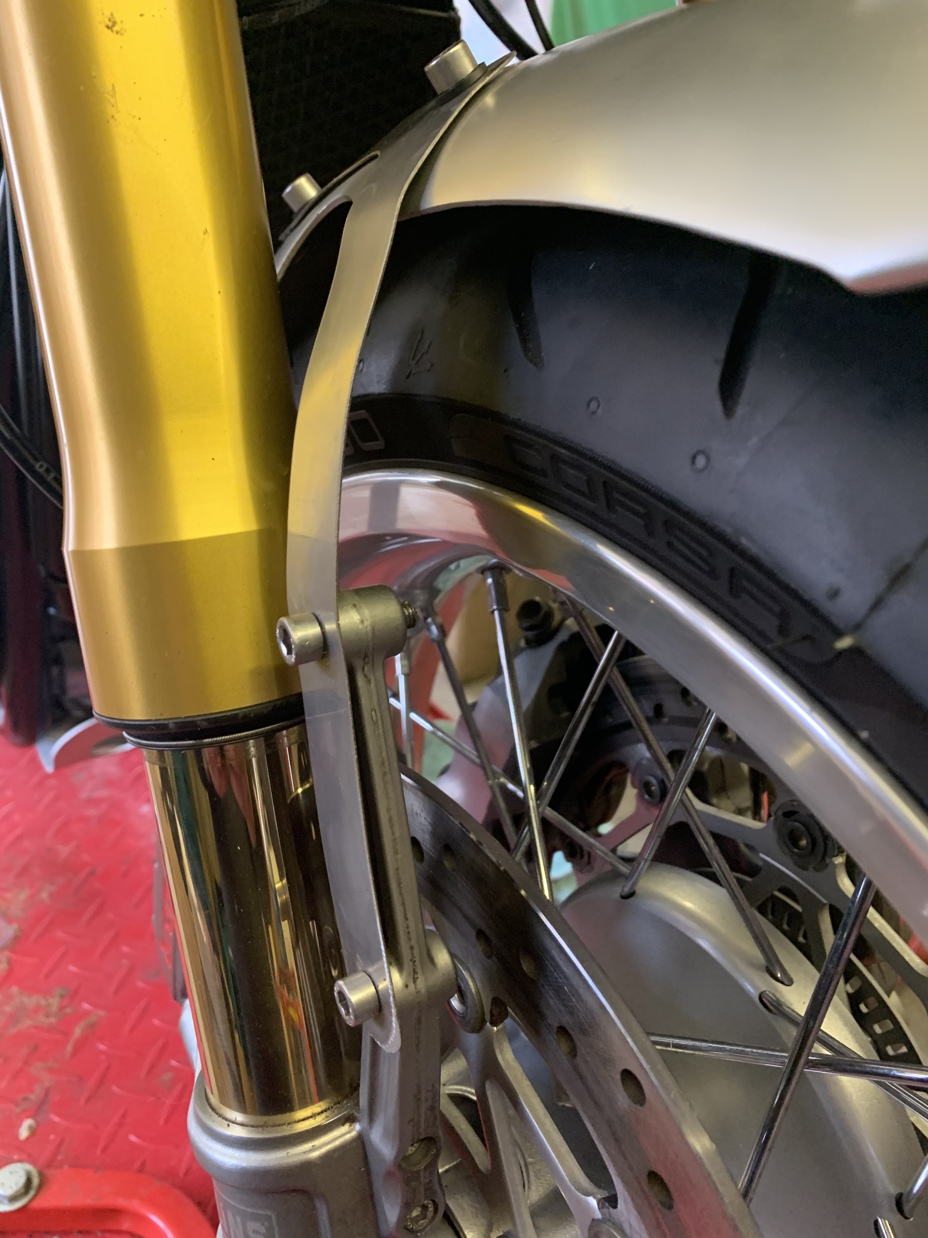

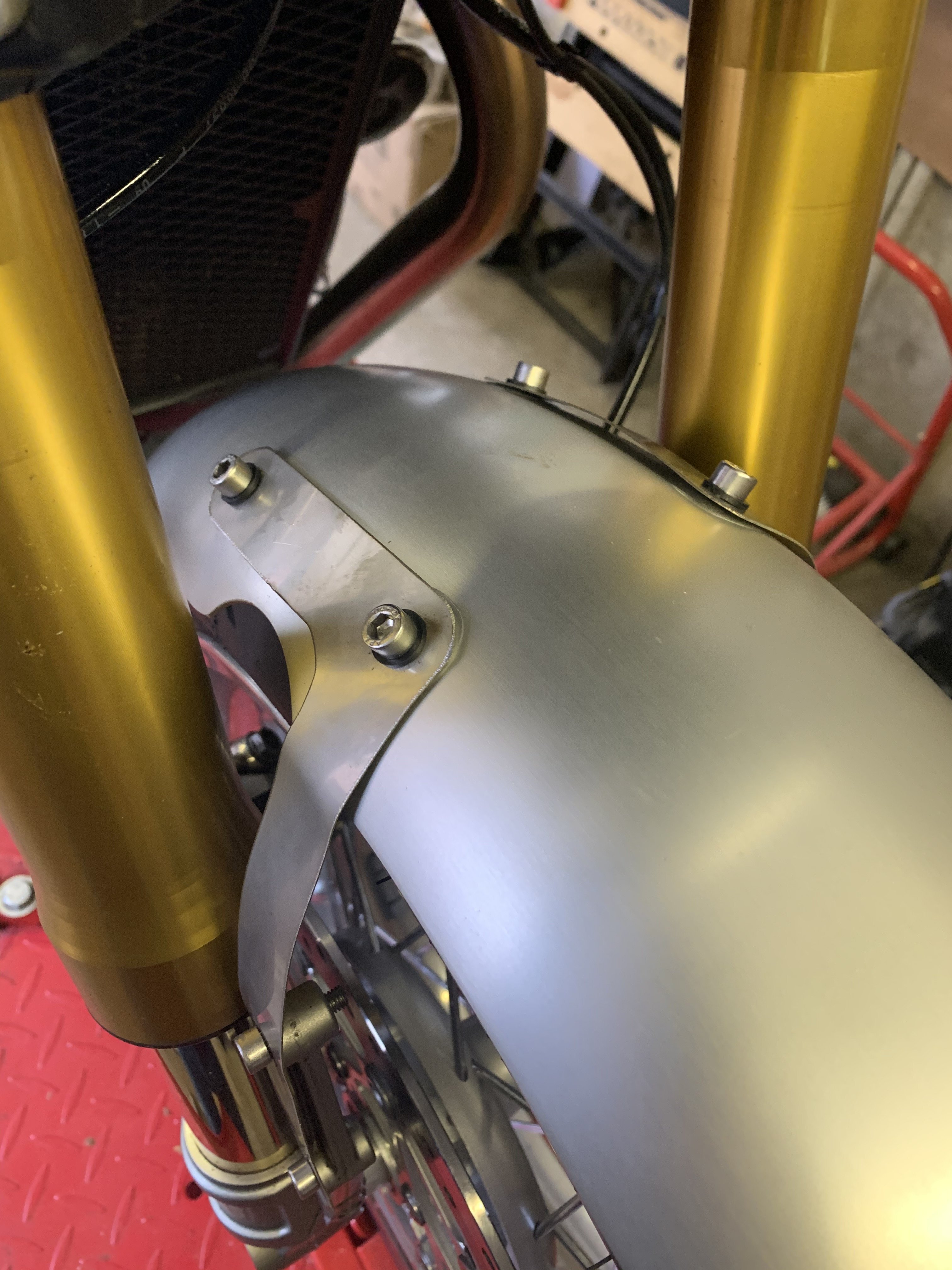

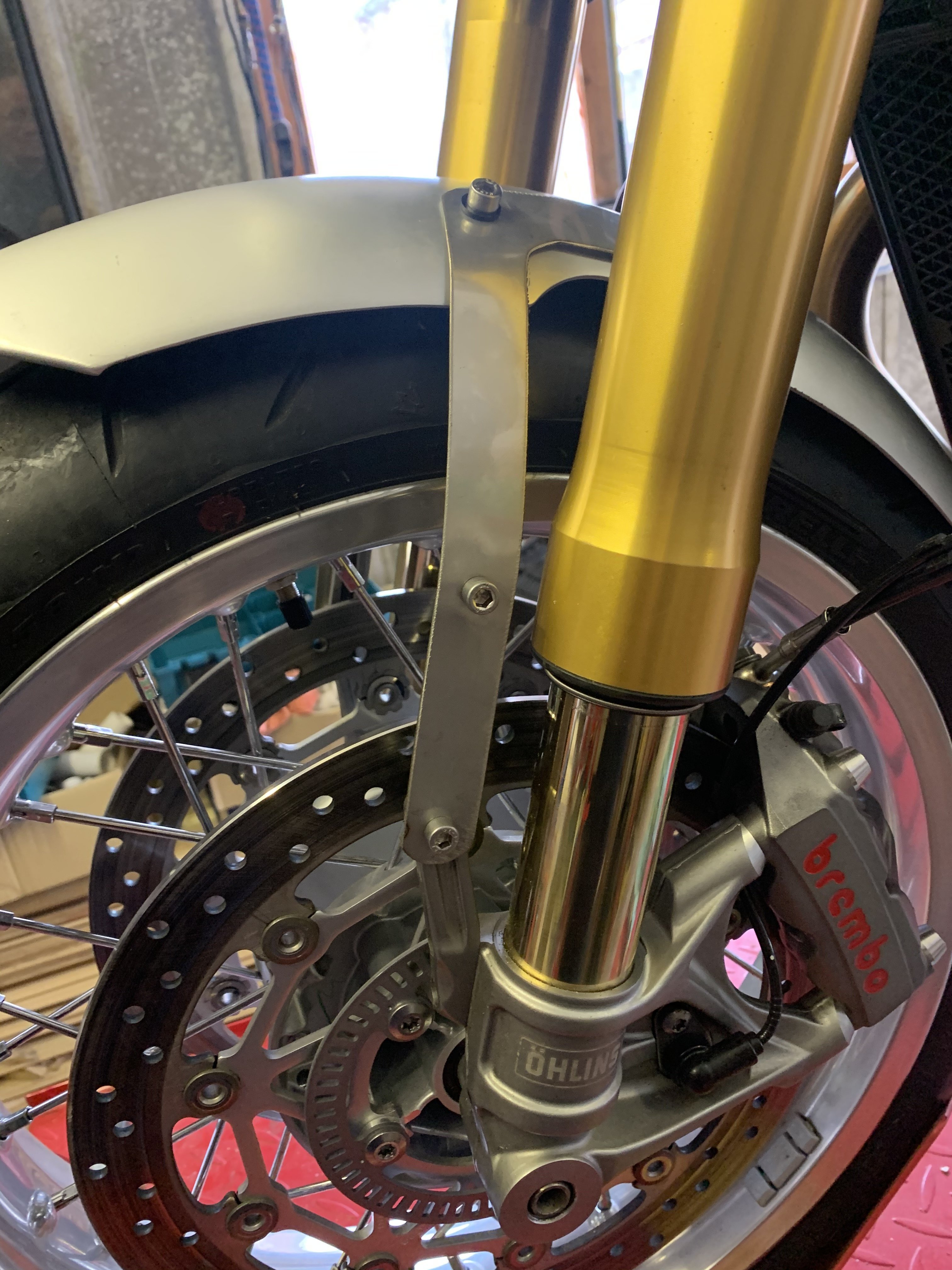

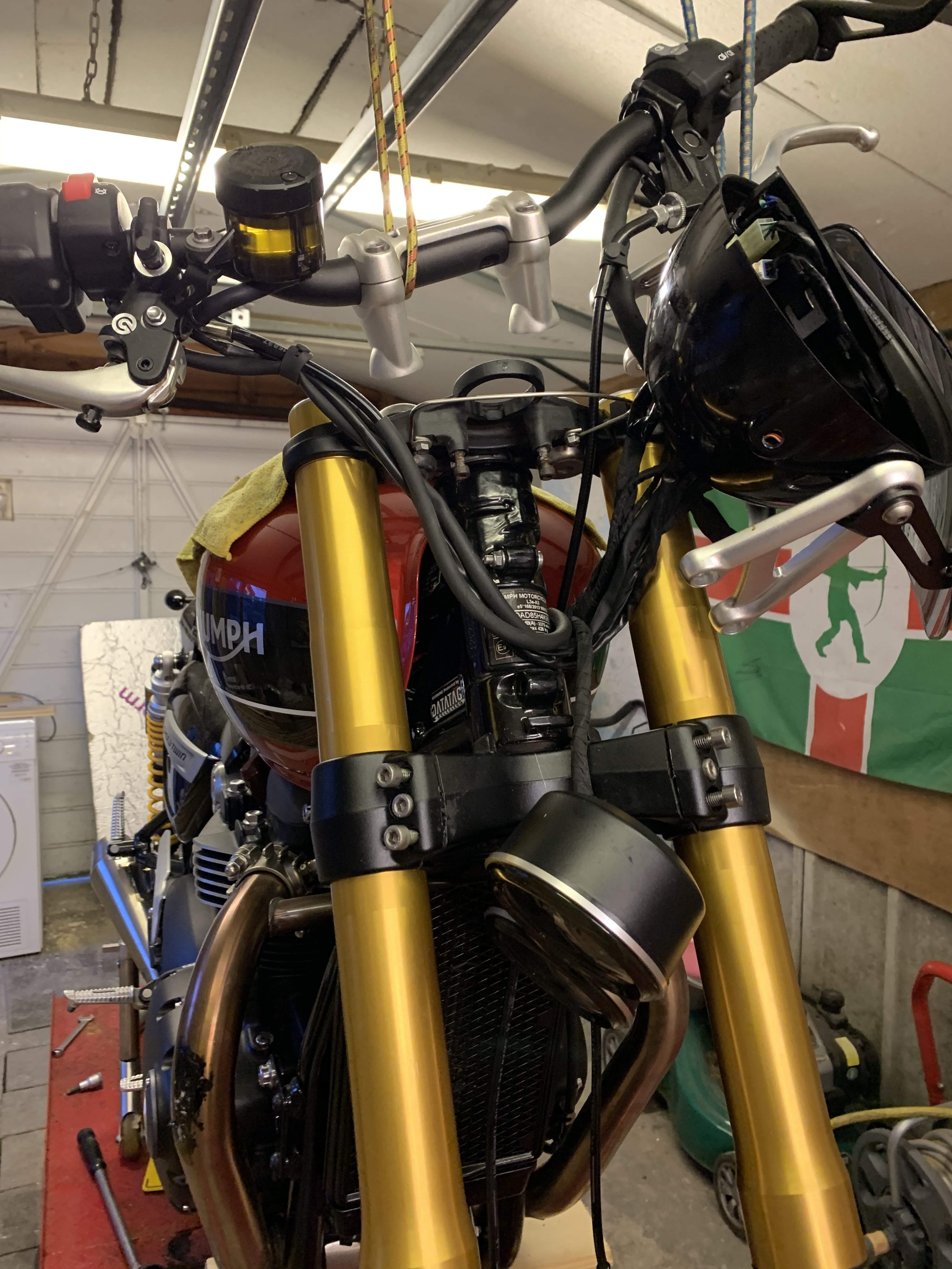

    A limited number of lads have started back at the company were i work, including lads in the engineering/machine shop, so i had a couple of front mudguard brackets on the plasma in 0.7mm 304 matt finish stainless steel, to try them on the bike, just a couple of alterations ie; rotate the lateral centre line on the bracket were it attaches to the mudguard by +2mm, and close the mounting holes by 1 mm
    I think i will paint them black along with the headlight brackets
  11. Lessaint
    Jan 14, 2019
    436
    313

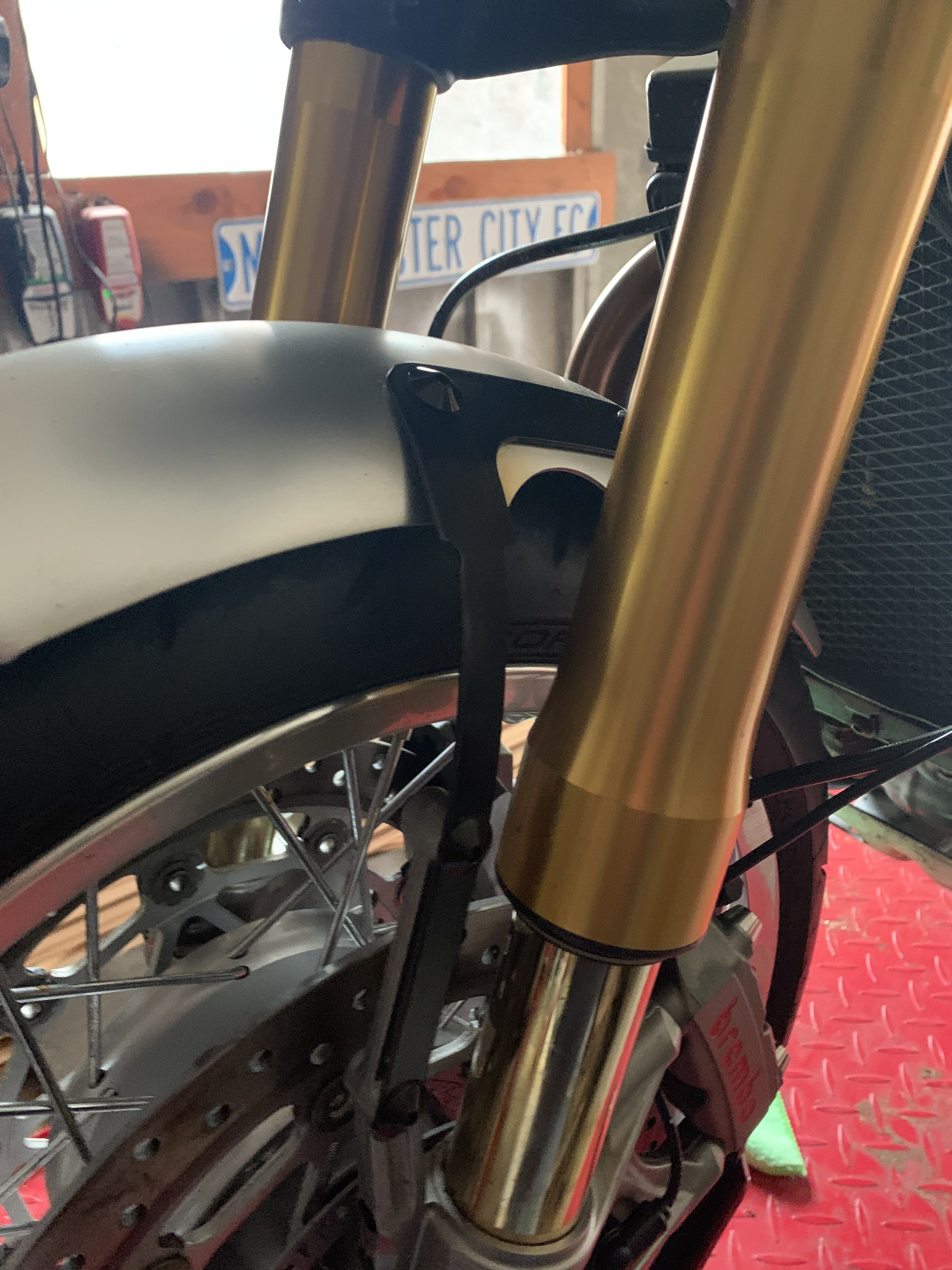

    Decided to go with black, the headlight brackets next
  12. SprinterII
    SprinterII Noble Member
    Mar 27, 2020
    642
    Scotland
    Quality result.

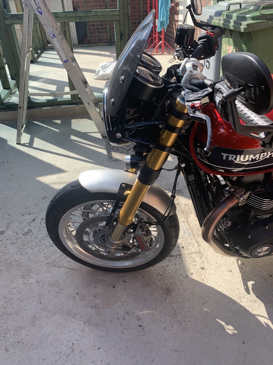

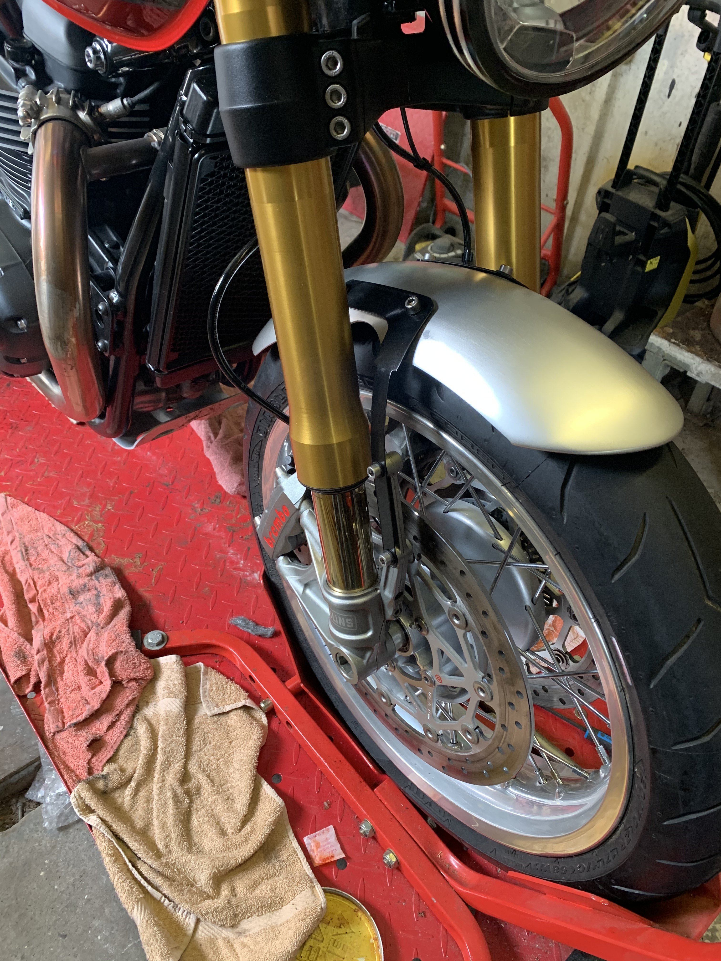

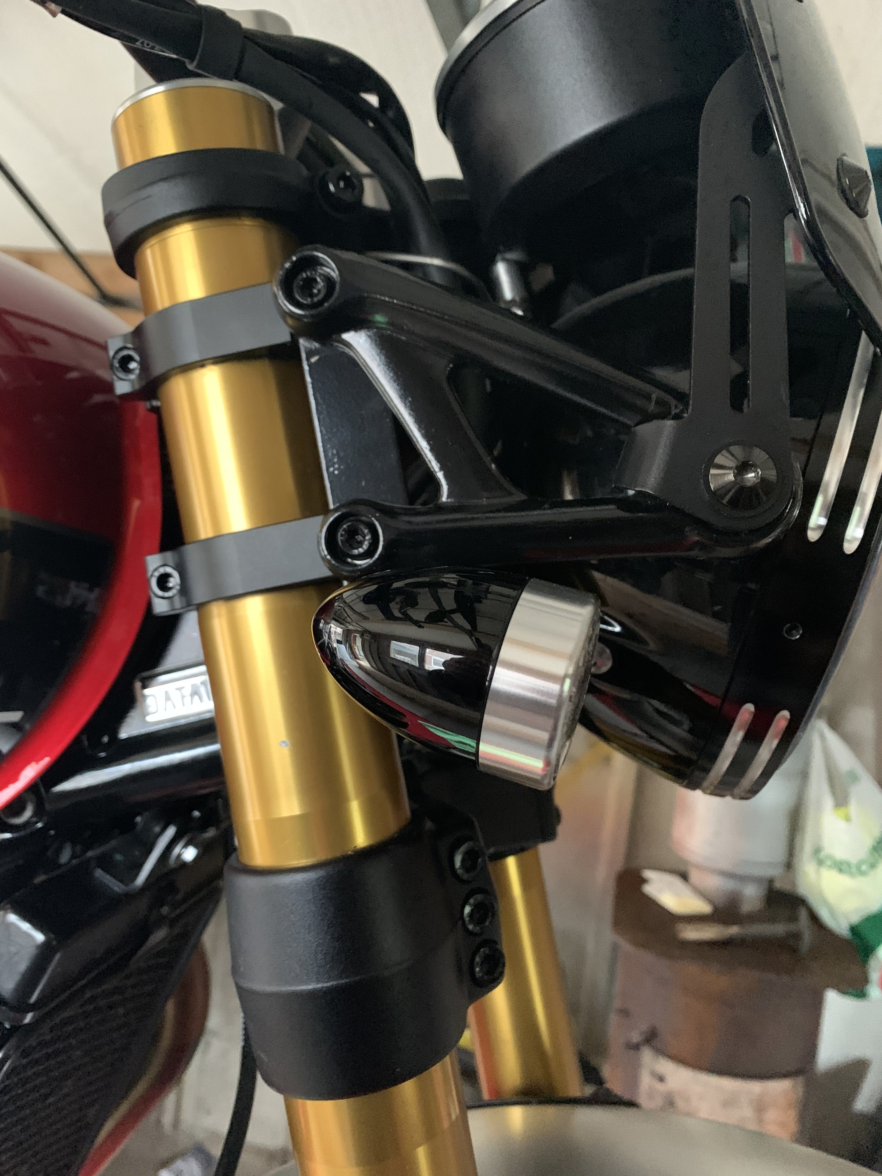

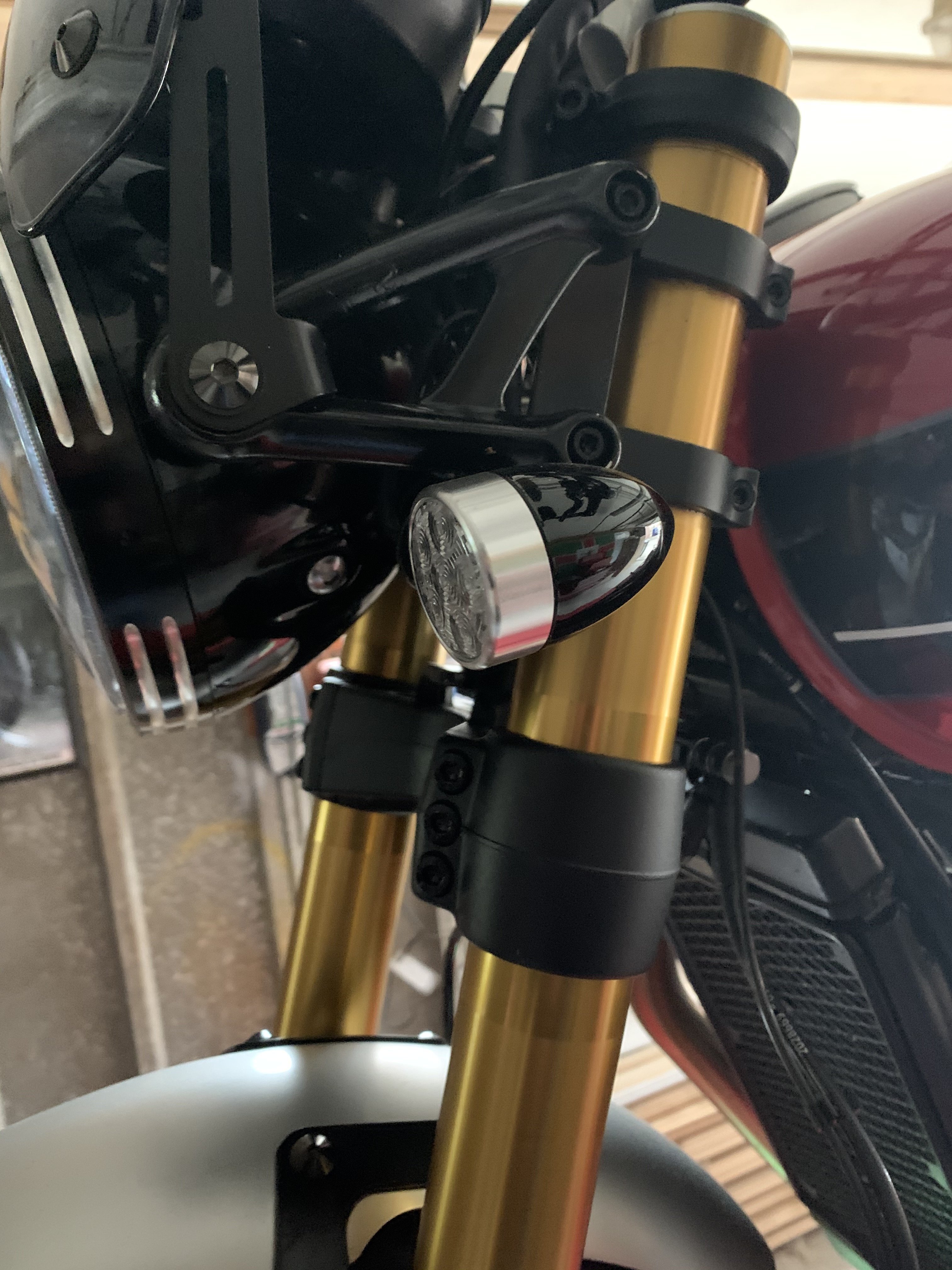

    Got the headlight brackets sorted, just waiting for the black bolts/studs

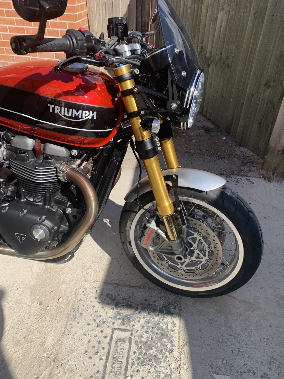

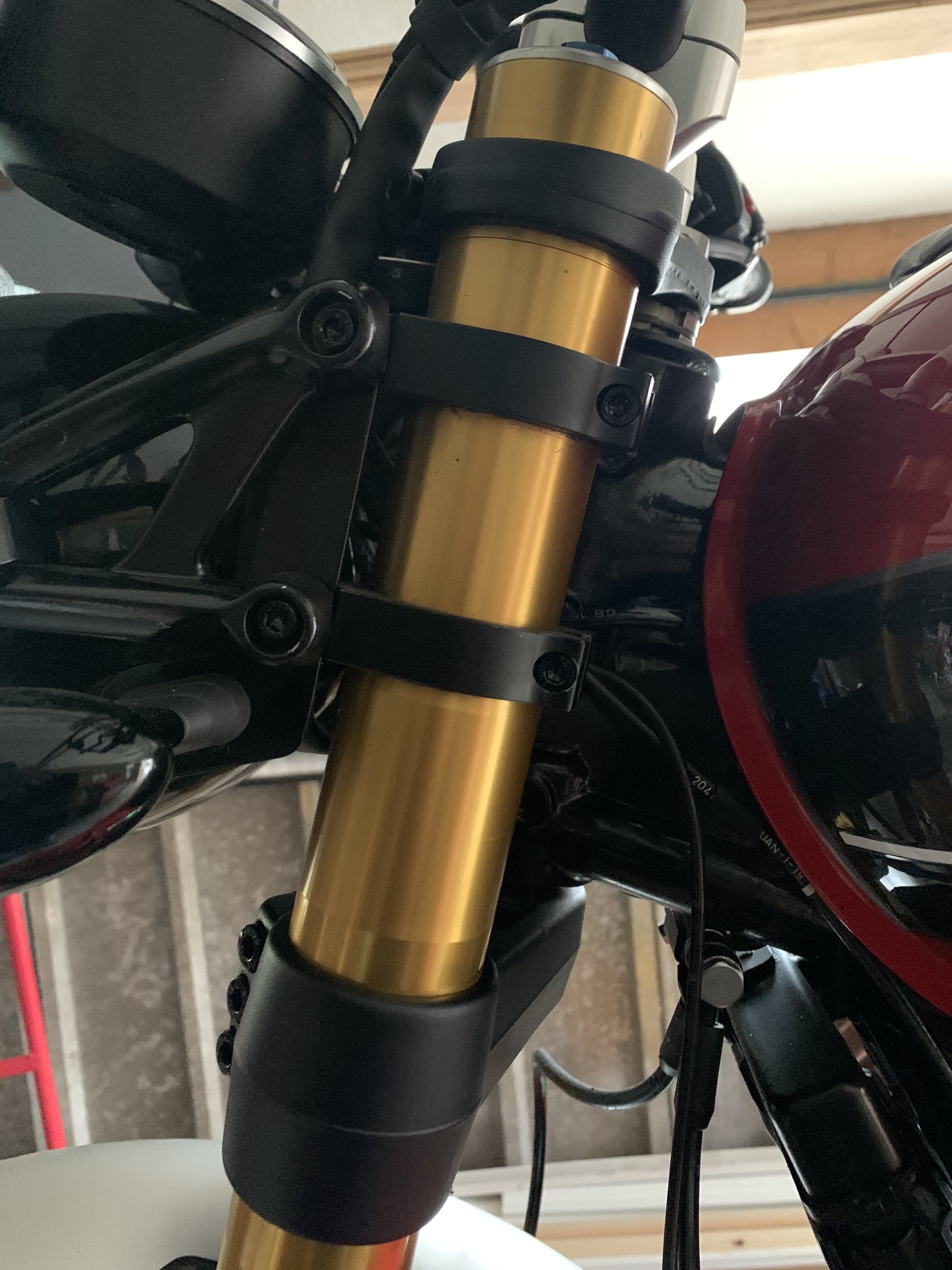

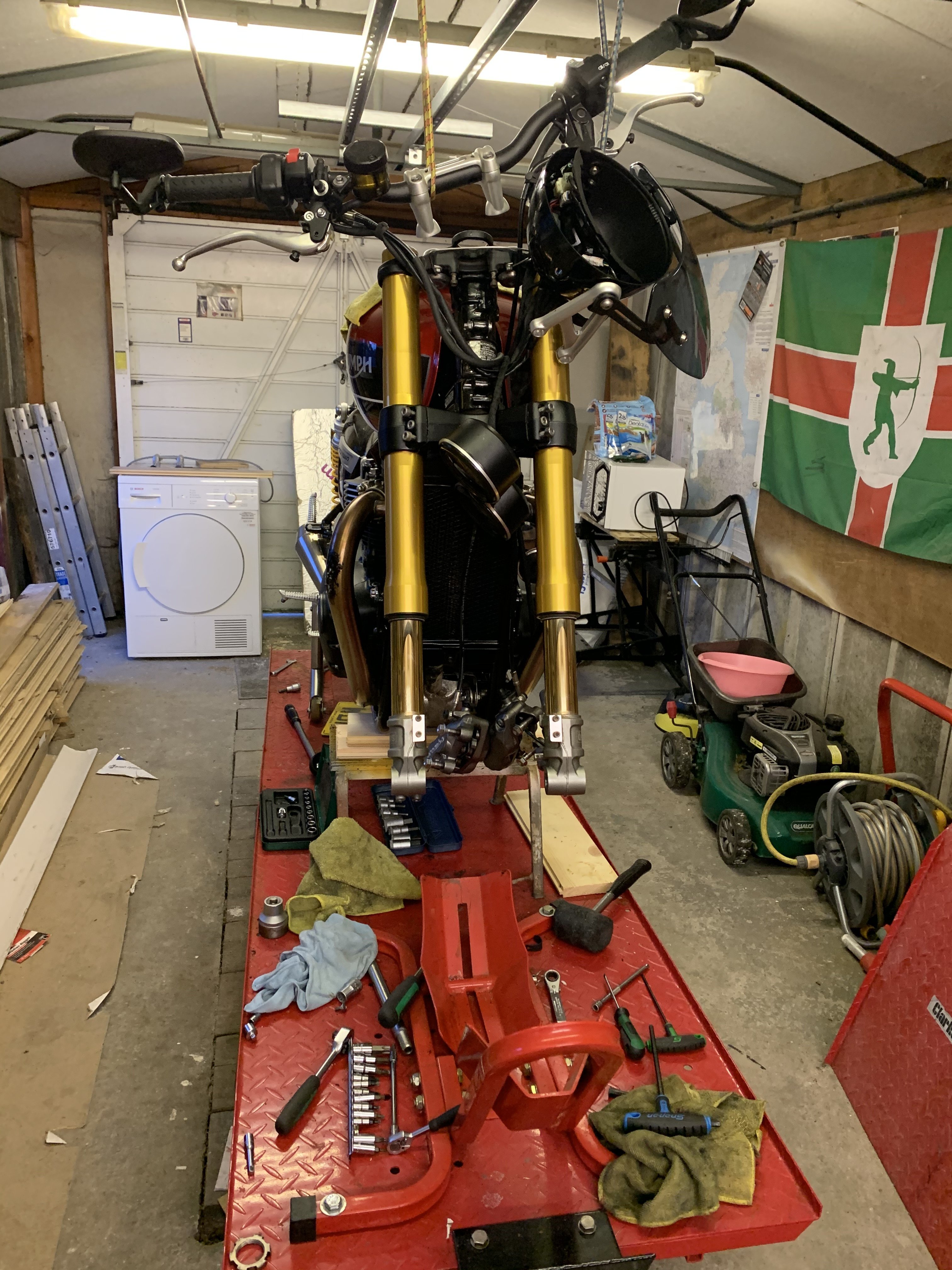

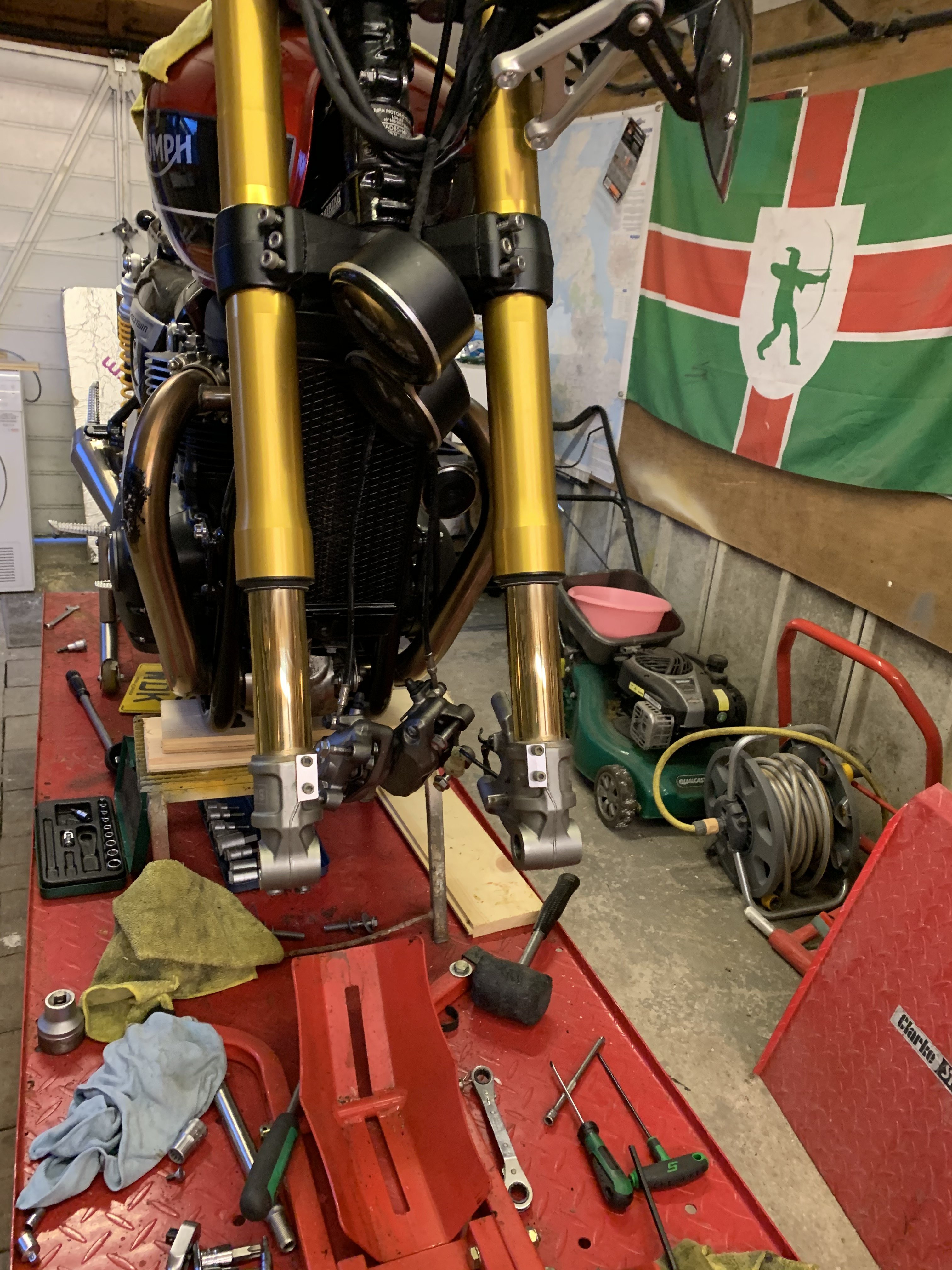

    i have carried out further works to my Bonnie, i have continued with the blackification of the Ohlins front end.
