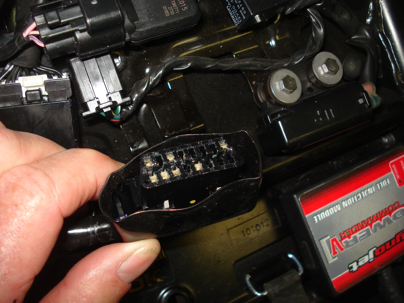

    that's the diagnostic socket.

    okay Guys thanks fixed it.
    As i could not unplug the power commender, i fiddled a little with the connections and voila.
    I am not handy like most of you Guys but like to work on it non the less.
    I cant beleave it at the same moment i fixed it, Lingard scored ha ha not superstitious but still.

    That is where Triumph dealers plug in their Data Logger Tool, you can use Tuneecu via this to change ecu setting's and fuel/ignition mapping etc.

    Okay thanks bro did not know, i am in heaven now drive the bastard again.

    Looks like the data link 16 pin socket for diagnostic checks, shouldn't be attached to anything

    Correct terminology is an OBD port.
    "On Board Diagnostics port."
    Basically it is door into the bikes ECU (Electronic Control Unit) or brain, useful for change parameters in the engines running, checking clearing faults etc!
    Also useful for the dealer to plug a laptop into, and fleecing you for lots of ££££££'s............ claiming its a black art, and only they can do it!
