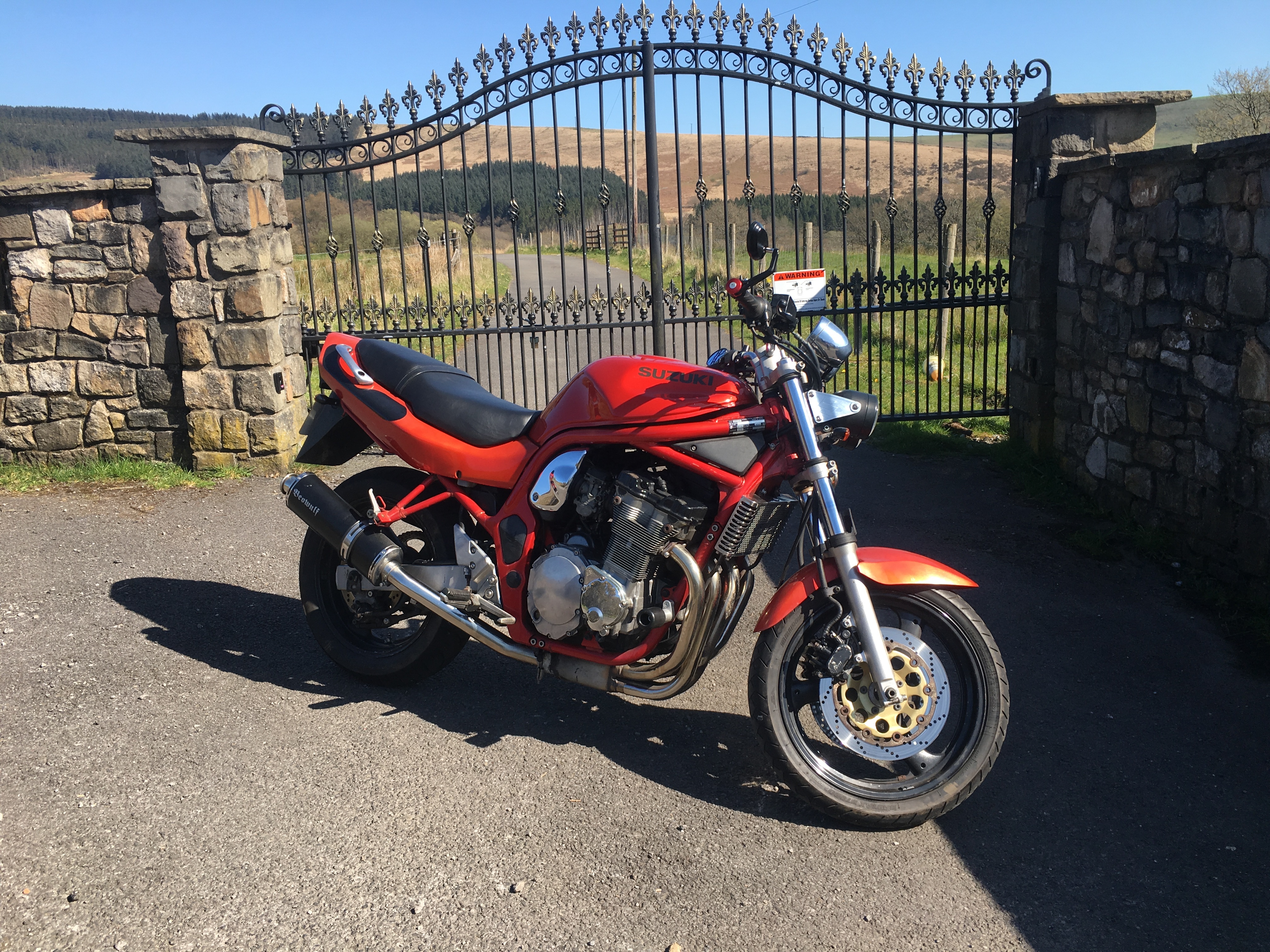

    This morning I decided to refit the exhaust so it’s straight!!! Then I removed the fork caps with the bike jacked up to take the pressure off the forks, to expose these.....(whilst it was off I stuck in about 25ml of oil to each fork).
    Then I dug out an old pair of preload caps which were given to me some time ago, I think from a Fazer 600???
    I spoke to my tame machinist (Darren :D) after doing some measuring and asked him to make me 2 x spacers 36mmOD x 12mm thick with a 10mm x 2.5mm dimple to take the adjuster and keep things central.
    Which look like this.
    And after a bit of swearing trying to squeeze it all together they look like this
    And the bike is now back in its wheels and feels a little firmer with 3 notches of preload in the rear and the rebound adjusted for a bit more return in the rear which also means that with the adjusters I can now dial in a further 17mm on the front if required.
    The RH rear indicator wasn’t working which was just a poor contact on the lamp and I need a new switch for the front brake lever then it can go for its mot.

    Well, I bit the bullet and stuck a full set of seals in all three calipers as Robinson’s Suzuki had them on offer anyway and I stuck a new set of NGK plugs in her. I took it for its first MOT since 2011 yesterday and it passed with no advisories and a few positive comments from the tester. It goes surprisingly well.
    Anyone want a 97 Bandit for £1150?
