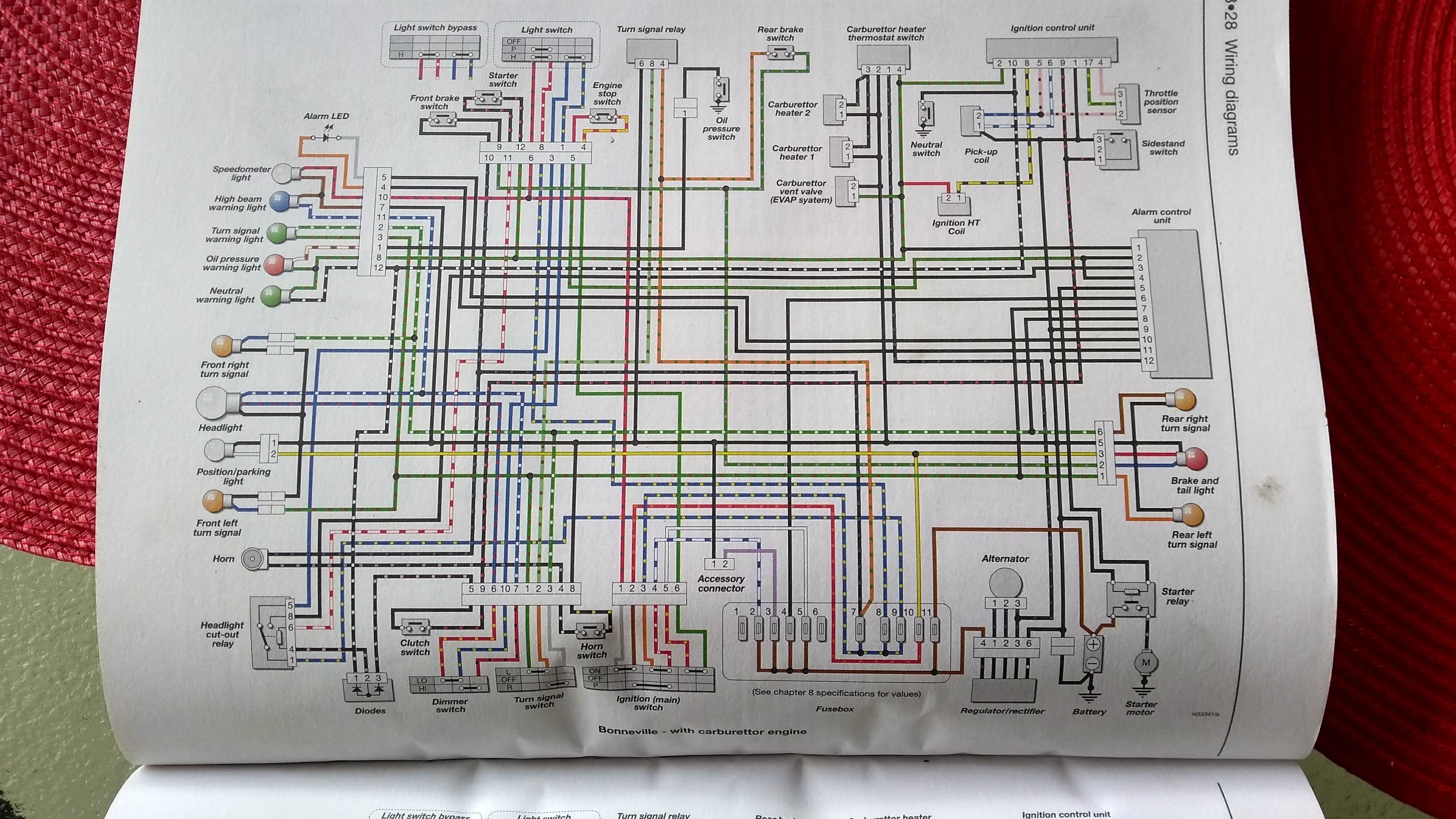

    I am checking for that. I've got a manual and the wiring is a bit hard to follow. Much water fell out of the plastic sheathing for the harness when I disconnected everything. I've taken the plugs apart (again) and hit the plug fronts and backs with WD40 (this should displace and remaining water). I am an electrical technician by training, but I hate to haul out the VOM and trace the wires if I don't have to. I think that the neutral switch might be a good place to check, but I do not know why I do not have a glowing oil pressure indicator light when I turn on the ignition.

    Looks like I will have to pull out the VOM. Both the oil pressure light and the neutral indicator get their 12V from the Alarm Control Unit or the Ignition control unit. They are probably under the seat or a side panel. I'll let you know what I find out. Grrr. The weather was great for riding today, that'll teach me to start replacing parts without a clear path to getting on the road again.

    I'm getting closer. At the bottom center of the wiring diagram you can see the ignition switch. It makes three connections when on. My problem is that none of the circuits energized by the rightmost connection are working with the ignition on. Everything on the other two connections made by the key switch -- parking & brake light, etc. -- is okay. The 12V for the right most connection passes through a 15A fuse -- the fuse checks okay with a VOM. I have to dig further.

    Can you access the ignition switch connector if so check for voltage at pin 5 ( power from fuse 5 ) and pin 6 power out to kill switch

    But I don't know how I fixed it. I checked for 12V power going to and through the ignition key switch contacts to the circuit that was failing, then I disconnected all the harnesses in the headlight shell. I then figured out which connector was which on the wiring diagram, and reconnected them, one at a time, basically building my missing circuit step by step. I reached the point of the last connection up to the dash (still checking for power & ground on the failed oil light pressure indicator), and found that I had 12V and ground going to the oil pressure light. I thought something must have pulled loose on the cable going into the dash. So I hooked up the dash to its connector, and, voila, a miracle, it worked. Everything worked. The bike started and ran perfectly (bad memories of Lucas electrics overwhelmed me).
    I think that in the process of disconnecting, cleaning, and reseating the connectors inside the headlight shell I must have eliminated a short caused by the water that had collected inside the plastic sheathing of the cables. Or maybe magic? "Merlin, Merlin, hear my plea! Make my motorcycle go for me!"
