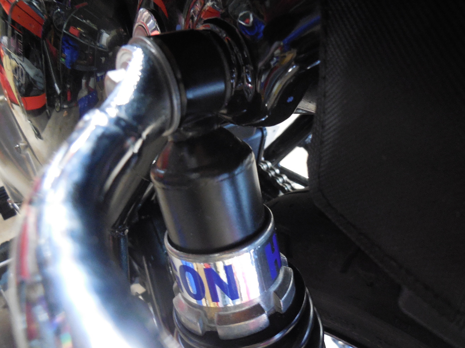

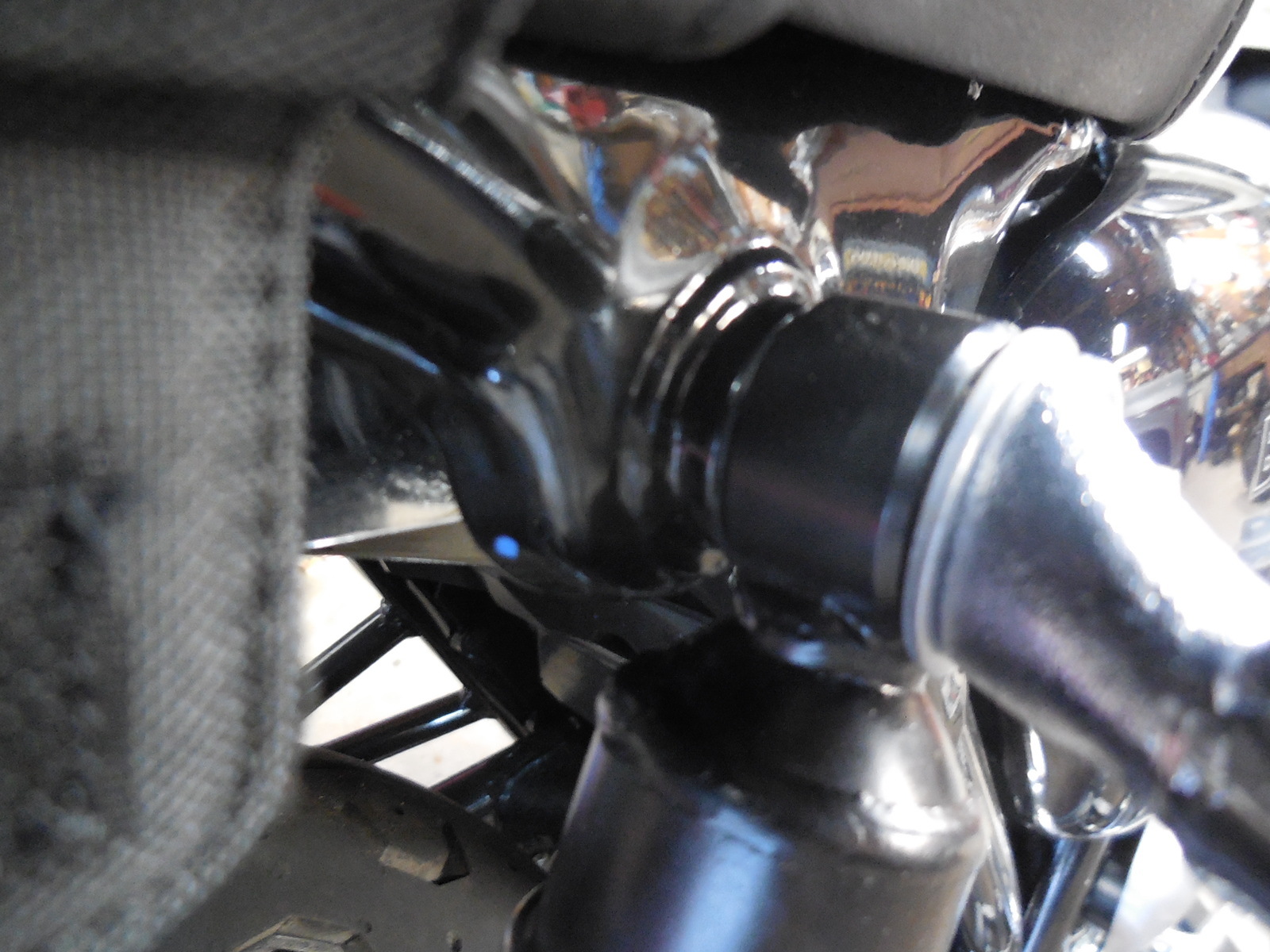

    Well there's news, I have the shocks back on the back now. The clearance is probably on the economical side of generous, see what you think:
    I'd put it at about 2mm. I think that with minimal rotation around the lug as the swingarm moves it might be OK. I need to go back into the garage and disconnect the bottom fixing and rotate the shock through a few degrees either way and observe clearance.
    I'm also curious about how they've achieved this. I think they have sourced an alternative top section which they've simply fitted to the shock body. I'm not sure what may have changed regarding the dimensions in doing this.
    When you look at the before and after photo's you can see key differences. When I lay the OE shocks next to a Nitron it's obvious that the Nitron are around 10mm shorter and the bike is noticeably lower when you sit on it.
    I asked for all settings to be recorded before being worked on so they could be returned me in the same state after SJ set the suspension up with me on the bike, pre-load seems to have been overlooked.
    Before modification there were 22 threads above the adjustment collar, there's now 17. With the apparent differences in mind I'm unclear if I'll be upsetting the pre-load setting to get the ride height back as the bike or whether it'll simply be as was. I've sent a mail but won't see a reply till next week so I thought I'd see what you lot have to say :)
    Before:
    After:

    I'm utterly done in with this. SJ are referring me back to Nitron with this now, I've not even had an apology for fitting parts which clearly didn't fit properly.
    The problem being that the bike felt lower than it was before this work was done and having taken one of the shocks off and comparing it to an original part it looks like this:
    Now in my simple mind I believe that these should at least be of equal length on the floor off the bike. Or am I wrong in thinking this? Nitron have given the following explanation:
    'Shock open length should be 348mm +10-/0 which should be the same as OEM. The end caps were changed from part number 030332 to 030176. End cap 030176 is 11.2mm taller than 030332 so the shocks should have been rebuilt with 10mm shorter body tubes – this is why the distance between the end cap and spring platform is smaller. The installed spring length however should be the same as before modification and for reference the standard installed spring length would be 180mm and preload 20mm. Length adjustment for twin shocks is actually 10mm'
