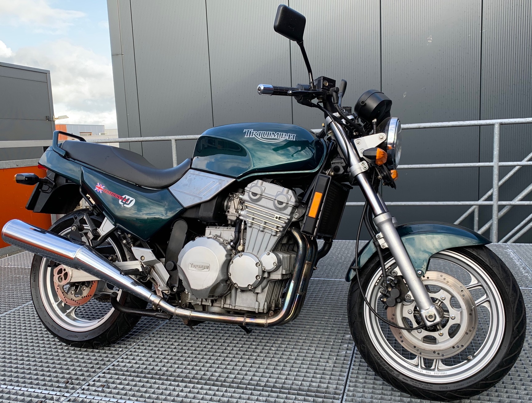

    As promised to keep you all posted about how the Trident is doing after some chemical treatment, here an update.
    I ran two-tank fillings with different chemicals to clean the carbs and jets. After adding Wynn's product I add at the last tank filling Forte 1&2. I must admit the bike runs better than ever before. Occasionally there is sometimes a little hick-up but they are getting less and less. I trust the problems will be over soon. Unfortunately, the fuel consumption is rather high, about 2.6 Gallon (US) on 60 miles. At first, I used only the first 5 gears to get some more revs to clean the engine. During the last tank, I used the 6 gear too but have no fuel consumption measured yet. Let's hope the bike will do some extra miles to the gallon in the future.
    After all the bike runs better and better and I love to ride it.
