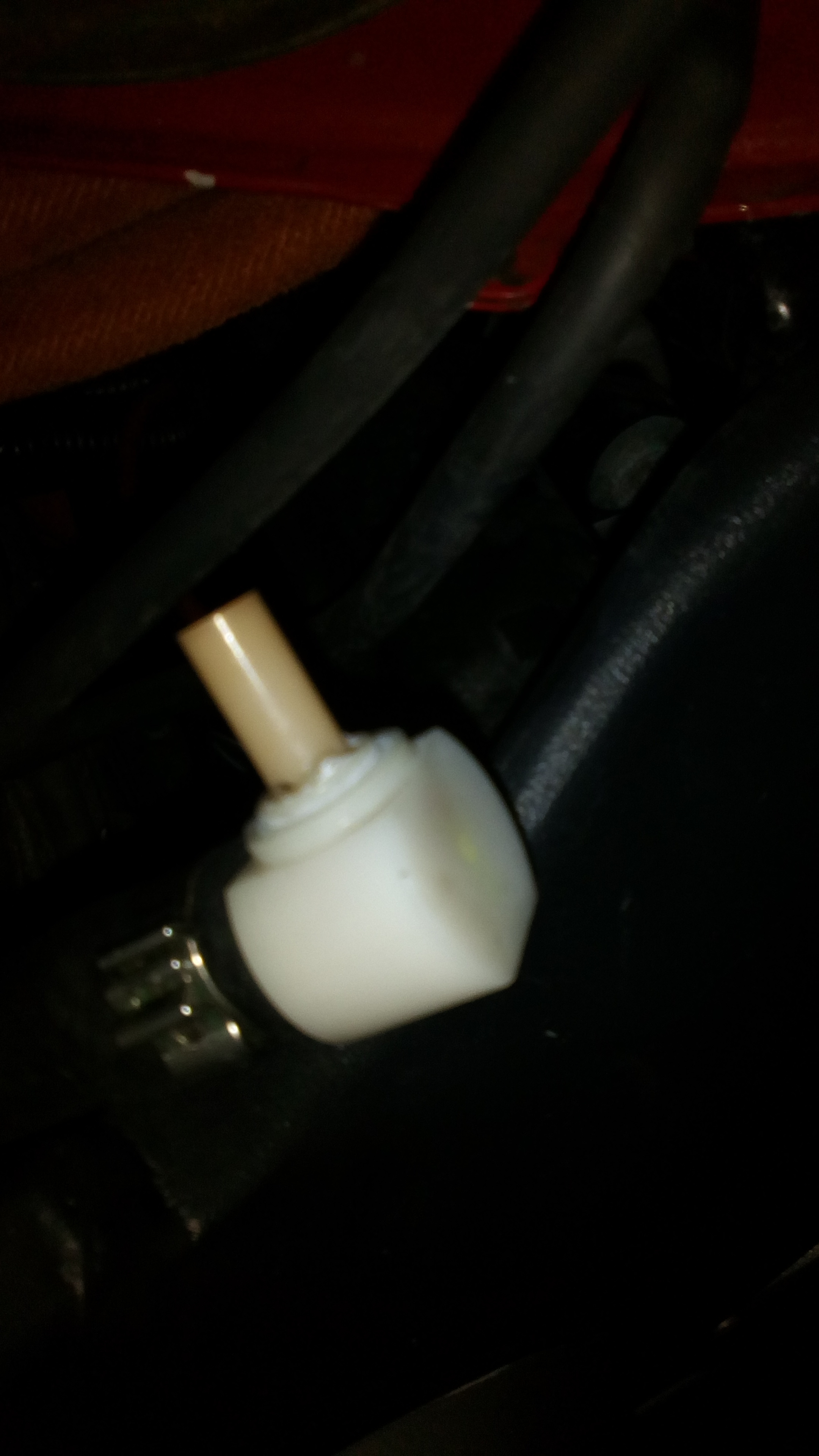

    and it was all going so well , all new plugs , coil stick , filter and oil,relay and rebuild , all done till tank , got the red pipe on ,the two little piupes and th electrical connector with just the white to white fuel feed left and i cannot g et it back in , i have tried and tried and then the little pipe fell off ! so i am left with the white pipe with four feet things and the connector , it just will not go , i have pulled the little silver pin back ,i have turned it but i cannot even see how it fits , help !!!

    It's the fuel connector that won't go in, not the red one, the tank or I assume female part seems OK but the male part on the end of the rubber fuel pipe will not connect, the little pipe seems unattached, the one with four little legs that goes into the tank, it's like something fell off, I am climbing the wall on the this,#shouldhavewenttogaragetightsod

    Under the tank there are two fuel pipes not the vent pipes , in and out, both have connectors that enable tank removal , one has a red spot of paint on and it went back OK, the other one that will not go back has a little bit of plastic pipe that goes into the tank and the connector is similar to the other but the pipe is longer and slimmer, it will not reconnect for some reason, it's too dark to take a photo but I will try

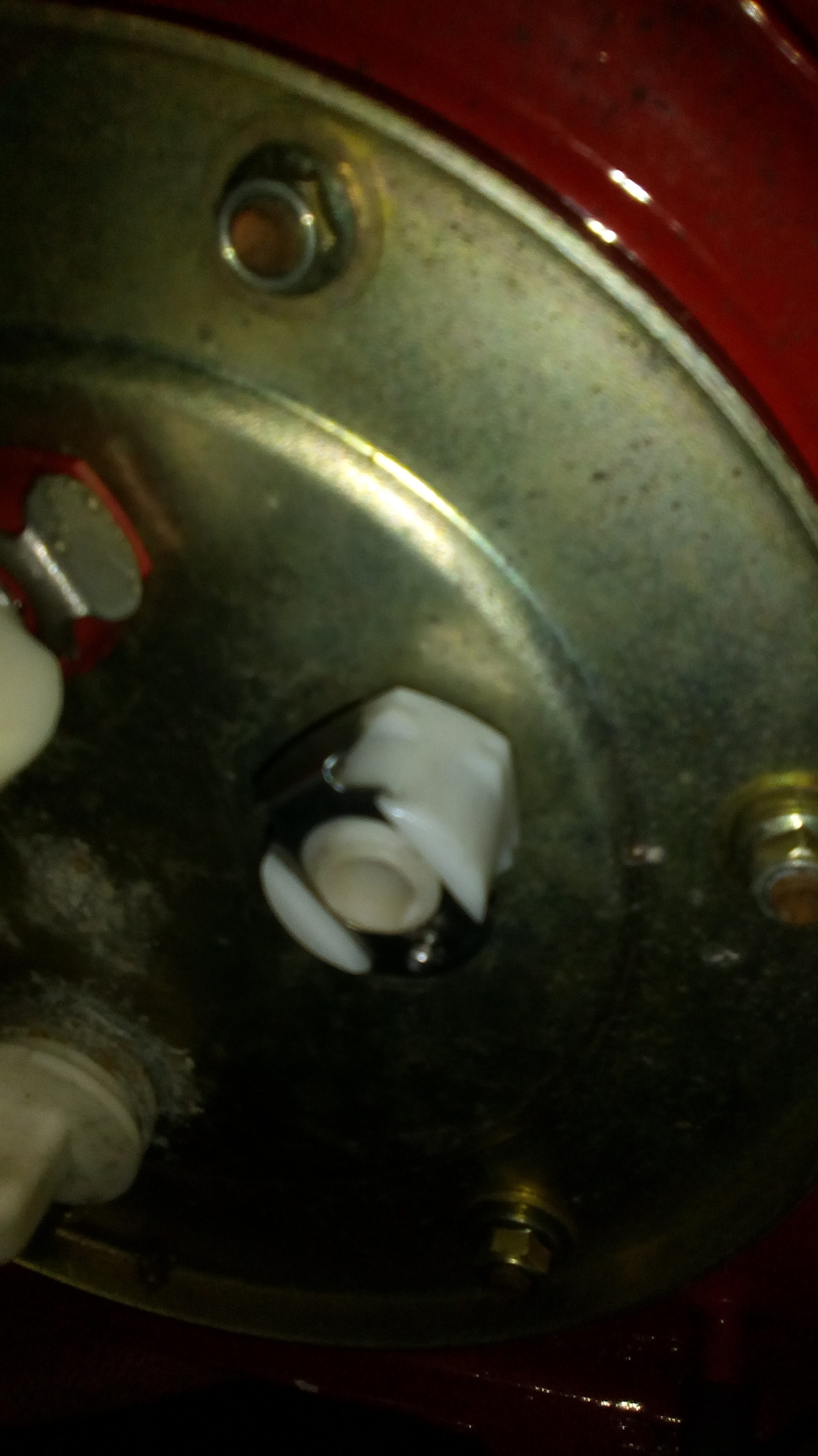

    Here is the offending little bugger that's doing my head in, as you can see the red one is fine but this one is just not clicking in, the metal piece slides to lock but it just refuses to go back in place

    Hi Alaln, I'm not 100% sure, but it looks to me like the connector is broken. This is very common and the replacement ones are metal as a result.

    The White connector looks broken, check the locking ring isn't stuck in the fitting in the tank
    The Big lad just beat me to that

    That looks broken to me, I think the white union on the pipe should have remained on the fuel pump assy

    We all think it's broken :weary_face:

    I thought it was as well, so where on line do I get another and what's it called, thanks

    Looks like it should unscrew? Looking at the micro, I stand to be corrected. Whatever happens you are going to need one. Once you have it, it will all become clear :confused:
