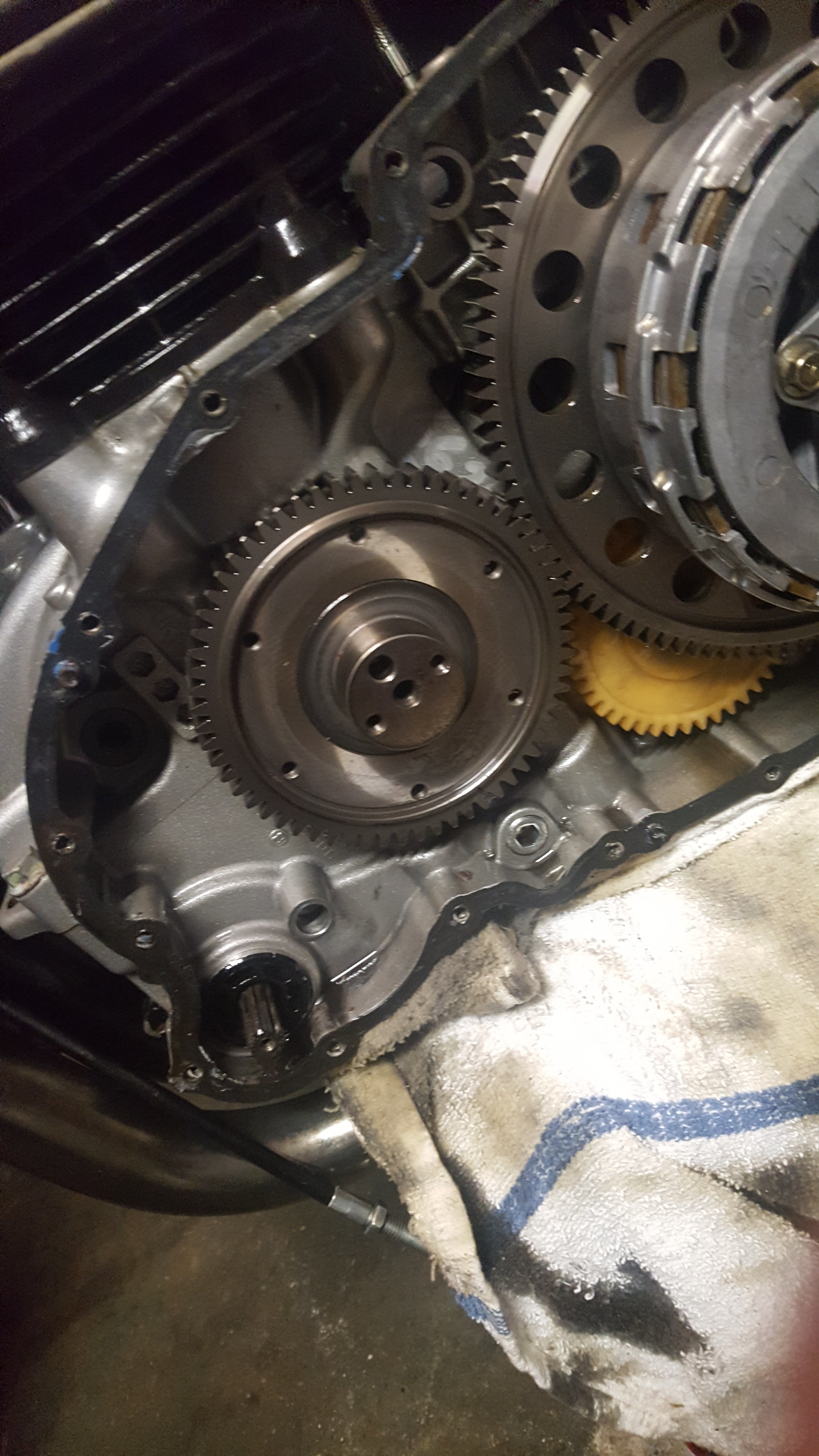

    Update: starter is on the bike and working perfect! New issue is that it spins freely and starter drive is not engaging.
    I removed and inspected the starter clutch and it works fine...
    Now I'm trying to figure out next steps!
    Cheers everyone!

    Check the inside of the primary casing, is there any obvious damage ? Sprag clutch Assembly is likely culprit ! It's a one way rotation bearing.

    Thanks. I did that. Everything is fine.

    Looks like the starter polarity was reversed! Apparently I made a mistake when assembling the starter motor.
    Took it apart and re assembled and now the motor engages with the starter! Problem solved!
    I had no idea that starter motor polarity can change !

    I put everything back together and now the starter is engaging fine.
    I'm waiting for the battery to charge and then I'll try to start the bike!

    yep any DC motor is polarity conscious.
    Its looking good now.
