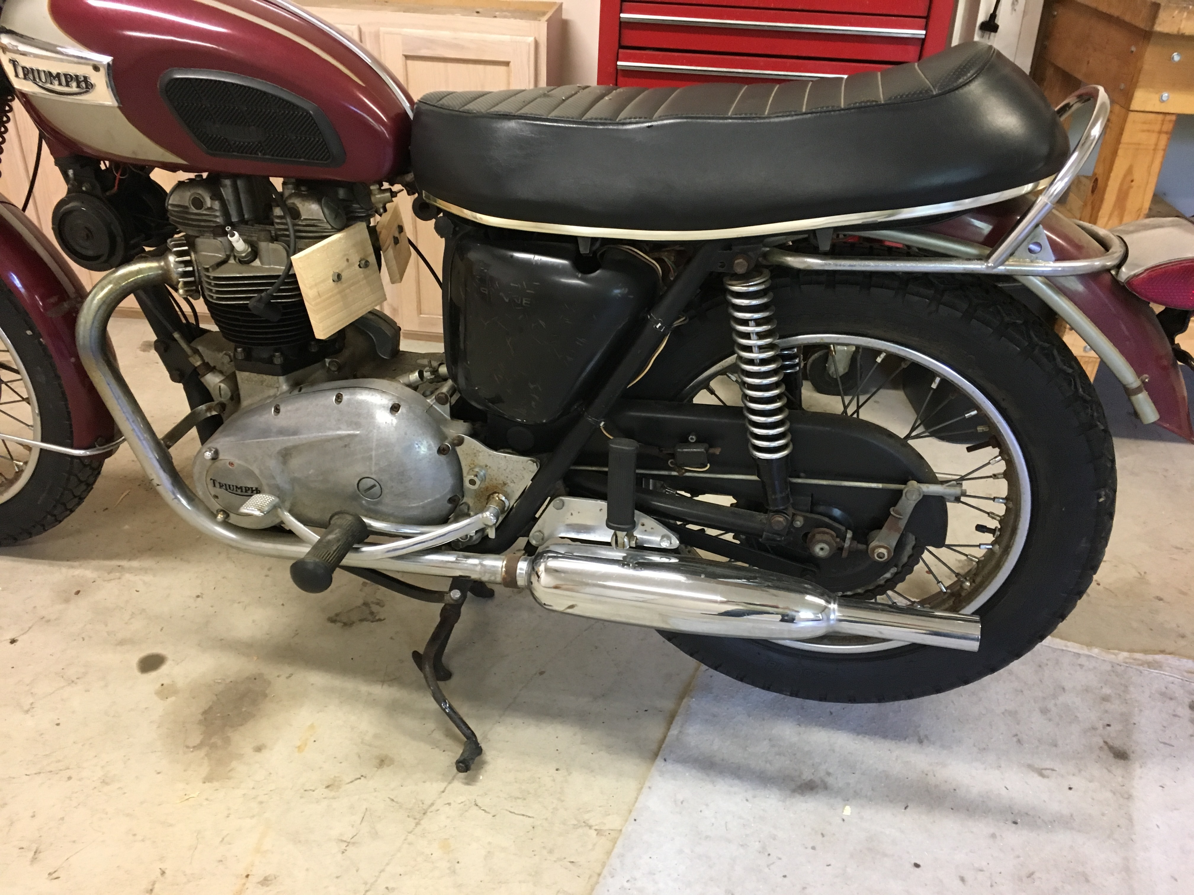

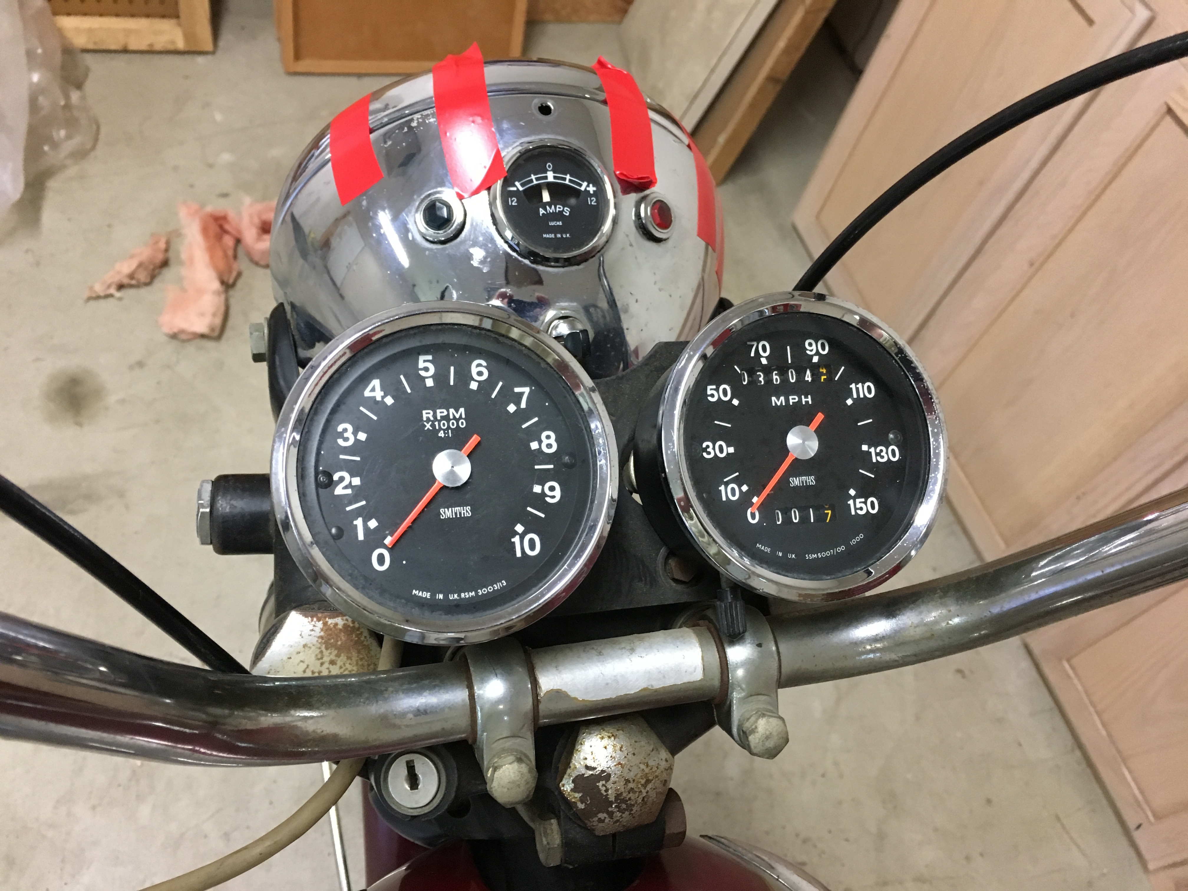

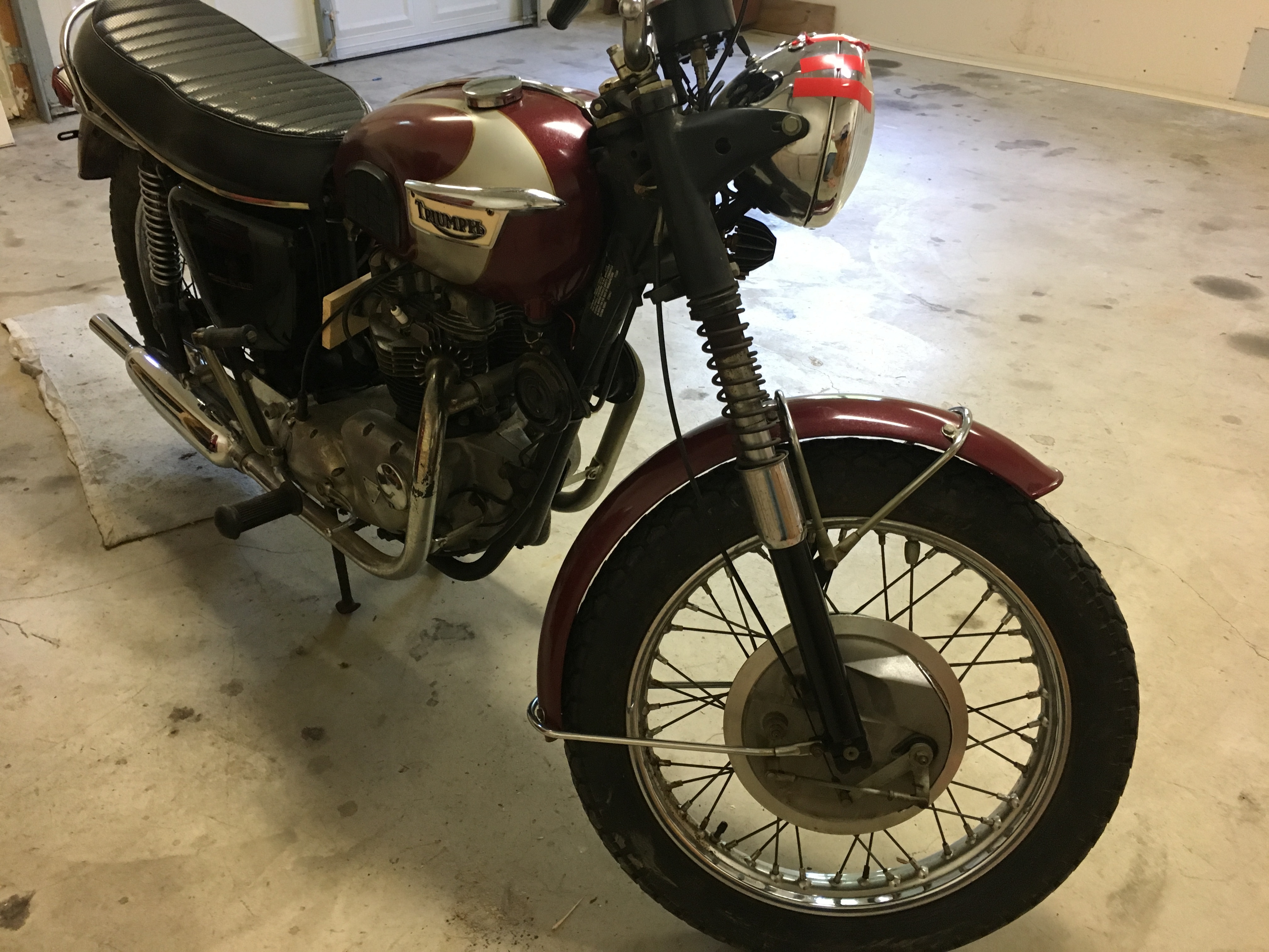

    I was able to look at the bike today and it does not have a hexagon down tube, it just "forks' out into two tubes that cradle the engine. Engine turns over and appears to have good compression, it moves thru all the gears and the brakes work. It was stored with fuel oil in the gas tank to prevent rust but has a little rust on the wheels. The numbers match but the frame number is on the right side and the engine number on the left side.......Carbs were removed (AMAL's) for a rebuild. 3600 miles on the odometer. It appears to be all original (just comparing to photos on line) except for the handle bar which is higher and narrower type ( the seller called it "hippie style). So.......where do I get an original or "original" style handle bar ? Can anyone suggest reputable suppliers for parts?
    BTW I purchased it.....

    seems you have a little gem there. The previous owner seems to have looked after it well. Bars you can get there as quick as here in blighty. Places like your motorcycle superstore and you have so many classic British dealers. Keep the wheel rims if they are original with the stamps on them as you won't find them again. Before you do anything flush out all the oils and refresh. Drop a half capful down each plug hole just to ease things out or plus gas. Getting quite exiting now and want to watch the rebirth. If you feel like the challenge put it on the rebuilds section and let us follow you on your quest. You are now entering into the world of rebuilds and restorations. You will love or hate it. But it's rewarding. Let us all know because you will experience all moods with your machine. Hair pulling when it won't behave painful face grin when it talks to you but its worth every bit of pain. And in the end you can stand back and say I did this and its mine. Remember we are all behind you here and no question is silly or not worth asking.

    Thank you Joe, hope you're right . I was able to spend a few minutes in the garage and noticed that both wheels and tires are Dunlops. Wheels have a little rust and the tires are dry rotted but hold air ! As far as moods I'm familiar with the all "swings" (in quick and intense intervals) and the Prince of Darkeness attacks : I own an OTS E-Type and have gone thru all of those hi and lows that , at times, being in the house with both daughters and wife felt relaxing in comparison......
    Interesting find : original tool kit and pouch (I believe) .
    1st up/3 down ?
    More to come.
