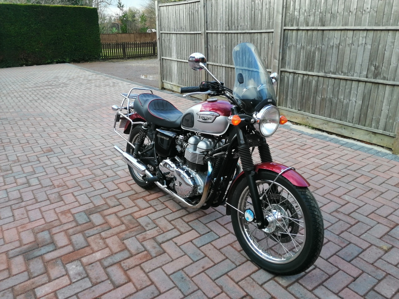

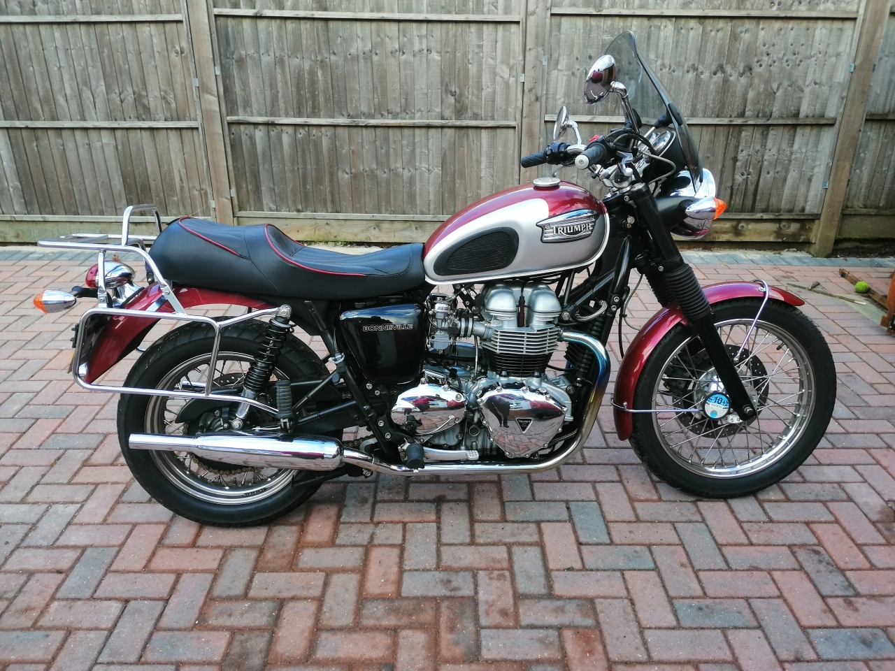

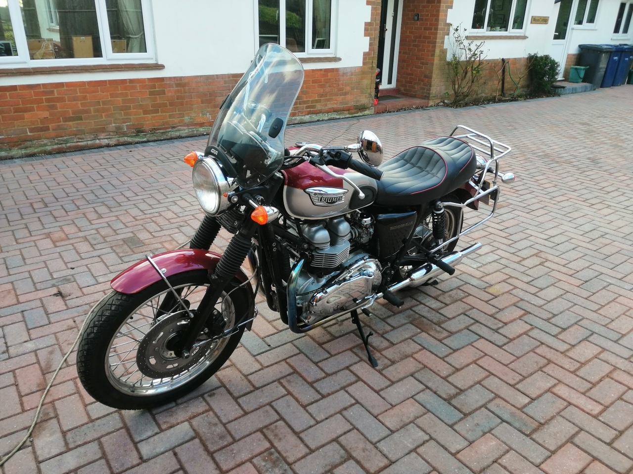

    Hi All
    Thanks for your interest in my Bonnie. I've attached some pics for those who'd like to see it.
    Just tried to start the Bonnie in the cold and it just won't catch. It started ok yesterday. I'm at my wits end. Has anyone tried the TTP Firestarter Igniter that seems to be advertised with great reviews?
