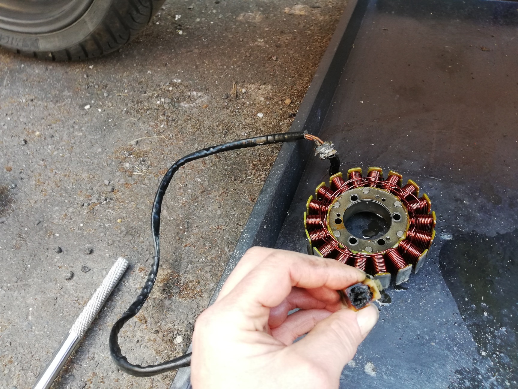

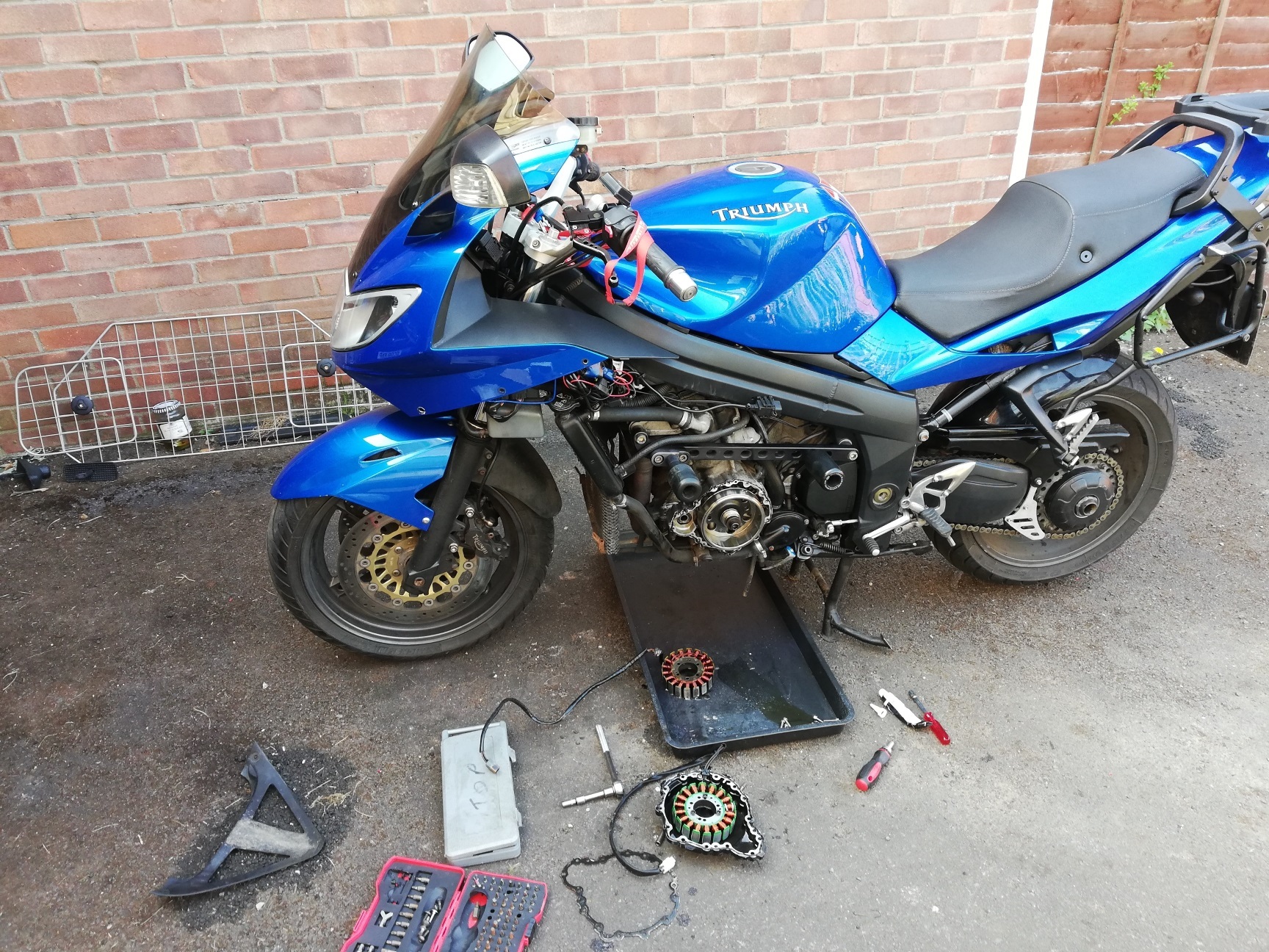

Latest update, So the Sprint has been a pain, the Regulator/rectifier fried as evidenced by hot right leg and smoke from behind the fairing. I investigated and the wiring from the stator was fused and the wiring back into the loom bike side of the regulator was stiff, cracked and corroded. I therefore replaced the stator, regulator/rectifier with a moffset (ok cheapo chinese off ebay). Everything working but stator to rectifier connection block super hot. I then took it out and hard wired it. I relocated the regulator to the front by the radiator. I also set up a bigger wire pig tail from the main loom direct to the battery positive and negative. End result charging at idle shows 12.8 volts, 3000 revs 13.2 volts, rode it for approximately 15 miles which was enough to drain the battery so the bike wouldnt start again without external charging. So pleading to the gods of the internet, ideas please.... mine are at replacing the brand new regulator/rectifier
Well fitted another Mosfet regulator, bought from Sprint Manufacturing. The wiring back to the bike from this one bypasses the oem loom. It also comes with a replacement stator plug which is much heavier duty. Seems to have done the trick, battery showing 13.6v at idle and 14.4v at 3k revs. This is definitely a case of the old adage being true, "buy cheap, buy twice". So with a photos from the other week when i started and one from today with the newest regulator.

So after an interlude. The bike hasnt been on the road much. Had another stator failure! Luckily the new mosfet regulator survived. So fitted the new stator when it arrived. Then the starter motor went, I ordered one from ebay that was new from Italy. When it came, eventually, it was the wrong one. Sent it back then had a month long battle to get a refund. In the meantime ordered a second hand one. When that came also bought some upgraded heavy duty wires for the starting / earth circuit. Been riding it for the last 2 weeks almost daily but just couldn't get comfortable with the handling. Turn in seemed slow and the whole bike just felt vague in corners. I obviously don't expect turn in like the street triple but i most certainly didn't like the running wide feeling in most corners . Checking out the suspension, rear preload and rebound was set up harder than if there was rider, passenger and full luggage and front preload was set less than for a lone rider. All set back to oem single rider sttings. Yesterday i then checked the tyre pressures, front 32psi, rear 33 psi. Set to standard 36f 42r. I also put on some 28mm bar risers as i was getting quite a bit of wrist discomfort. I took it out for 60 mile ride, the bike was transformed. For the first time i felt comfortable and had actual fun on my favourite B road loop! I was really glad as the thoughts have been building that ive bought a lemon and i will never like this anyway. I have been harbouring thoughts of getting rid of the damn thing. Got up early this morning to put the pannier racks back on that i had taken off. During this i also put on some LED indicators with integrated brake lights (it also has DRL but i didn't wire those in as i wanted the brakes to stand out). I also put some LED bulbs in the front together with a flasher relay to sort out the flash rate. Job done pleased at the result. Look at the back tyre, there is a bloody nail embedded in it! You couldn't make it up. Anyway booked in for a replacement Michelin Tuesday morning, if the front wasn't so new i would have ordered one of those too and switched to Bridgestones as I much prefer them.
