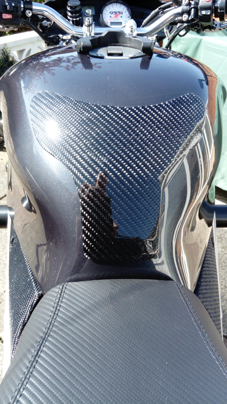

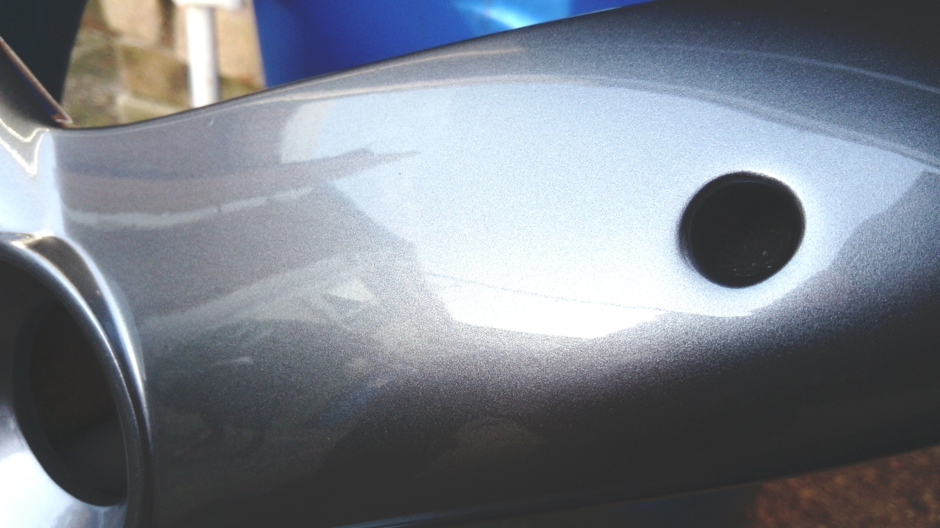

    Decided to treat my Speed Triple to some new paint. Never sprayed before but figured for the price of materials and a few guns I get to learn a new skill and maybe save on getting someone else doing it. Went for a metallic black over the standard solid black and a gunmetal for the wheels. Still got the frame to do to match the wheels but the majority has been done. Also didn't want to use decals so cut some stencils on my plotter and used these to stencil the logo's on. Couldn't find a OEM carbon tank protector to protect the new paint so took a mould of the tank before prepping and made my own. DSC_0523.JPG DSC_0524.JPG DSC_0575.JPG DSC_0577.JPG DSC_0591.JPG DSC_0594.JPG DSC_0602.JPG DSC_0603.JPG DSC_0604.JPG DSC_0608.JPG

    Yes mate, first go. I had spent most of winter looking at info and learning the technical details of it all. This obviously doesn't make me a pro but it certainly helped when choosing products and doing a good job on the prep and colour compounding. Got to wait a few weeks before I can put some polish on it but got a decent finish with the compound.

  11. Wow, that's really impressive. What gun and paint did you use? Presumably the new-ish water based paints make doing this at home much safer than previous 2-pack? Anyway, well done, really nice job - bike looks really nice.
  12. Shamus13
    Shamus13 Well-Known Member
    Apr 18, 2016
    145
    East Riding of Yorkshire, UK
    Thanks. I stuck with solvent based paints. I used a 2k black high build primer and once this was flatted down used a Valspar basecoat which is a high metallic black with some pearl in it too. I then used a Kapci 6030 2k clear as it is a good quality clear which can be air dried. I have some LVLP full size guns but found my mini HVLP (more midi sized) guns easier to use especially on the wheels as they are lighter and can get around the small panels better. For bike stuff I'll definitely stick with my mini's.
