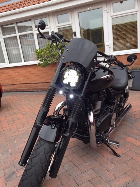

    Got the MOT done today and it passed with a whole LED light unit fitted, took the old one along for the ride just in case:).
    I have a wisamic 5-3\4.5 5.75 inch led off Amazon at around £45, been fitted for 18 months and going strong, just in case anyone is interested.

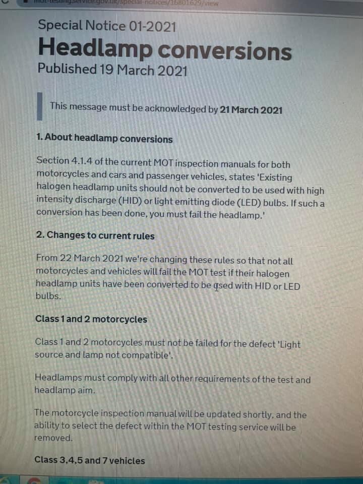

  17. Fourbears
    Fourbears Noble Member
    Dec 8, 2017
    512
    Norfolk
  18. Alan Gilbert
    Alan Gilbert Senior Member
    Nov 22, 2018
    304
    Yes - I came across this earlier today on the Tiger Facebook Group. Fantastic news for the original Tiger 1950 owners as the early projectors were worse than useless and I’ve been running an “illegal” HID but no more !!!

  20. Triumphal385
    Triumphal385 Active Member
    Mar 23, 2020
    134
    South East
    There is another thread, on LED headlamps, where I posted an update, recently.
    The below, is content in the outcomemI received from DVSA, after multiple efforts to get them to acknowledge fact and truth.
    "Firstly, I am sorry you were given incorrect information in the reply you received from Andrew. The Department for Transport provided guidance on the issue of LED headlamp bulbs in halogen headlamps, we were unaware this information only applied to cars and the information we received was not specific about either cars or motorcycles.
    Therefore, an LED conversion can be legally made to a motorcycle. I would like to thank you for bringing this matter to our attention and I am sorry for any inconvenience this has caused.
    We are in the process of amending the MOT Manual and getting the information out to testers."
    They have made good on this assurance, improving road safety and complying with law and the will of Parliament. Credit, where credit is due.
    Honour, is not readily welcome in the Civil Service. It takes great courage on the part of the individual, who will find themselves alone and abandoned, punished for honesty and integrity.
