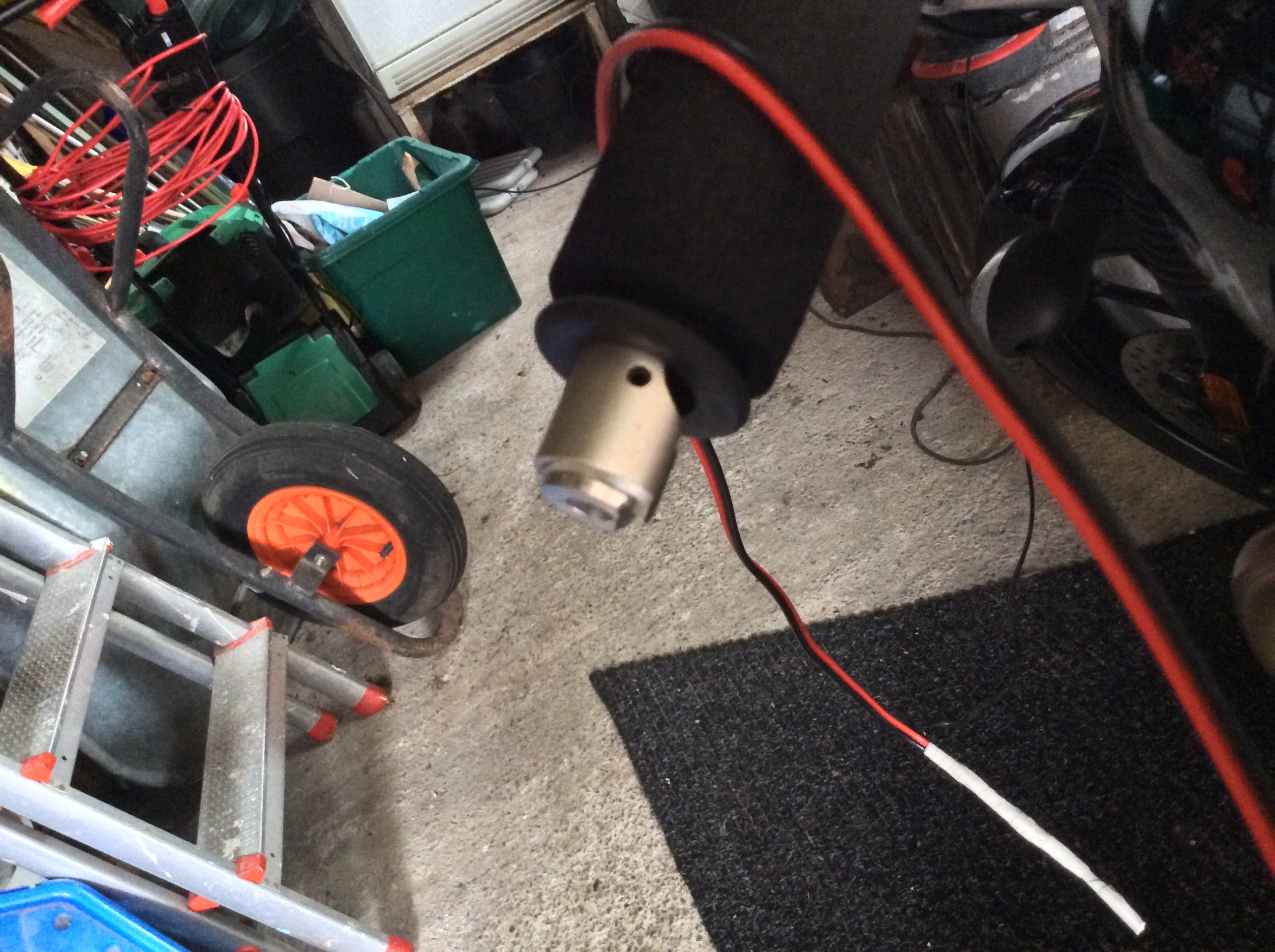

    As you can probably see in the pictures, the bar end fittings don’t ‘Fit’ properly.
    I could try getting some Scrambler bar ends, or, as these new bars are longer than the originals I might just shorten them.
    Regards,Ken.

    Looks good mate. Another black steed. Will give the inmates something to ogle tonight. Yes the bar ends are standing out a bit. But you can get ones are just like a cap to go there. Also ar you sure you fitted the ends right by tapping them home with a rubber mallet before tightening up.

    Looks like they’re in there as far as.Cheers,Ken.

    The handlebar end has an insert fitted (Held in by a spring pin/roll pin, I think) which is threaded to suit the screw holding the end cap on. Will do some googling before altering anything, perhaps get Scrambler end pieces
    would be best.

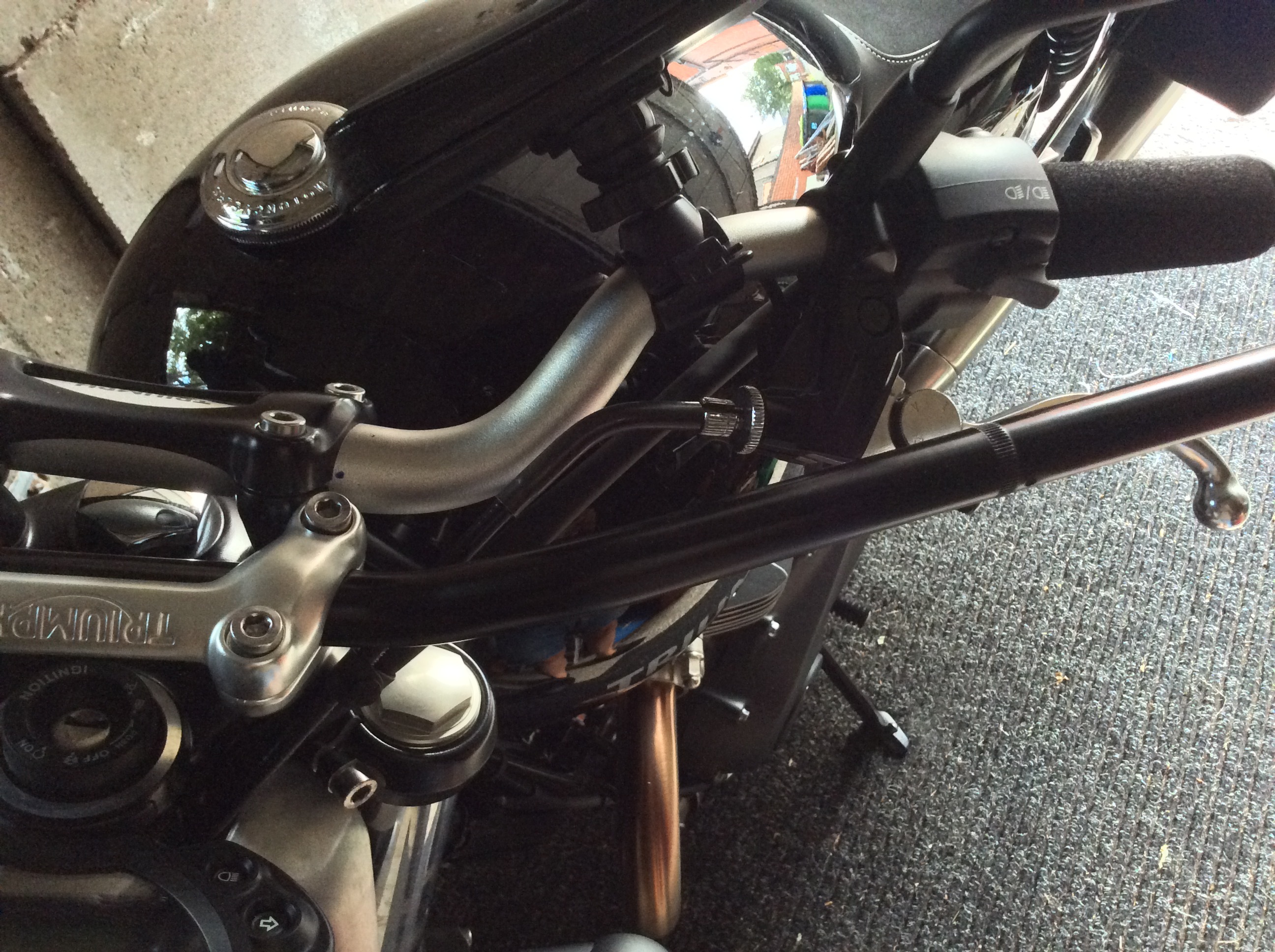

    It’s a bit hard to measure the difference between the bars now they’re fitted, but, I agree with others that have had the same done, yes there is more ‘Pull back’ as standard (and it can be increased a little more by pulling the bars towards you more) and the bars give a more upright riding position.
    Will add picture showing different shape of bars.

    I’m wondering now if the Scrambler has a longer throttle tube that would come nearer the bar end.
    The fitting for the end cap is just the same in both pairs of handlebars with nothing to actually push inside.just the small screw to keep the end in place.

    Not sure about the Bonnie,but on my bike the risers and clamps needed changing as scrambler bars larger dia. than Street Twin ones.
    Throttle (Mine fly by wire) and electrics unchanged.
    Someone (USA I think) had to remove the swing arm to change the brake line...others have said, leave the swing arm in place and just reroute the brake line down the opposite side of the frame.
    The brake line has some rigid parts in it that can easily be damaged( kinked) when trying the reroute method.
    I think these complications fitting the brake line only apply to NONE ABS bikes.
    On ABS ones the brake line goes to the ABS thingy which I believe is under the seat, much simpler. Mine is ABS.

    Triumph use three different handlebar diameters on the "classics".
    e.g.
    Street Twin - 7/8 inches (c. 22mm)
    Street Scrambler - tapered or fat bars that are 1 1/8 inches (c. 28.6mm) in the centre, and 7/8 inches at the ends
    Bonneville - 1 inch (25.4 mm)
    Street Twin and Street Scrambler handlebar mounts/clamps are interchangeable (I've bought some used ST clamps in case I want to change the 'bars on my SS... there's much more choice in 7/8 diameter handlebars).
    I understand that there's a problem if you need a different brake hose, because the master cylinder is connected to the ABS unit via a flexible hose that is swaged on to a rigid pipe. Pity they didn't use a junction block at the front of the bike - something to look at when it's out of warranty, perhaps. :)
