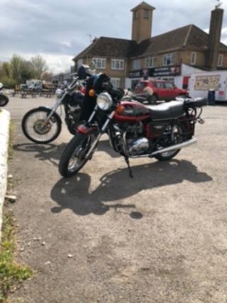

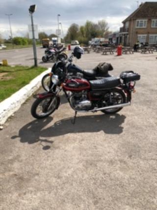

  5. joe mc donald
    14,892
    Pat W
    Taken and cleaned. Just really snapped a couple of pics as you know here in the asylum. No picture it didn't happen. Will try harder next time.
