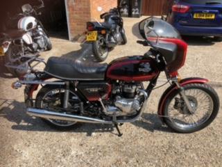

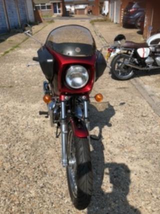

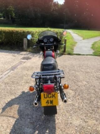

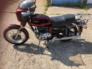

    Here is my bike people. Cleaned up a bit and running sweet. Still have to do the boxes as they have lost the clear coat on the black half will post those later. Going tomorrow thumbnail (14).jpg thumbnail (13).jpg thumbnail (12).jpg thumbnail (11).jpg to pick up some leaded petrol and perhaps Tuesday i may get a spin on it.

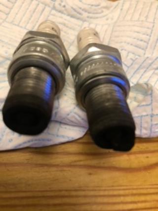

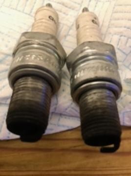

    Well update on my newly acquired Bonnie. It started to run really bad a couple of months ago. Then burning the plugs black. I tried everything you could do to the carbs and still the same. So in frustration i sent it to Meriden Motorcycles. They tried and together we decided to change the electrics with a new ignition system. As i would not listen to Jon the chap working on the bike who said there was something wrong with the carbs that he had cleaned and set up. So he fitted new carbs. Got the bike back running sweet as you would like. Took it to the H Café today and low and behold it started playing up again. Just got home and find it has gone back to misbehaving. At a loss here and wish I'd never seen the thing.

    Hard to tell but could be valves, air /fuel mixture assuming it's not running extremely rich as you've sorted the carbs? Hard to tell whether it's wet or dry soot from the photos, if it's worse one side of plugs than the other it's probably valves.

    Yes did talk to Meriden. But the bike was sweet as when i got it home and decided to remove the fairing and replace the headlamp and lighting switch. Cleaned all the connectors and replaced a couple. Found that the lighting switch i bought was faulty so put the old one back on and once again sweet as. Also had to check the ignition switch as some connectors were loose. So pray its good again. Also found that the bike is running N3'S but is recommended to run N5's. Does that matter anyone. Thanks for all the help. I just want it to be good for about another year or so then i want to find someone to do a complete restoration for me. So here's hoping.

    Champion N3 for points and Champion N5 (hotter) for electronic ignition. Although I use N5 in them all. I think the C (N3C N5C) is for copper cores, just a later spec I think.

    Hi Joe, I had the same issue on a Bonneville some years back, I tried a lot of things, carbs, ignition etc, I then fitted NGK plugs and low and behold it never faulted afterwards

    You say you found wiring joints a bit iffy , poorly contacting joints/connections can cause voltage drops ! If the Voltage and Current is out by enough , it will cause poor spark plug burning , as the coil's won't give a big bright spark.. in electronic ignitions it may cause delayed as well as poor spark ...
    Both of which are caused for poor burn and hence poorer performance , and sooty plugs ... Good cheap test charge battery right up , clean new plugs , run bike or ride it for 5-10 minutes , no lights or other electrical items On. Turn off , let it cool , pull plugs ! If they are 'clean' voltage is a contender !!

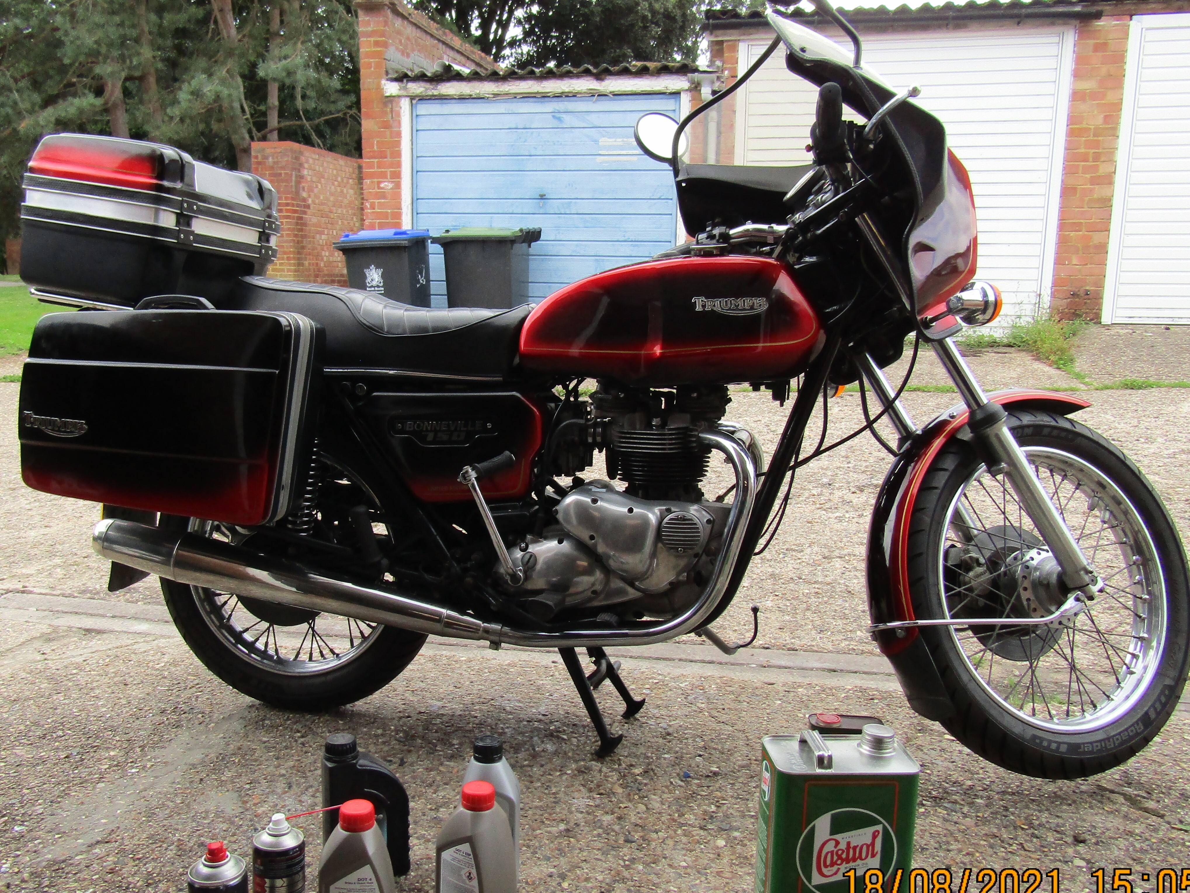

    Yes boxes and fairing now wrapped up and packed away in the garage. IMG_1293 (2).JPG
